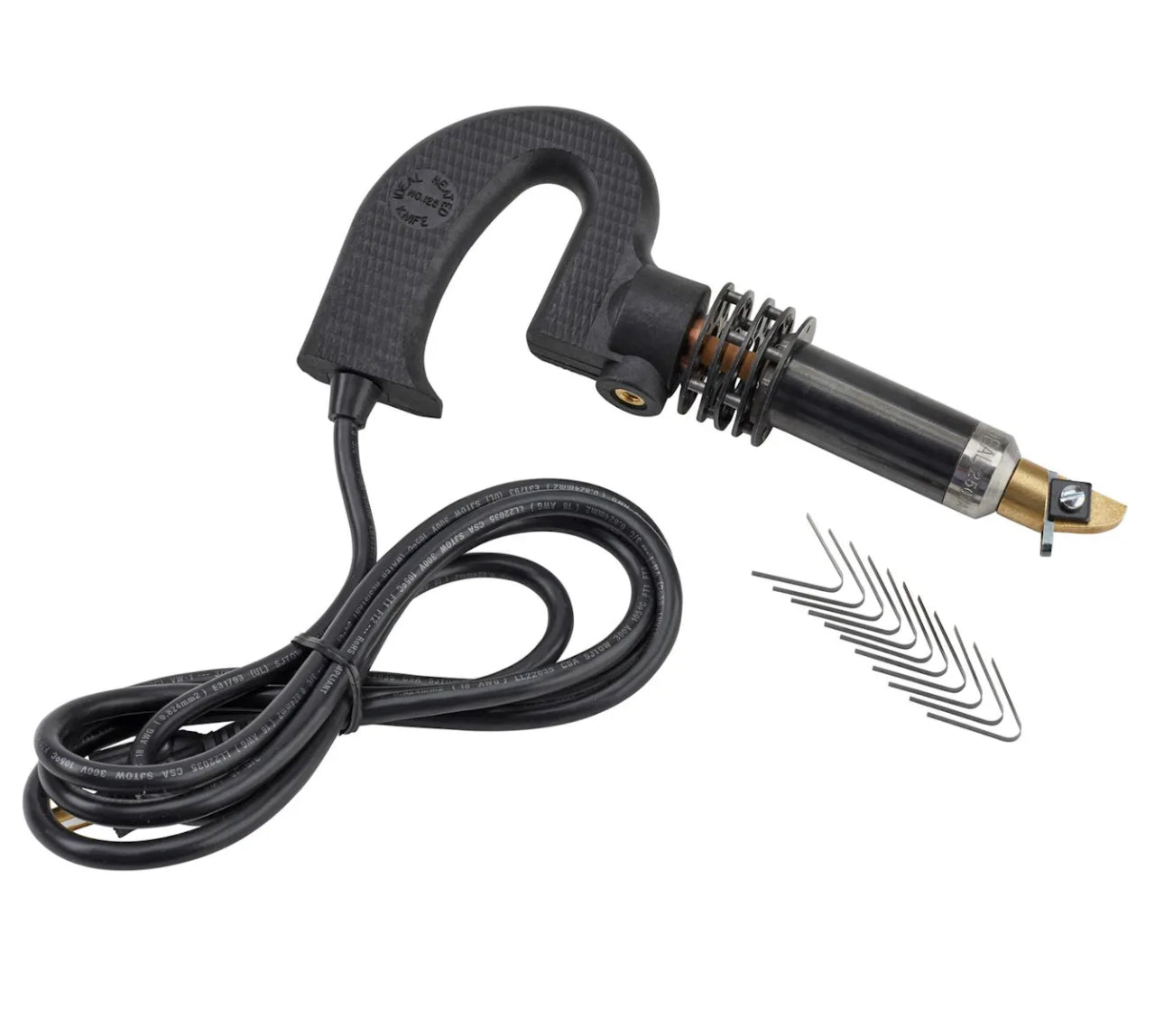

What is everyone using to put sipes into their R4 tires? Do you need heat in the tip to burn the rubber?
Part 2: How big of grooves are recommended? How deep? U shaped or V shaped?

@dnw64 may loan you his if you ask nice !👍
But, yes, you need heat to make it work, besides a sharp blade ...

Yes, heat is used... better to do it in the summer when tires are warm!!! I used #4 which I think are 1/4" wide and deep...
Link below is what I bought, I just redid mine not so long ago.
Boy has the prices gone up, this is NOT where I bought mine but it's the closest thing I could find. (this is just what mine looks like):

I used an Ideal Tire Groover with the #4 blade. It cuts a "U" shaped groove, and the depth is adjustable.
/ Siping / Regrooving Tool #6
I have the same groover. The trick is to allow it to fully heat up, usually about 15 minutes with the tip pointing up.
Also, a forced air heater to preheat the tire helps a ton.
I did #4 on the rear tires and #3 on the fronts
