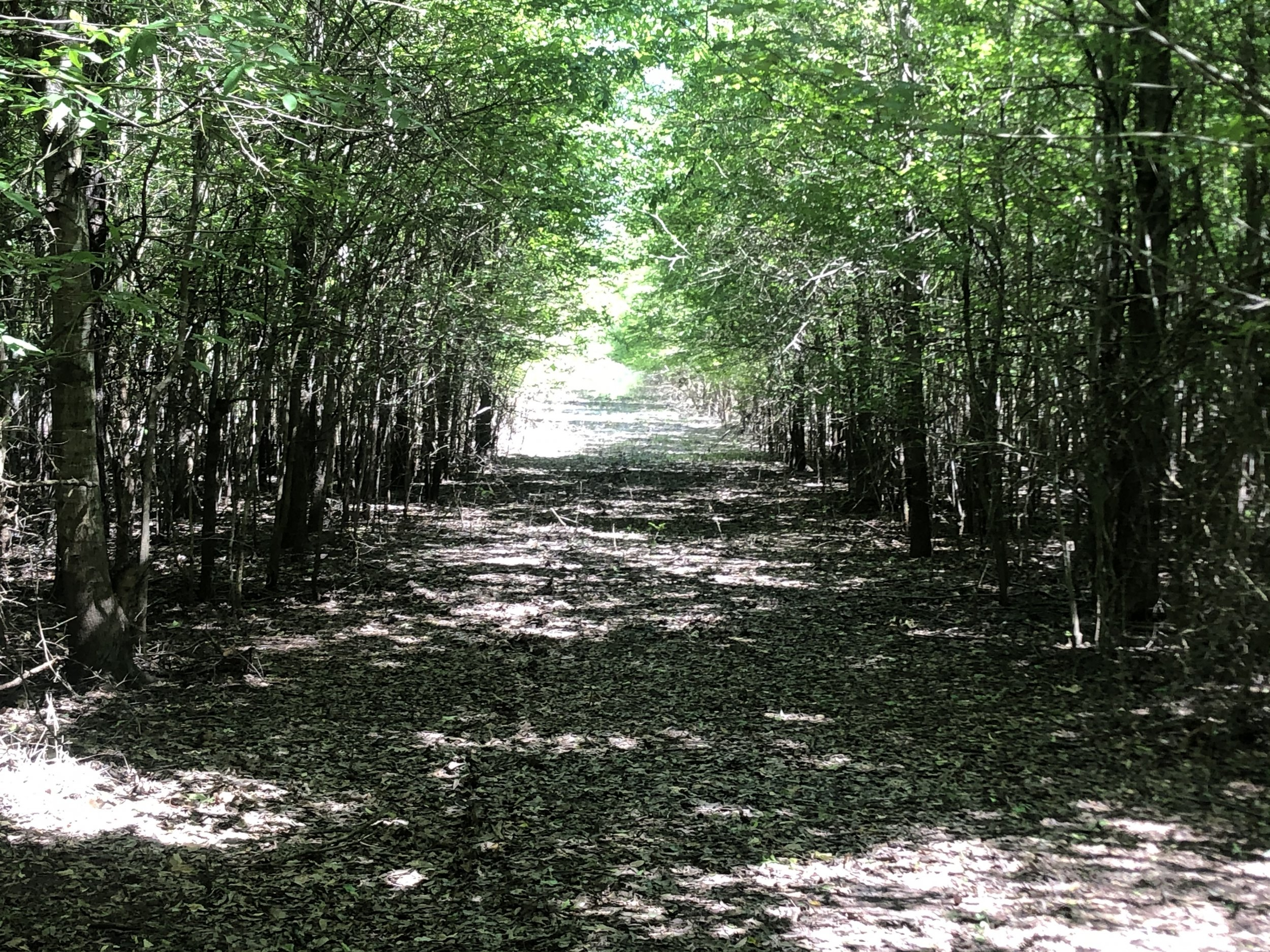

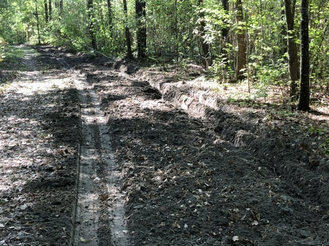

Here’s an example of one of my “roads”. Many would consider it a shooting lane through the trees. But most of these lanes are used to access other parts of the farm and get a good bit of traffic. The part in this pic is in good shape but other parts stay wet and rutted. We built up and graveled our main access road but that’s not feasible on 7-8 miles of trails. I’m trying to solve/improve this issue with a few passes of a disk or something similar so that they can be passable again and make future yearly maintenance quicker and easier. A disk that would give them a slight crown to help shed water would be the ideal implement.
Even if you aren’t going to gravel the road, a grader can cut ditches and shape/crown the road so it drains. Then maintenance with a tractor and rear blade is easy.

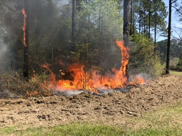

The state forestry service re-cut some of my firebreaks yesterday with a small dozer pulling a HEAVY harrow. Now for me to go bouncing back over them to smooth out.

For me, if I don’t make them wide I’d be trimming or pushing back brush Every year instead of 5-6 years. Privet & vines grow quick. Frequent burning helps a lot too.

Those pics looks great, not too different from my roads. Just add more water/mud. Burning isn't an option since this is flood ground and in conservation easement. Some of these roads we had widened a few years ago to about 30' but others are very small 12-14' wide. We bought a LaneShark about 4-5 years ago and that has been a real difference maker for keeping these roads from closing in on us. Now I just have to fix the ruts somehow
