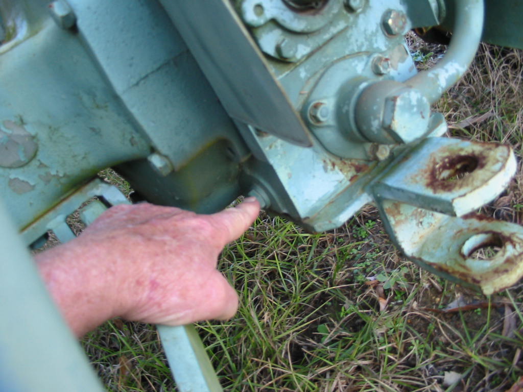

This picture shows where the drain plug is for the YM2200 transmission (my finger) it also shows where the hydraulic screen is for the YM2200 without seperate hydraulic tank ( behind the hydraulic line)

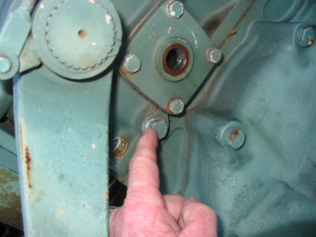

This picture show where the drain plug is for the seperate hydraulic tank ( my finger) it also shows where the hydraulic screen is ( square plate with 4 bolts) I have imported 25-30 YM2200's and have never seen 80/90 in any of them or any other Yanmar tractor.

Artist , No, do not pull the trans. plate,You won't get much oil out there.The trans./rear end drain plug is on the lower left side of the rear end housing.The drain plug for your hyd. system is on the top right side of the rear end housing,not the reservoir,it drains out of the the rear end housing.I know this sounds silly,but that's the way it works,the hyd. filter is inside the hyd. reservoir,at the large line.Can't remember,but less than 2 gals. for the hyd. system.By the way,the hyd. reservoir is also the top cover for the trans./rearend. Jim
/ Simplified fluid question. #14
Danny,The pictures you posted are not like my ym2200.In previous dealings with you,you stated that the 2200 had two hyd. systems,and you showed pictures of both that you koow of,is there a third pig in the pen? Both of my hyd. lines go straight into the res.and all of my controll linkage go there too, so I assume that this unit is a reservoir and control combined.Though the hyd. mount on top of the trans. they do not share the same oil.Can you shed any light? Jim
