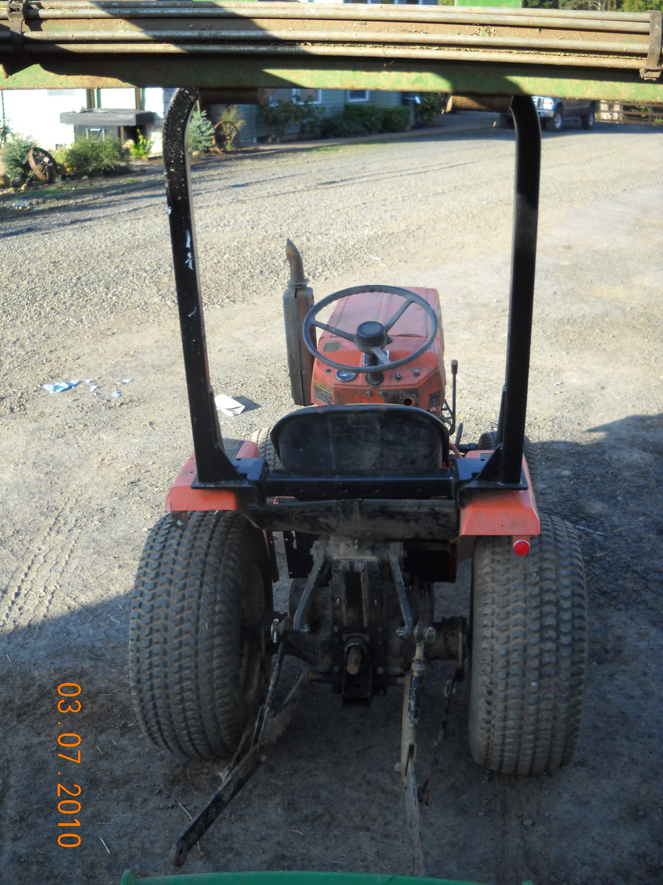

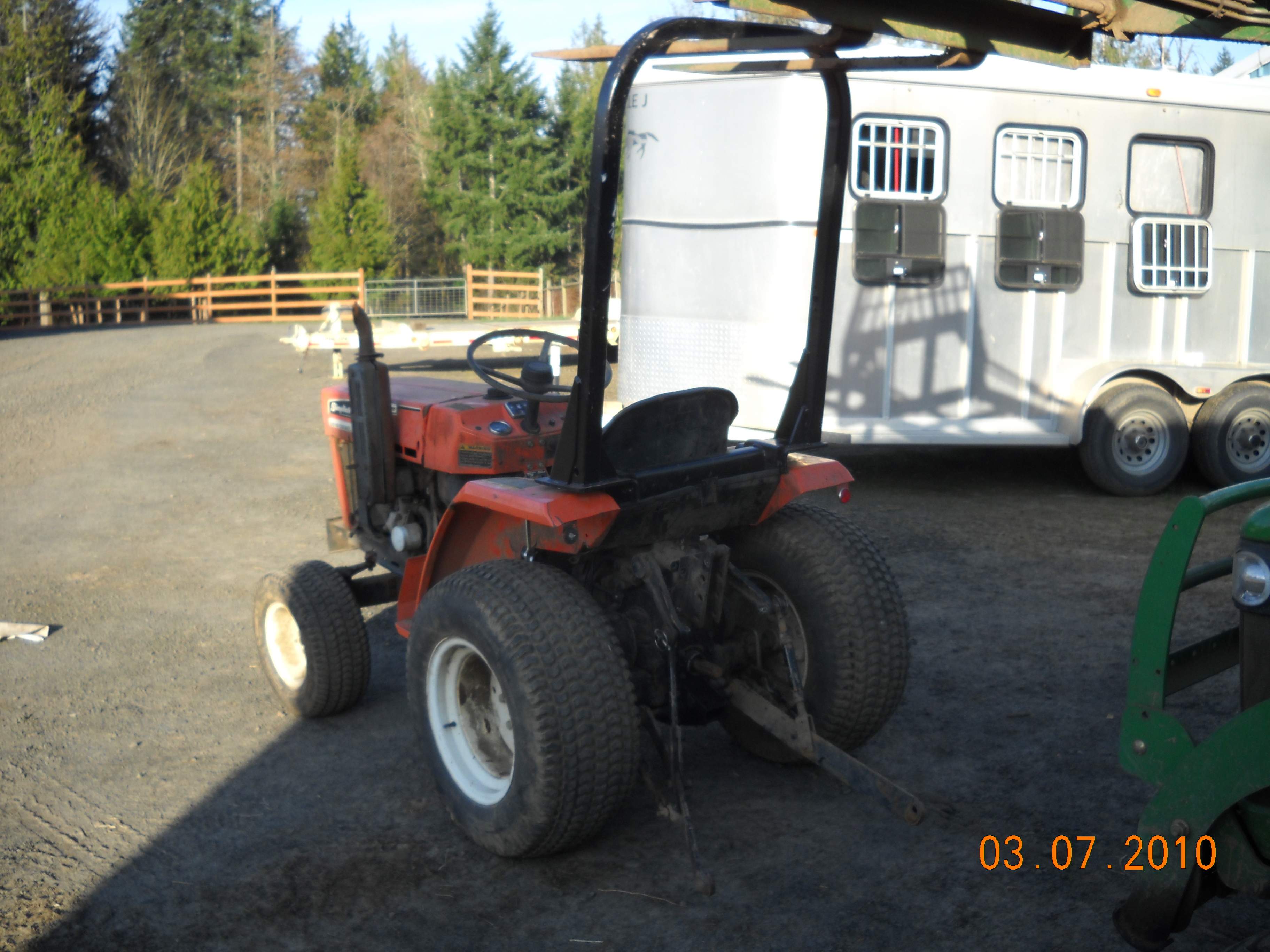

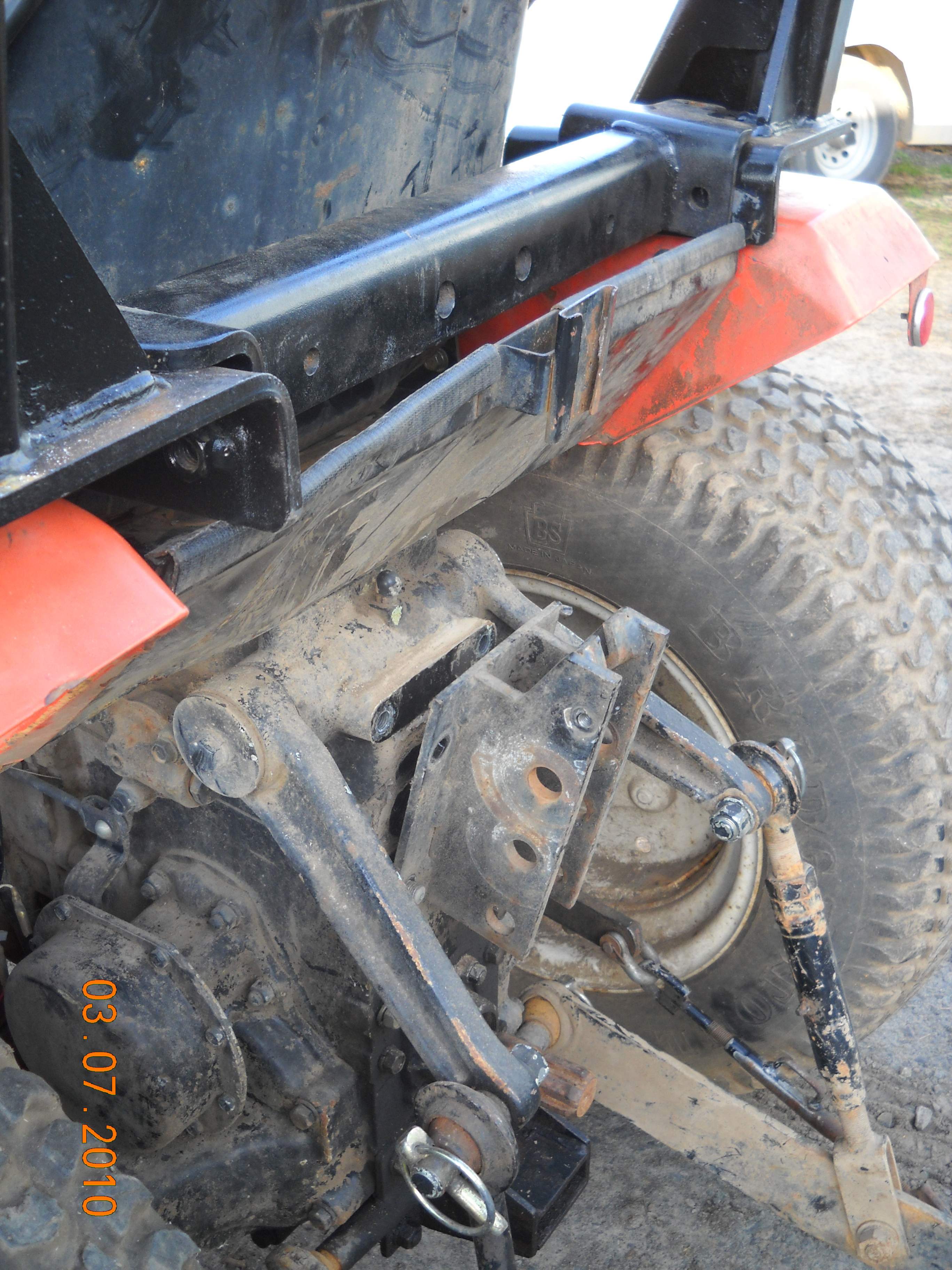

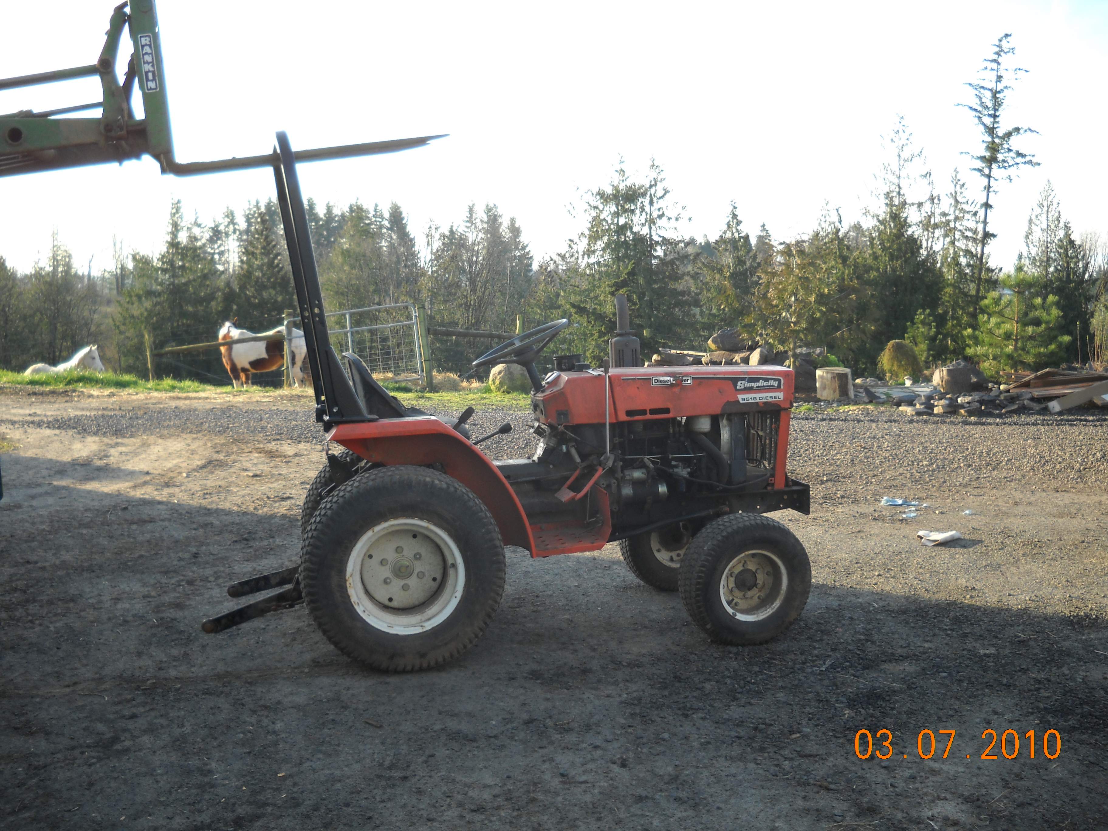

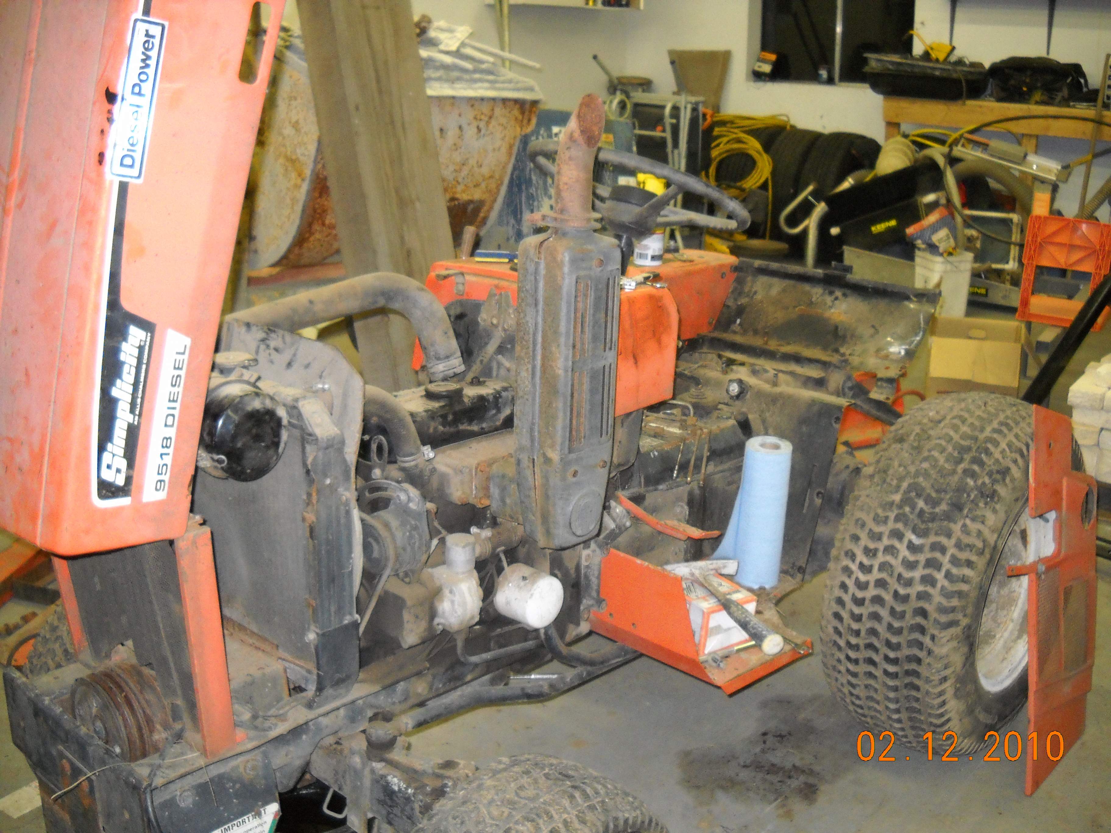

Well, I recently brought my Simplicity to my grandpa's so i could get it running. I will be ordering the used pump soon. Today We decided to lower the ROPS down to the Fender so they wouldn't wobble so much and make them a bit stronger. First, We cut the mounting bars down 3 inches (so the bottom of ROPS sit on the fender) and rebolted it on. Then drilled some holes so I could bolt the fenders to the bottom of the ROPS but it wasnt an easy task. We had to use clampt to pull the fenders in a little and bolt them down. In the end, the ROPS are VERY sturdy and do not move at all. :thumbsup: This was not the only thing we did though, we also mounted my new seat. Made 2 brackets and the seat is now mounted to the tractor. :thumbsup:

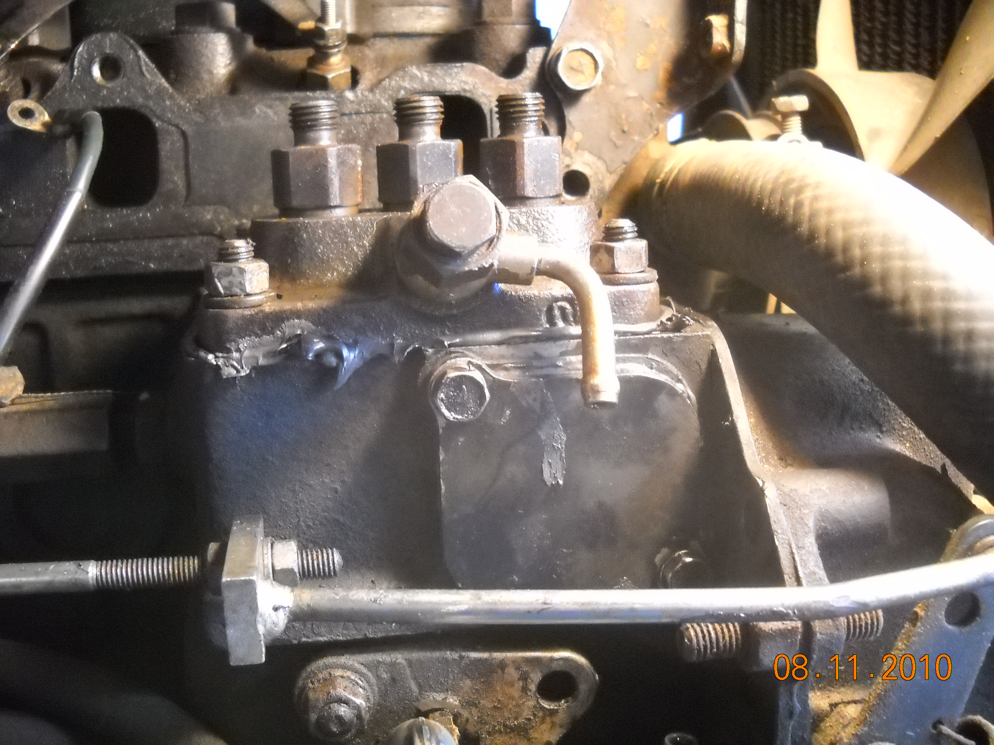

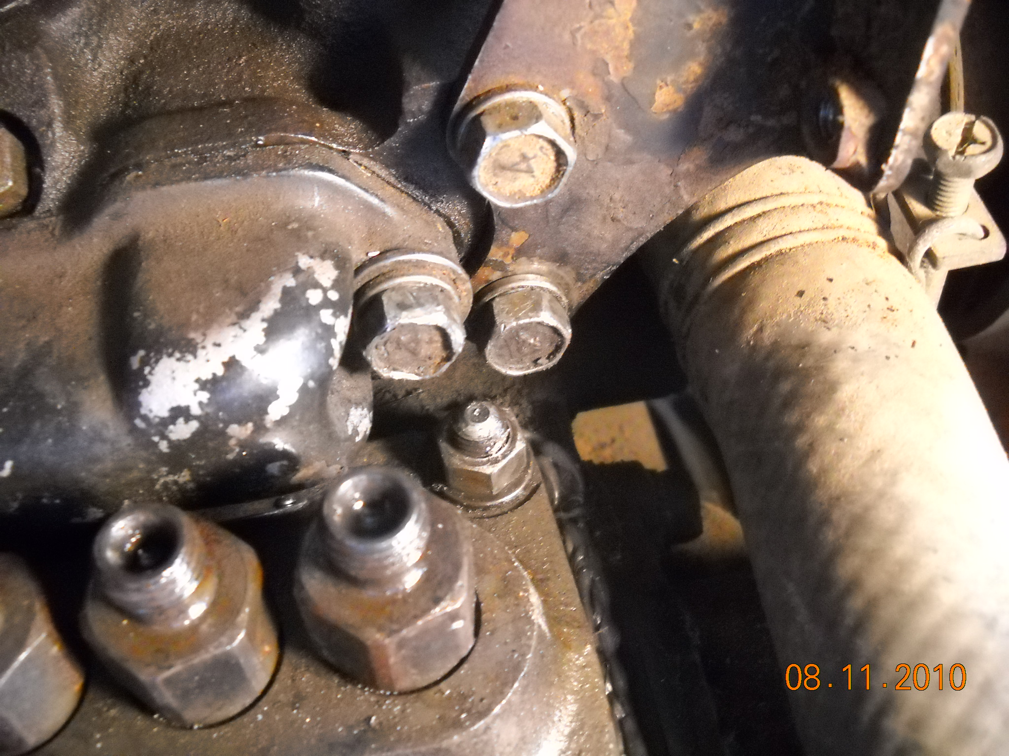

well, I just applied the silicone gasket maker to the mounting hole for the fuel injector pump. This should help with the air leak that i was having yesterday. I only tightend the bolts finger tight (to allow the silicone to set for an hour before tightening all the way). I hooked the kill switch back up and put some silicone gasket on the side access panel for a better seal even though it wasnt originally leaking.

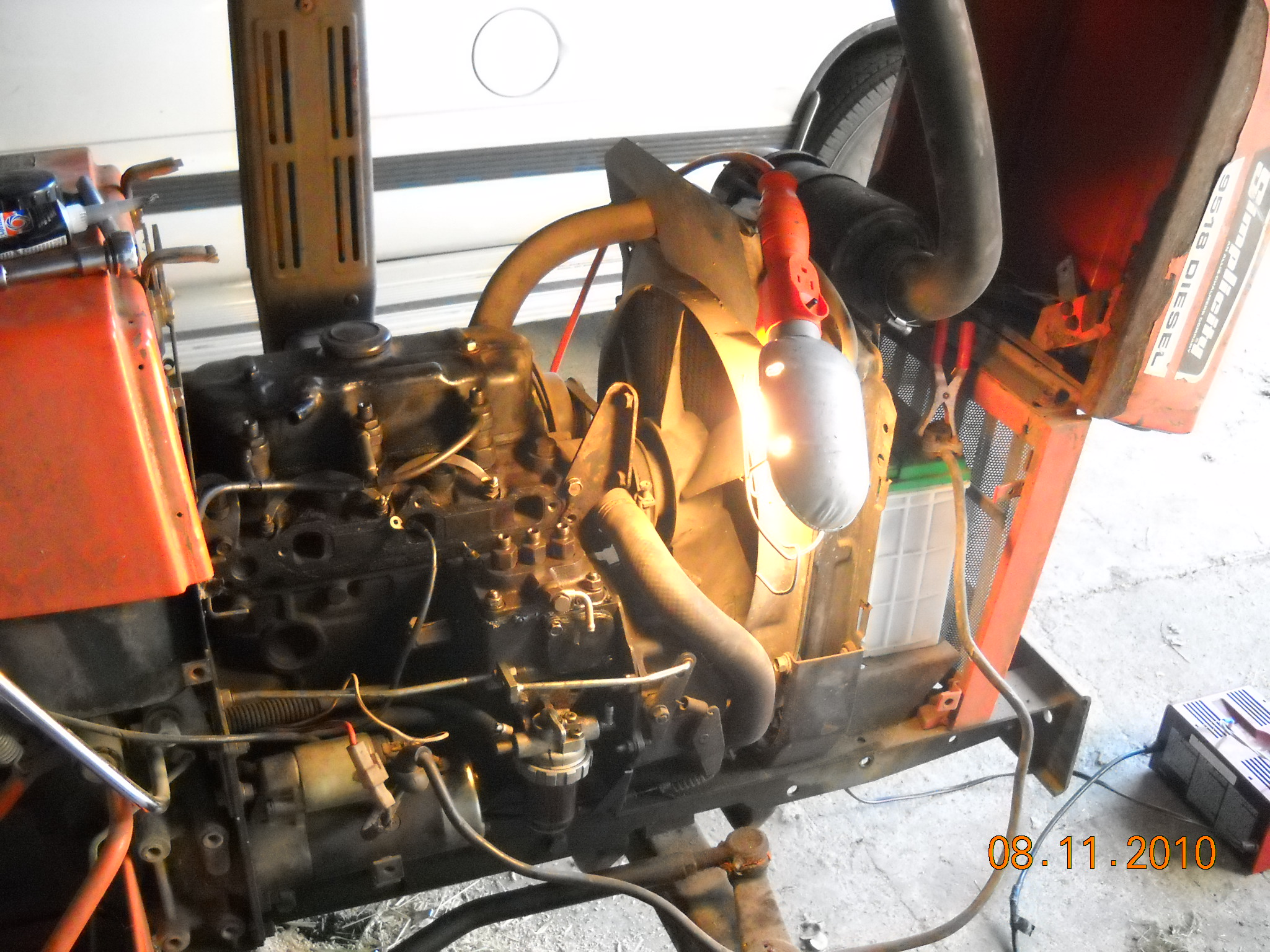

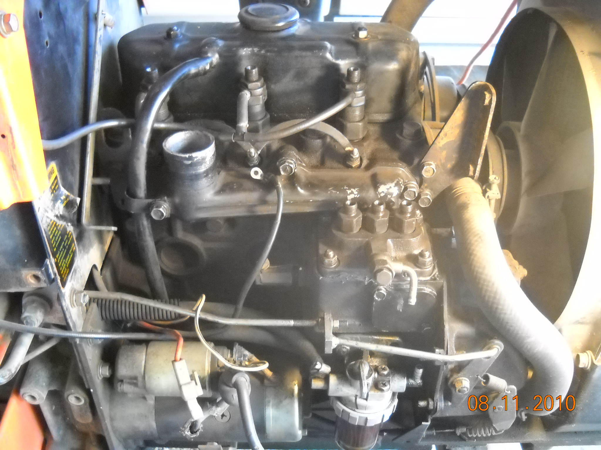

well, i hooked the pump back up again. :confused2: tried cranking it, even sprayed a little eithur in the air intake but is just wouldnt fire.:( Checked the glow plugs, theyre fine. so you probably know what this means, time to take it back apart again. :(:mad:

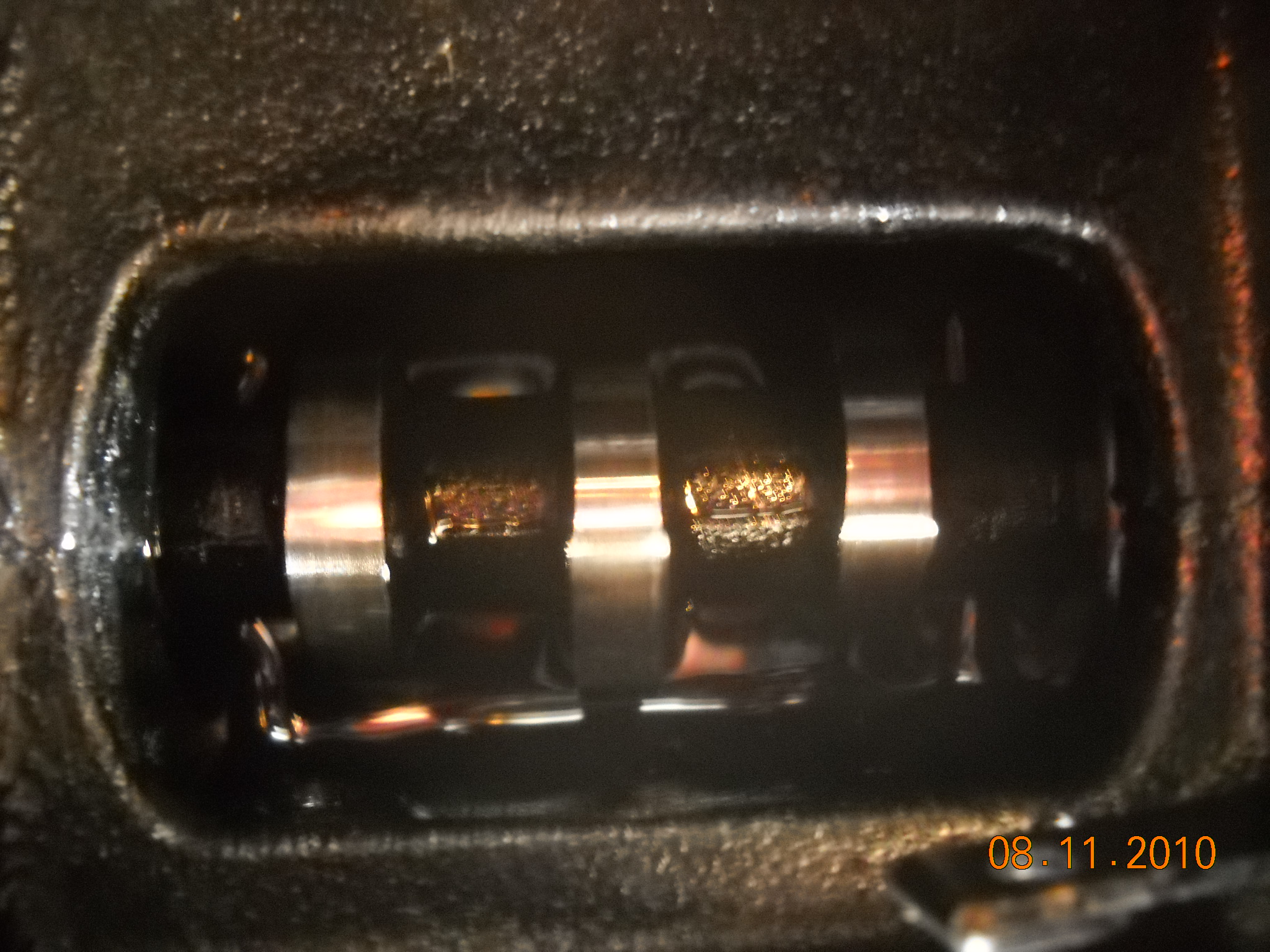

well, i yet again have taken it apart, wondering why the pump isnt pumping enough fuel to start er' up. I checked out the cam and it is fine. rotates like it should, isnt wore out. So i brough the new used pump to NewHolland and a mechanic checked on it. he took it apart and said it was in fine mechanical condition but since it isnt pumping at 4000 PSI, i should send it back. So i called Roberts Tractor and i will be sending back this pump and will be getting another one off an Allis Chalmers 5015. The mechanic at NewHolland said that the pump appeared to be rebuilt. So i guess my tractor will have to wait yet another week-2 weeks until it will start. :( You can see in the first picture, it is very dificult to put it together and take it all apart. :(
