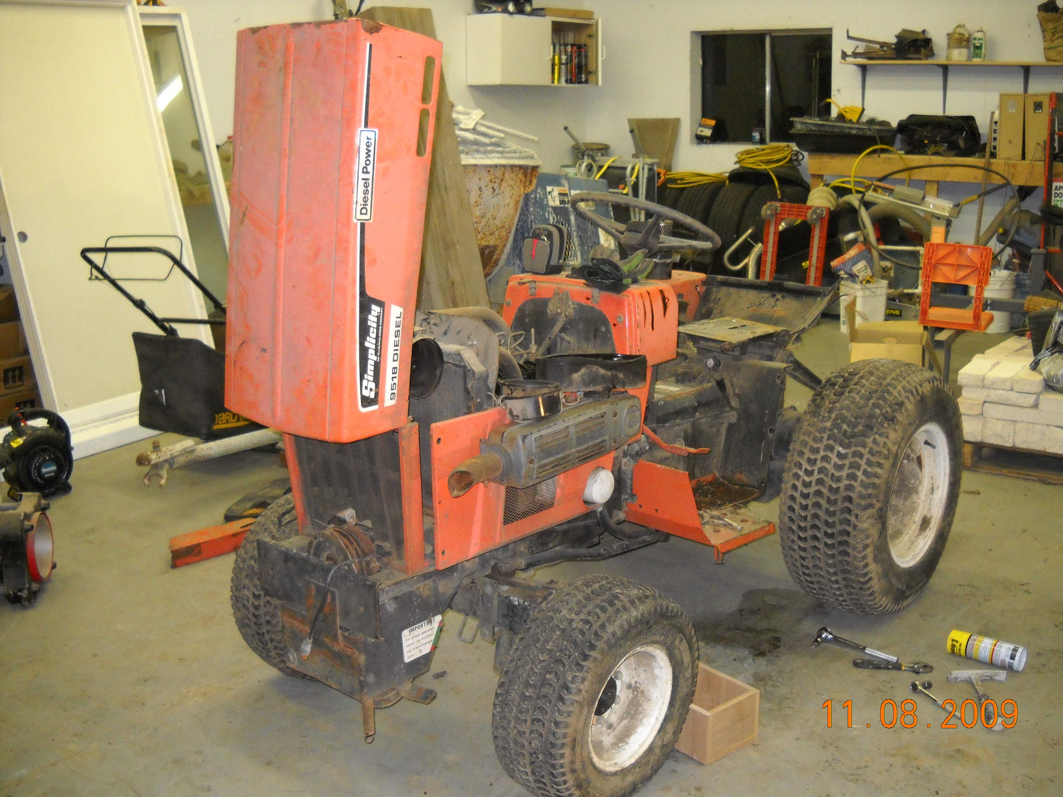

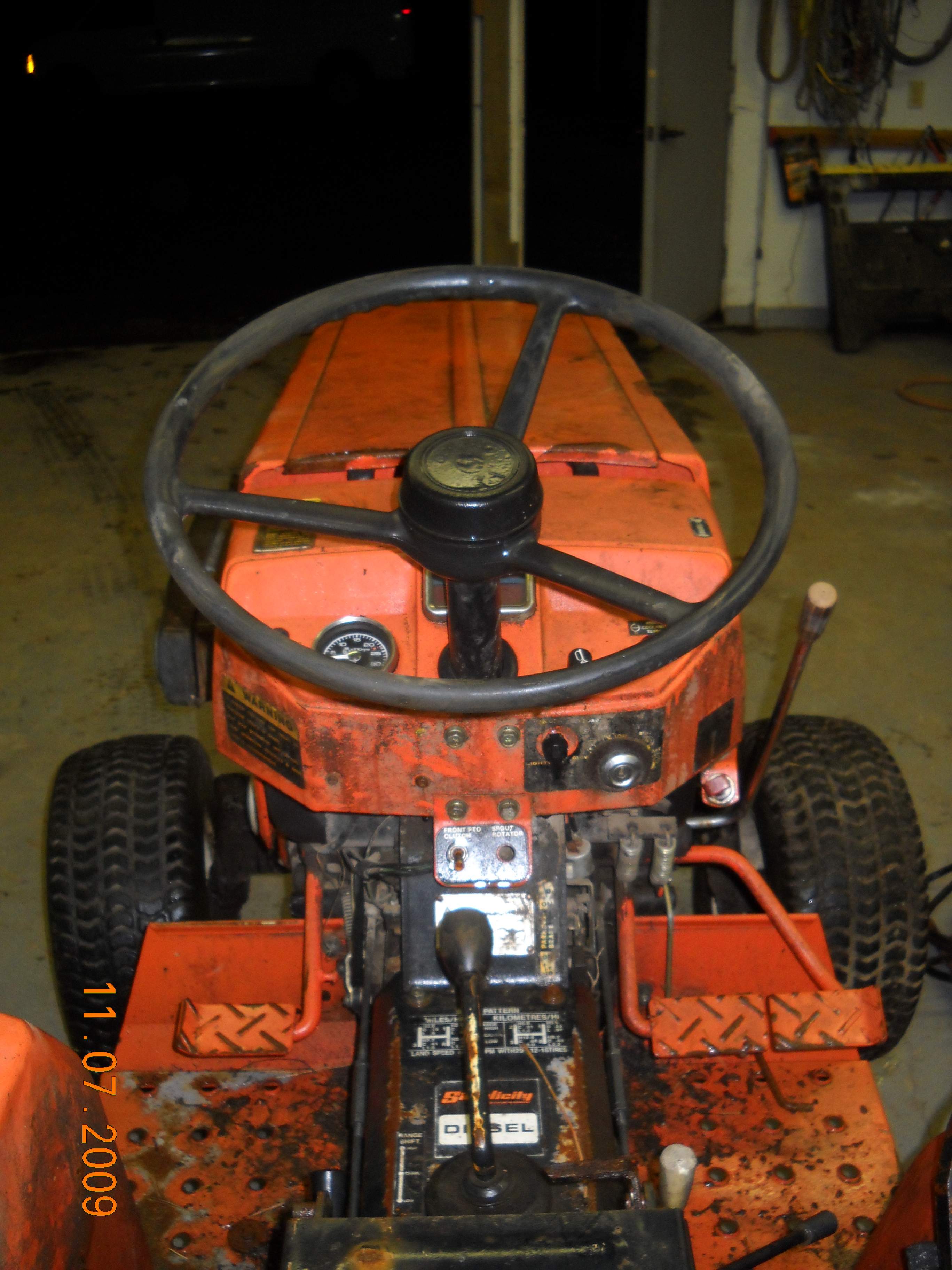

Well, havent been able to work on the tractor lately since ive been at my moms. Next weekend im gonna see if i can start it up.

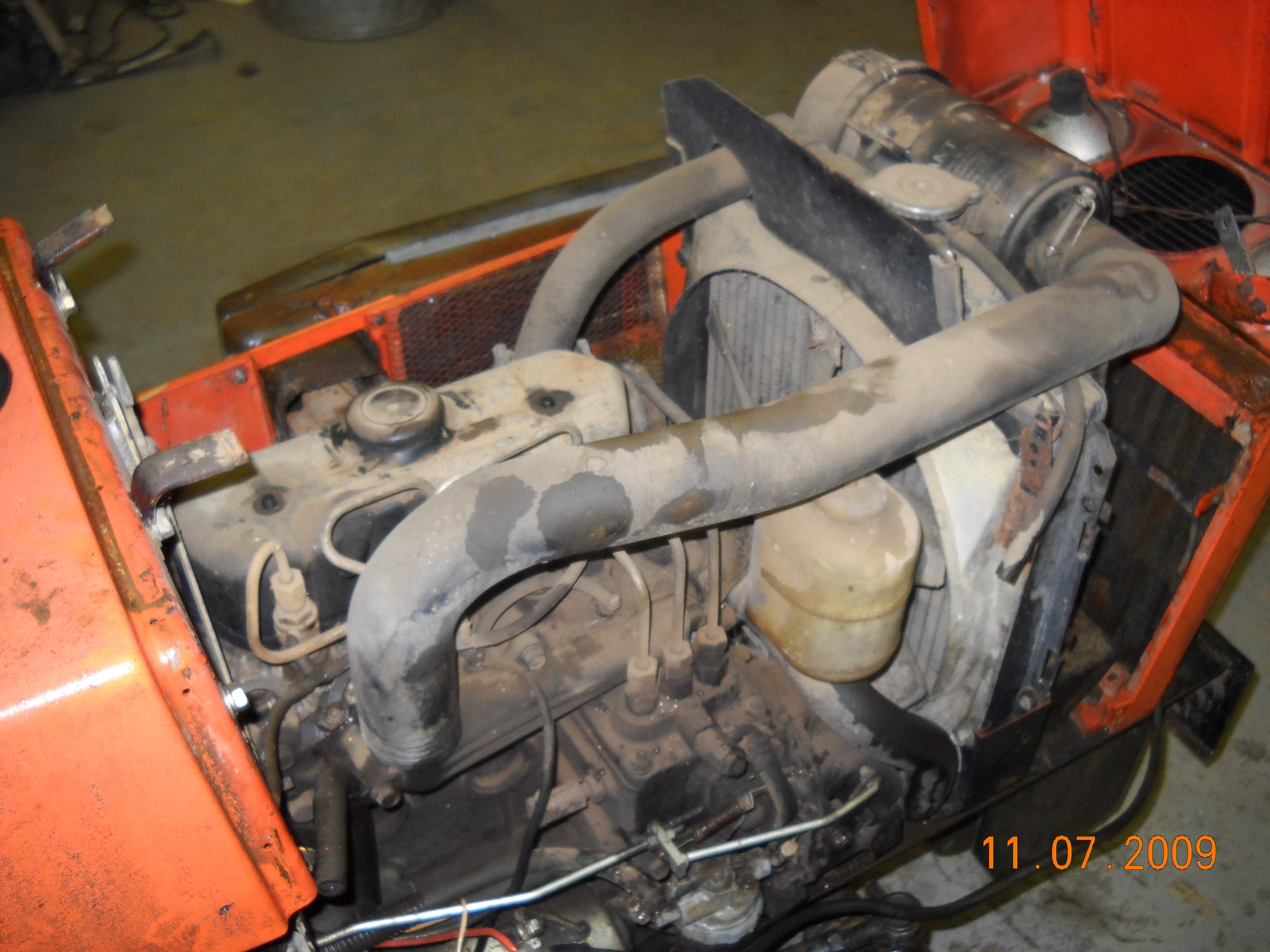

I found out it is a fuel bowl with the part number as simplicity 2098414. I need help finding one to use. I tryed napa's site but it wouldnt respond. here is the diagram. Parts and Diagrams for Simplicity 2097353 - 9518, Compact Diesel Tractor, Turf Tires
72101342 (cup) is the part number you should be referencing. I just purchased one for my Simplicity 9518 from my local Massey Ferguson dealer. Was less than $10. Mine was gummed up with varnish and crap from running biodiesel. You can search for parts under the Allis Chalmers model 5015. Go to (w/ Internet Explorer; Guest account doesn't work with Firefox) : AGCO | Parts click on agcopartsbook.com link and sign in under guest user. You can view all the parts books for your tractor under Allis model 5015. Napa sells many common service parts for these tractors under Allis Chalmers 5015.
FIL 1210 hydraulic;FRAM PH4386 oil; FIL 3282 Fuel Filter. Try to reuse your glowplugs; they can only be purchased through AGCO/Massey and they are $70 each. Special size NGK plugs. Called NGK to find alternate dealers but none exist.
Make sure you put motor oil in your injector pump. Owners manual calls for 7 ounces; excess will spill into crankcase.
I have the owner's and parts manual that I downloaded for free from the Simplicity website under model 9518 in PDF format but they are too large to attach to TBN posts. 9.55 MB zipped.

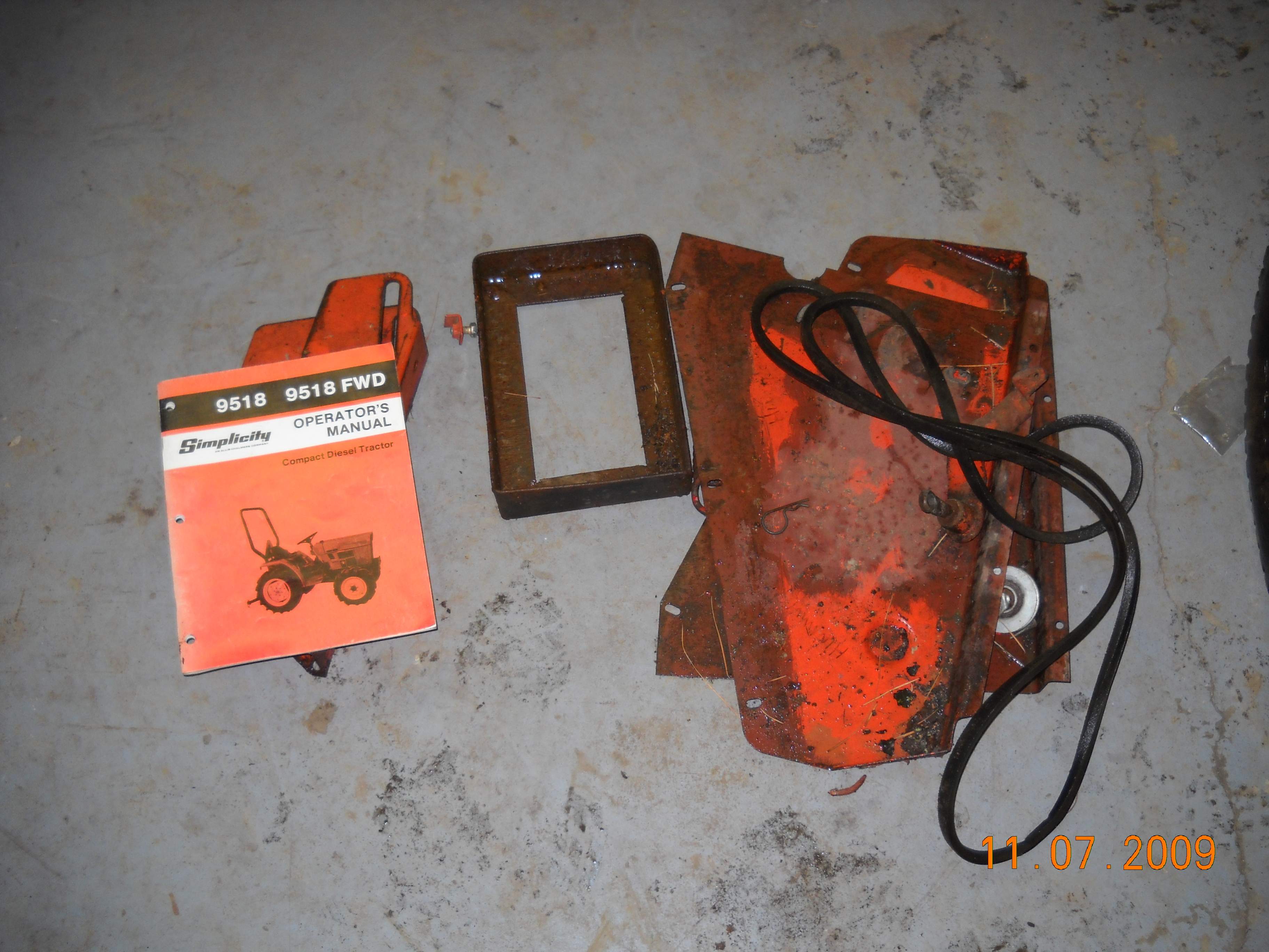

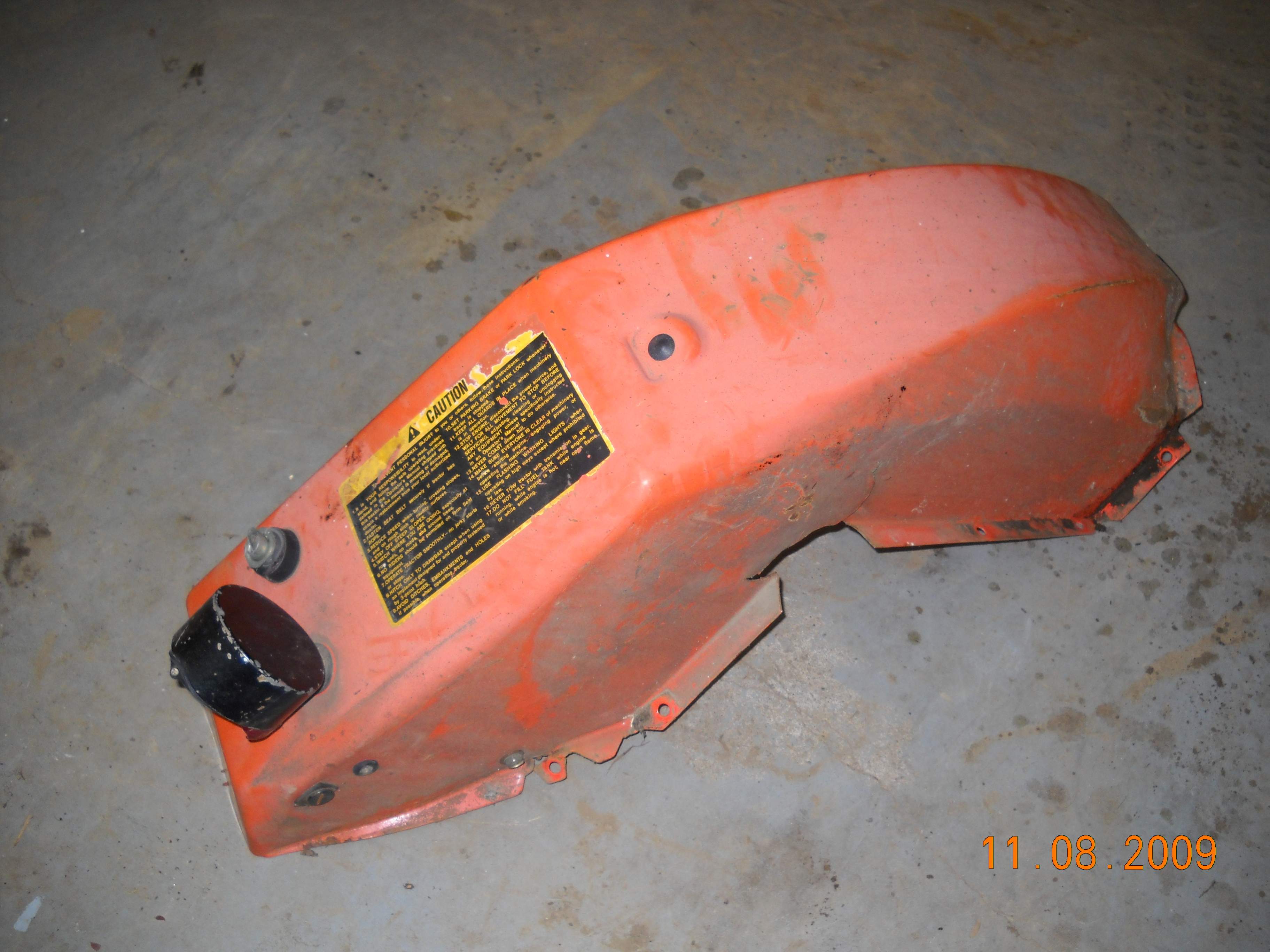

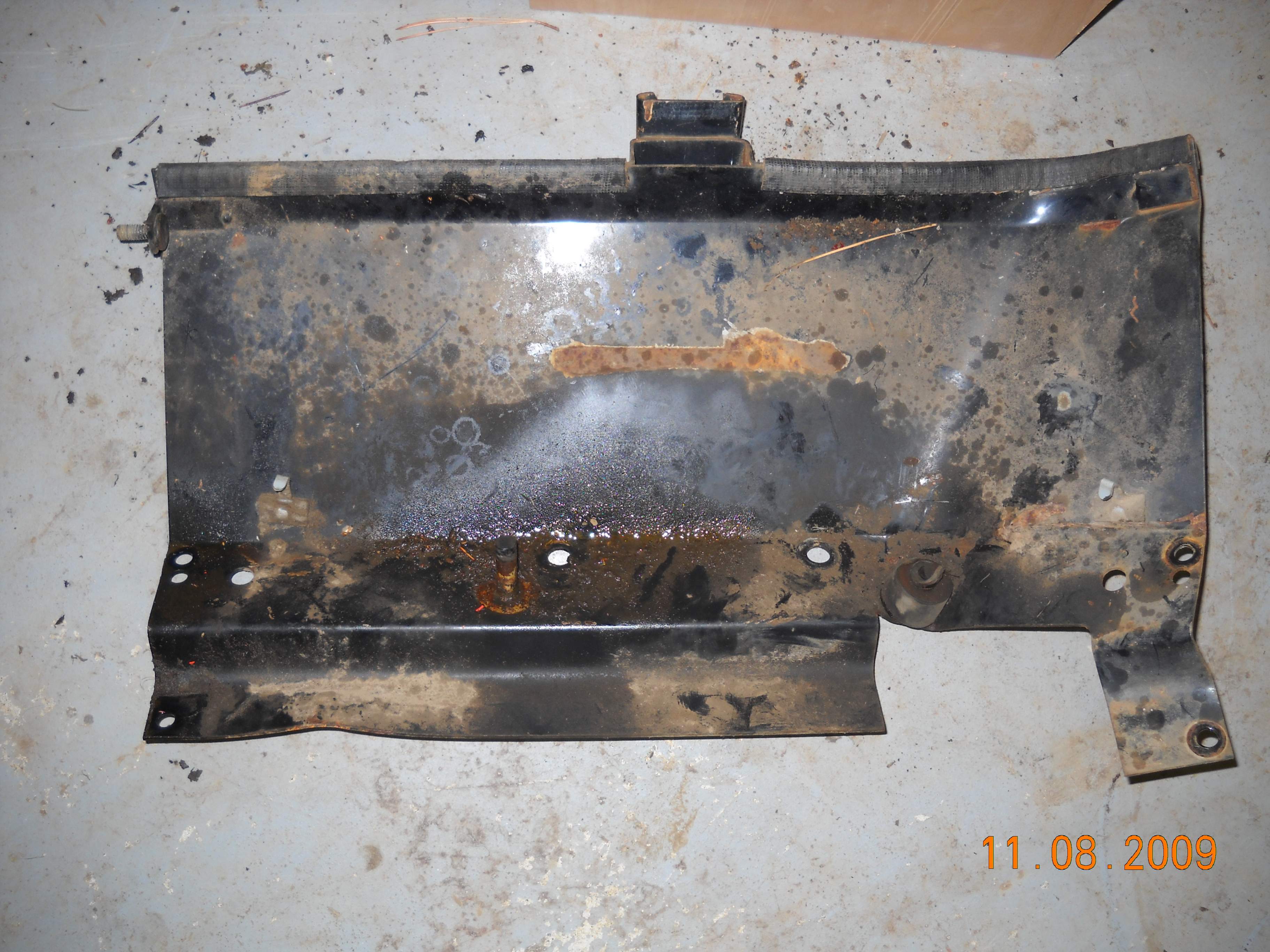

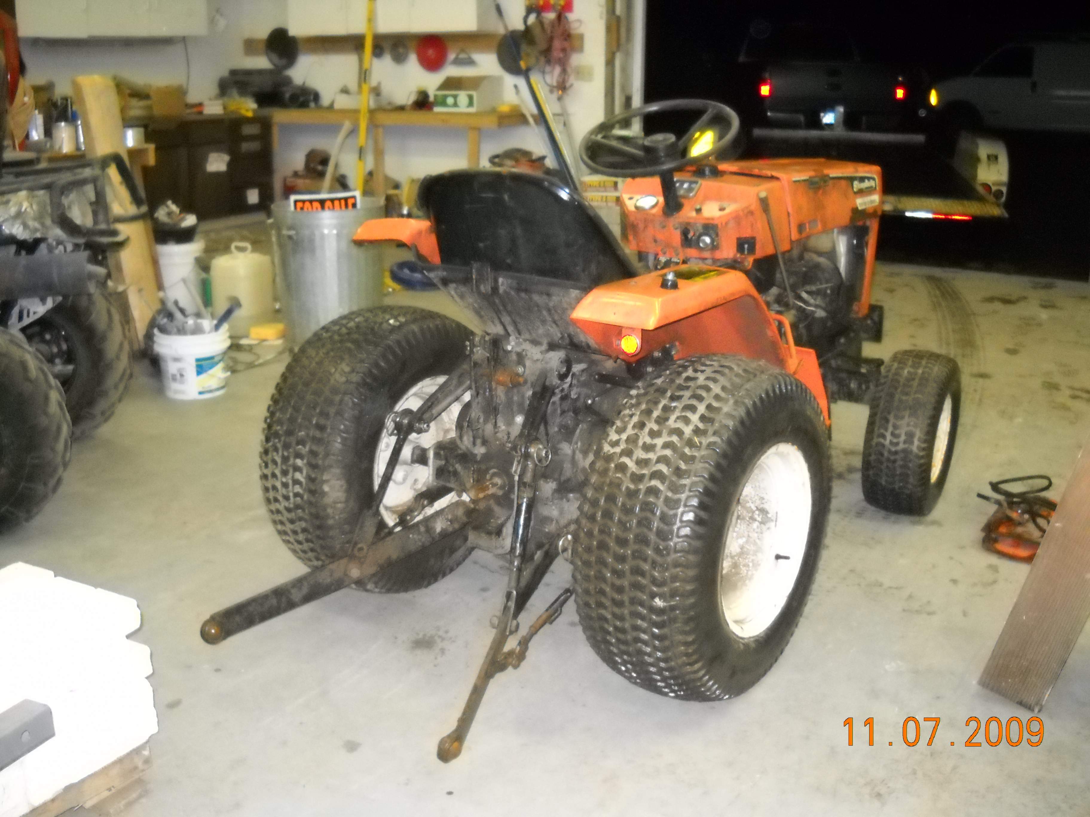

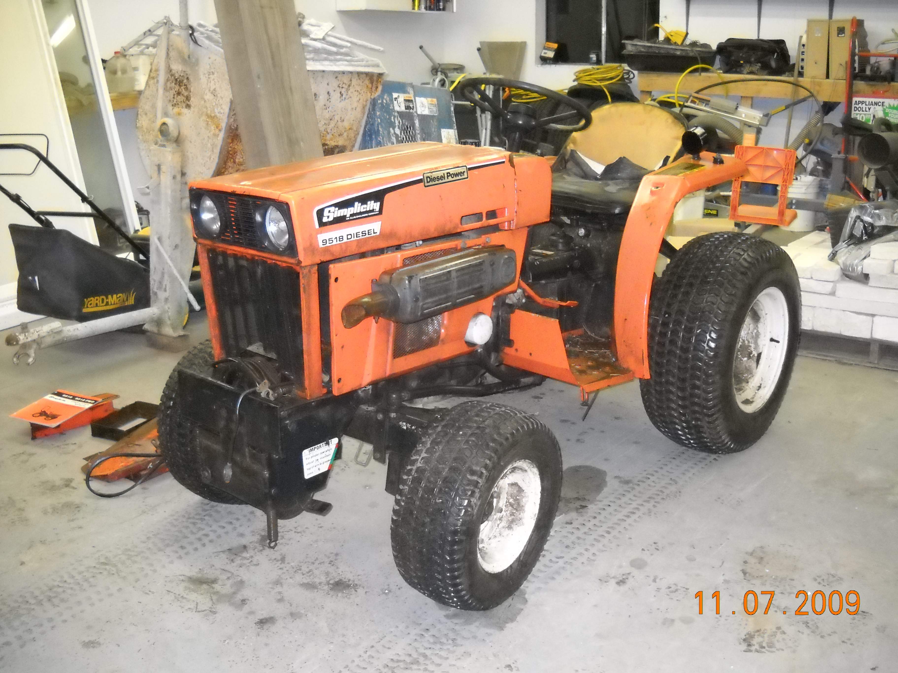

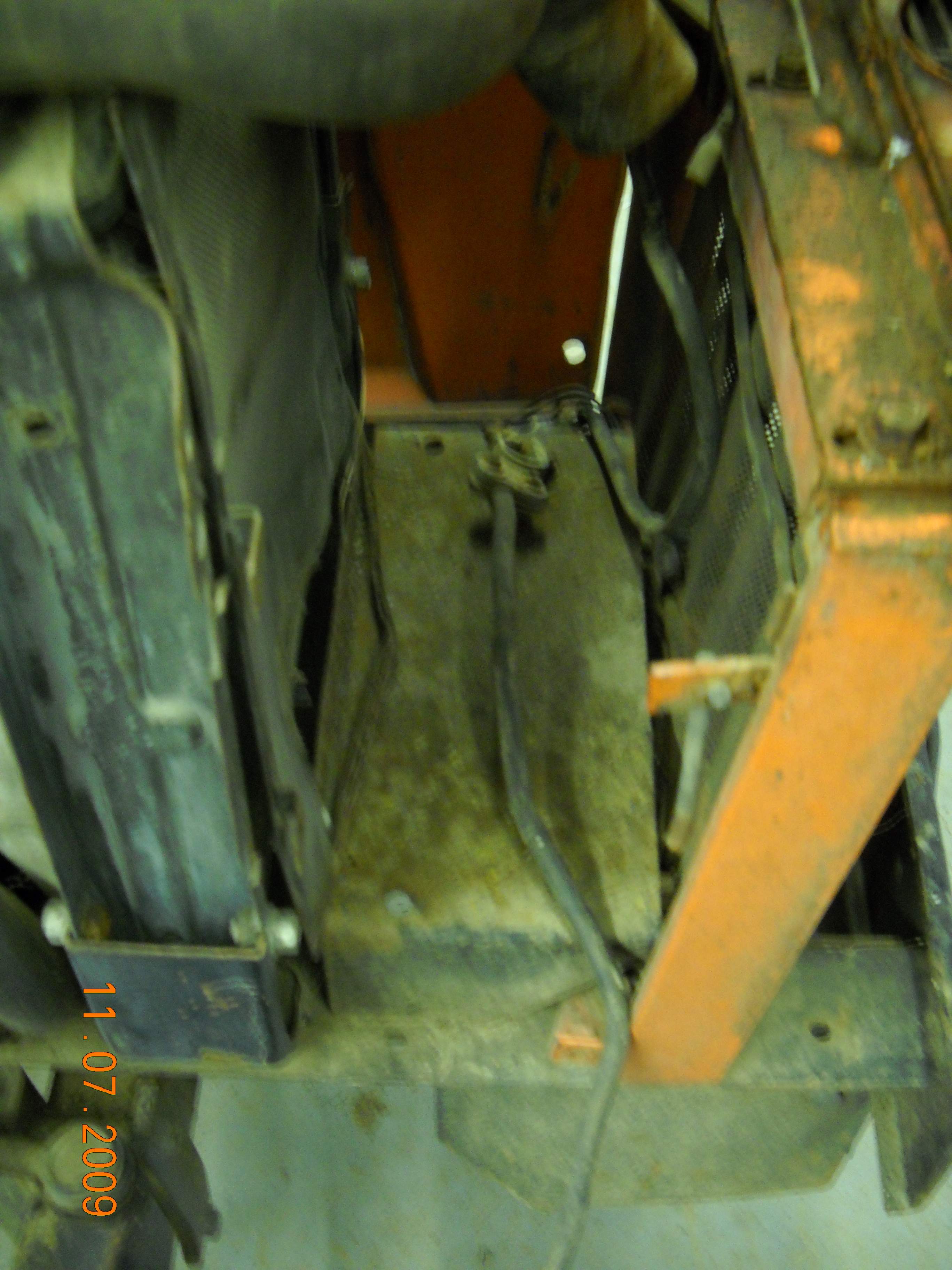

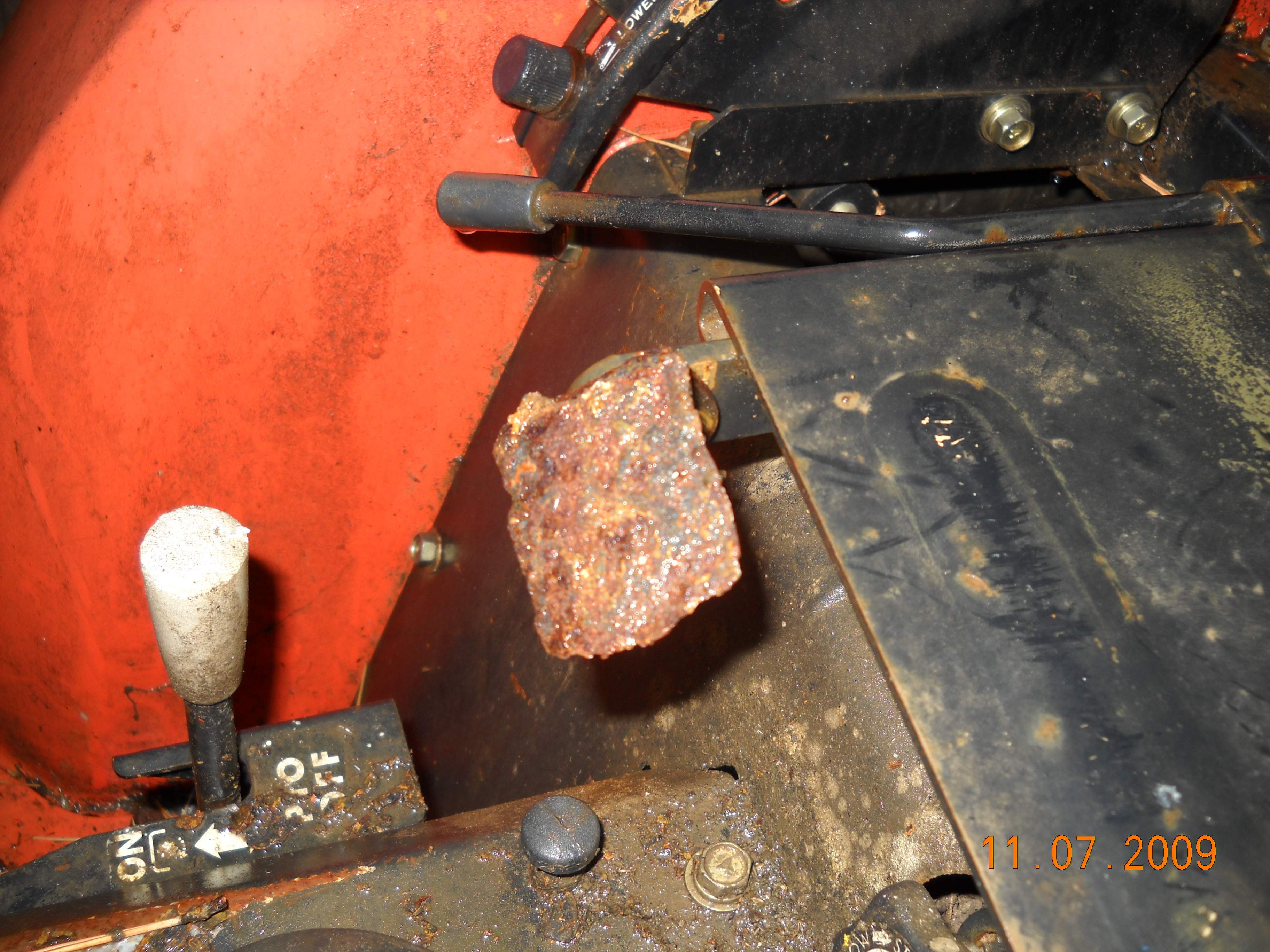

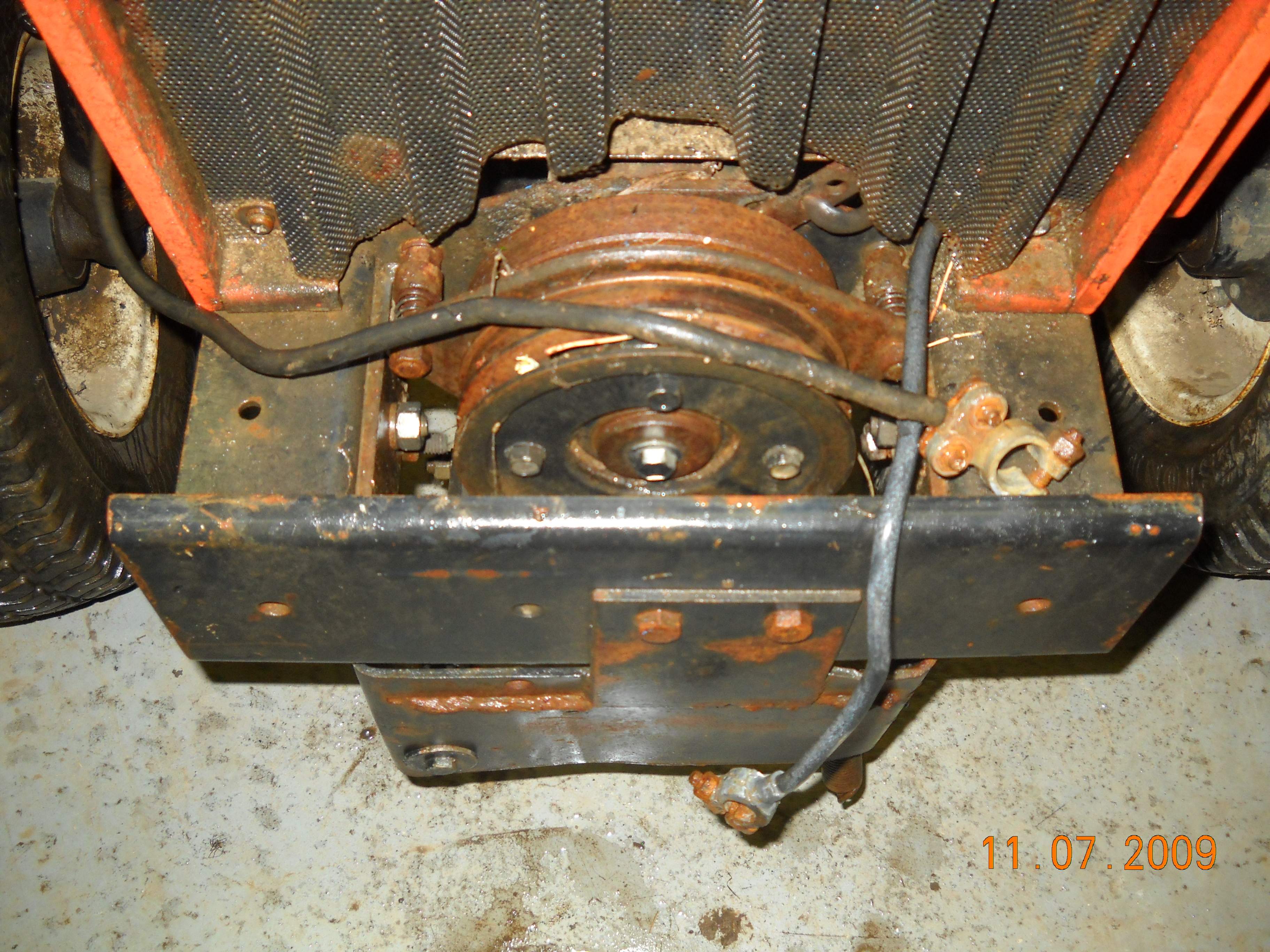

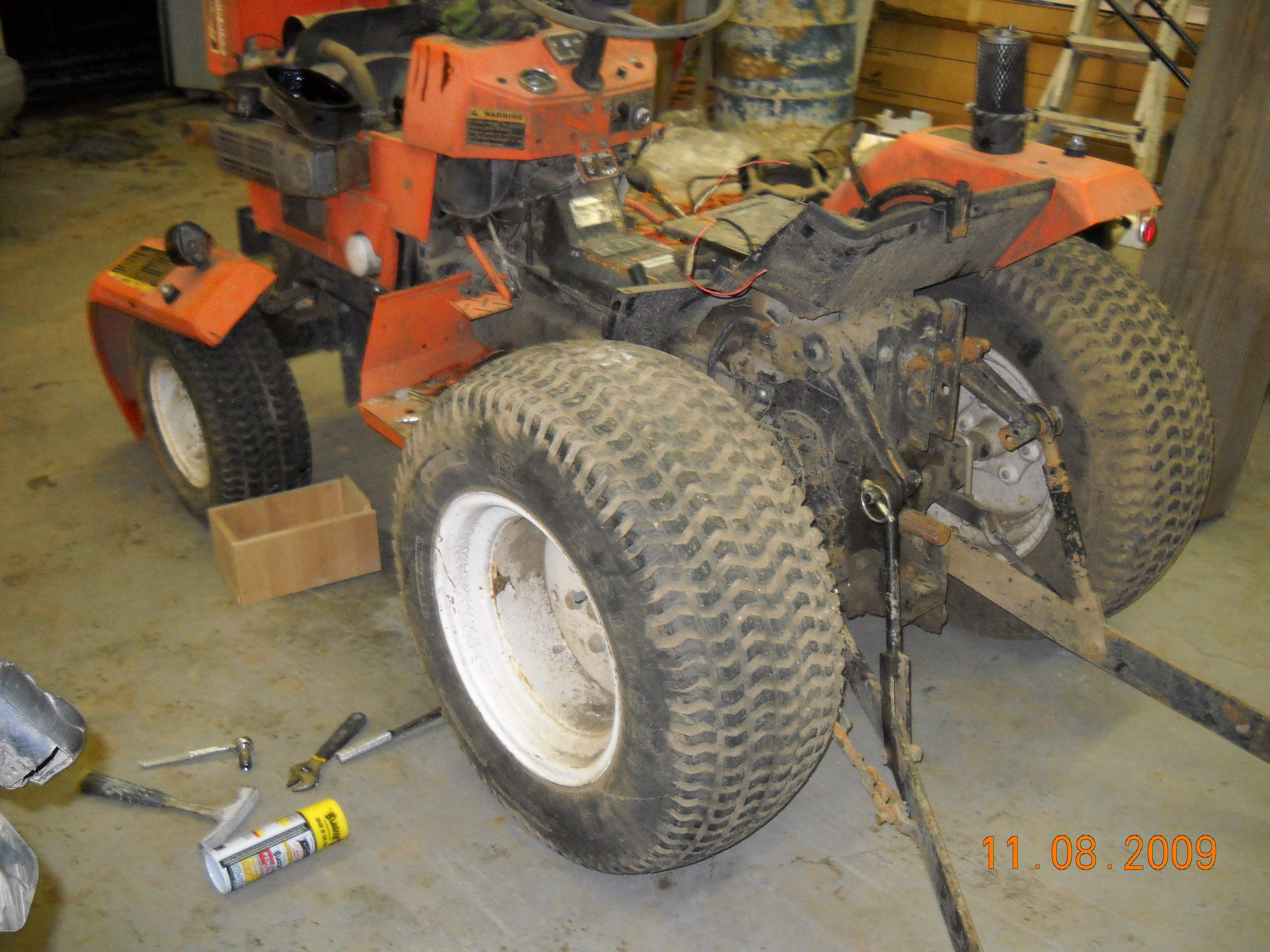

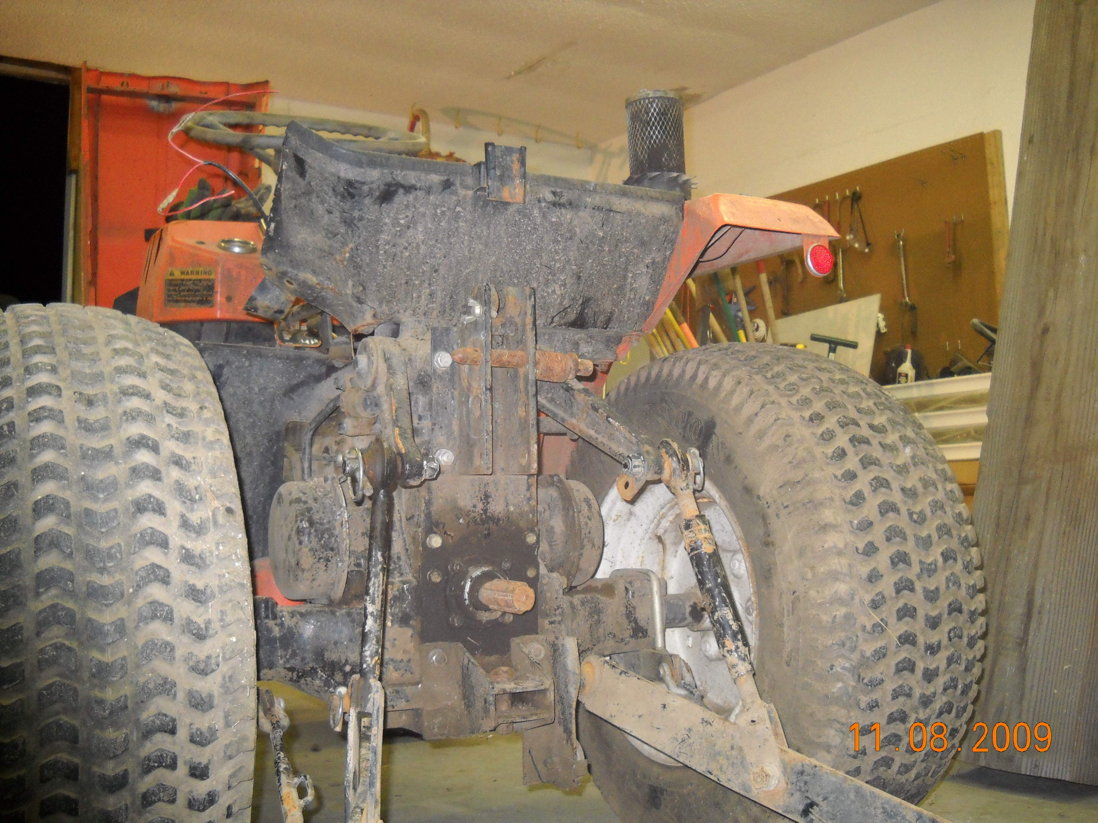

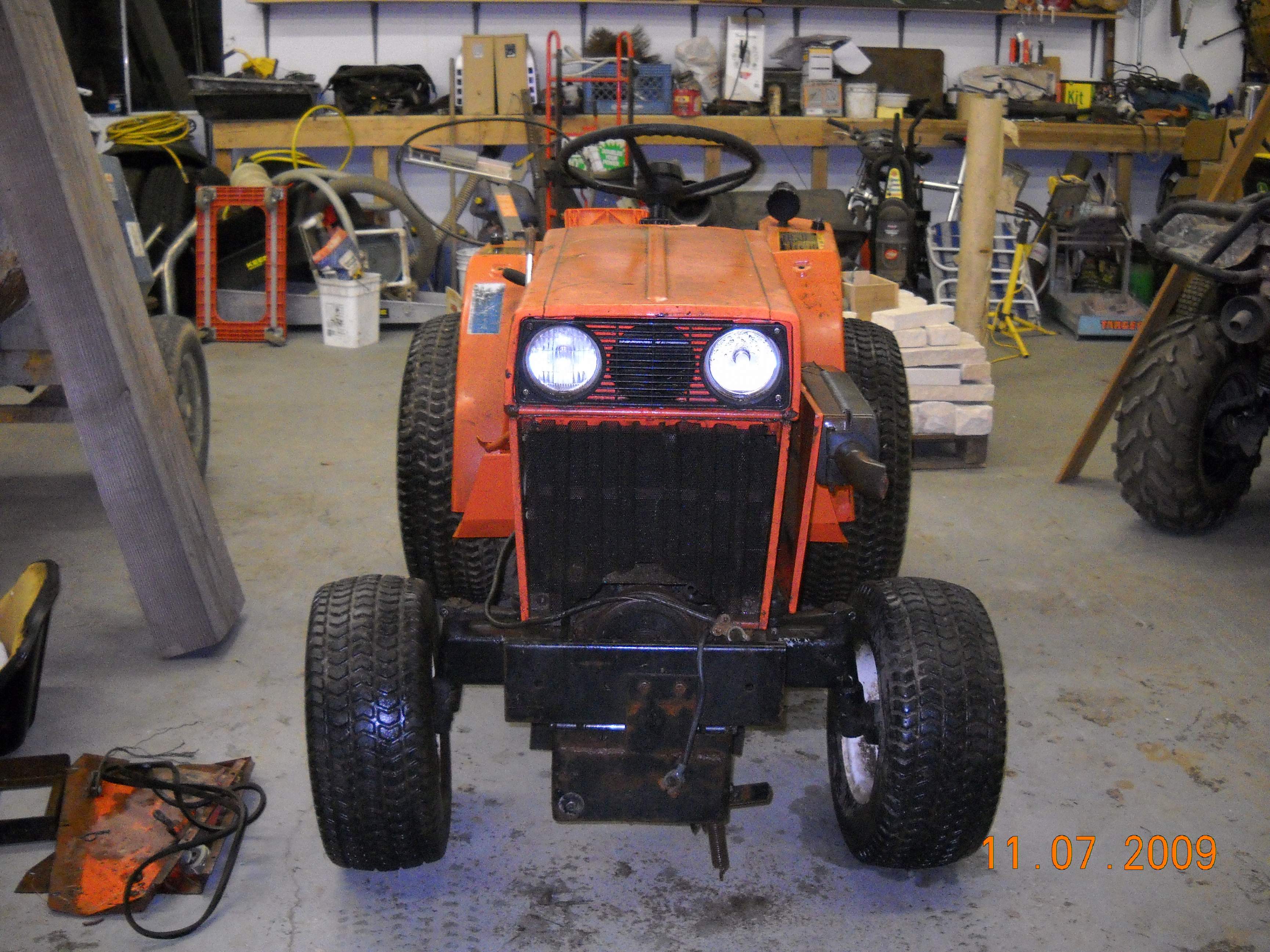

Got to work on my tractor this weekend. First thing i did was rotate the muffler upward, to make it look more like a tractor. It was sideways since the previous owner probably used it to mow under trees. Then I removed the belly mower brackets and part of the assembly on the front. Removing these made it look even more like a tractor than a lawn mower. Then I checked out the bearing for the PTO. It was perfectly fine. I straitend out the plate that attaches to the fenders and tranny case with my Dad's 3720. I also found an area that looks like i can make a plate that goes up, out, and up again to attach to the ROPS system I got off the neighbor's burned tractor. From the looks of it, I may be able to start my simplicity soon. Im having my dad get some ethur, a new starter, and a battery so we can try and start it up. once its running, then I can work on the cosmetics.

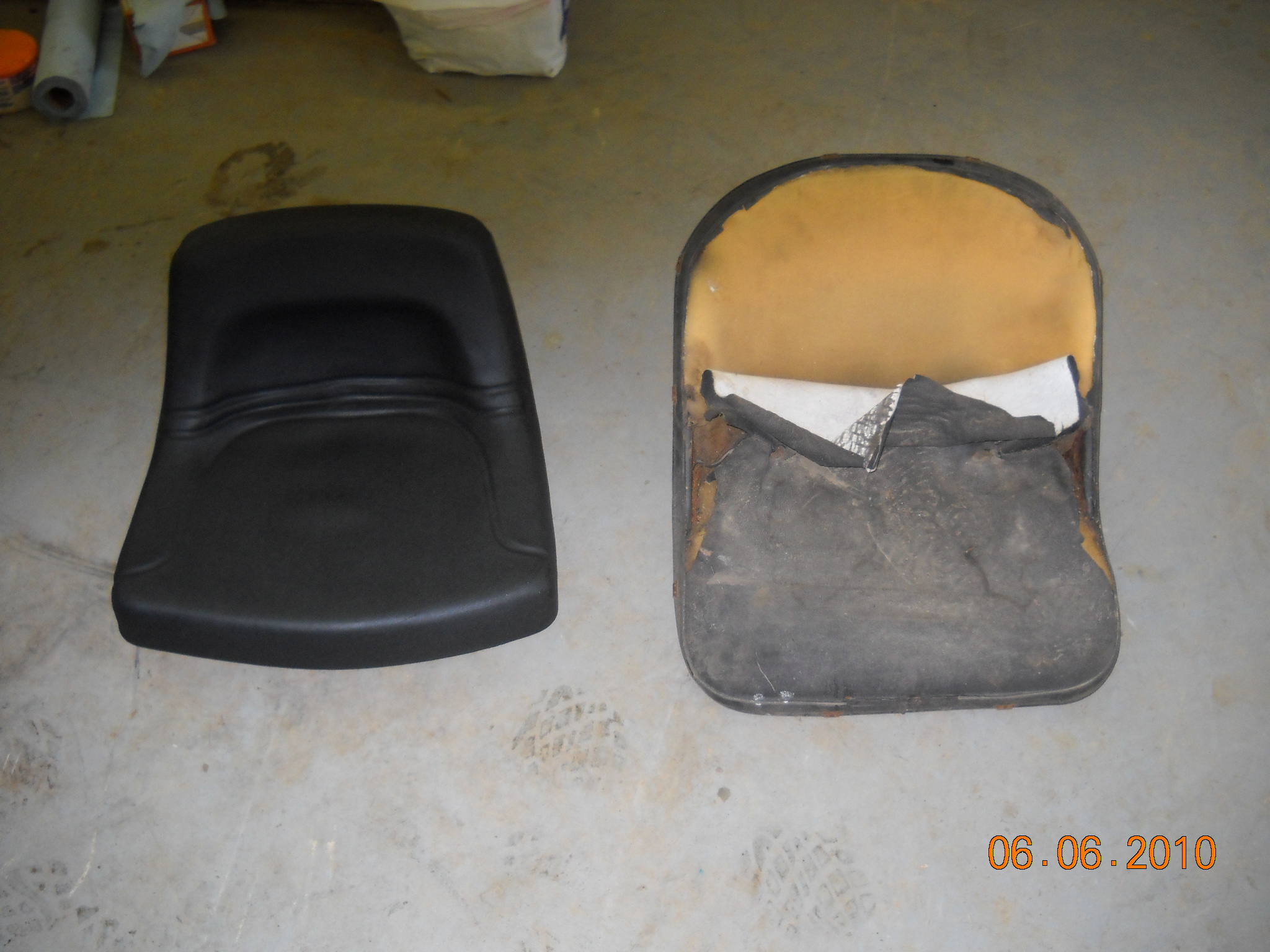

Well, after trying to start my simplicity this weekend, I finally found out why it wouldnt start. My fuel pump was not providing the engine with diesel which is why it wont start or run. I know that fuel pumps are rather dificult to rebuild so we brought it to NewHolland this morning to have a certified mechanic fix it. We loaded it on the trailer by wraping a chain from the bumper of the tractor to the 3 point on the Deere. We jack knifed the trailer so the chain wouldnt hit the truck. Worked pretty well. When we got it there, I found out that one of the mechanics there used to work for simplicity so he knows my tractor inside and out. So this week, my simplicity shall be running once again for the first time in 15 years! Also, i finally got a new seat for it last night so now i can throw out the old one and be comfortable for seat time. Cant wait to bring it home!
