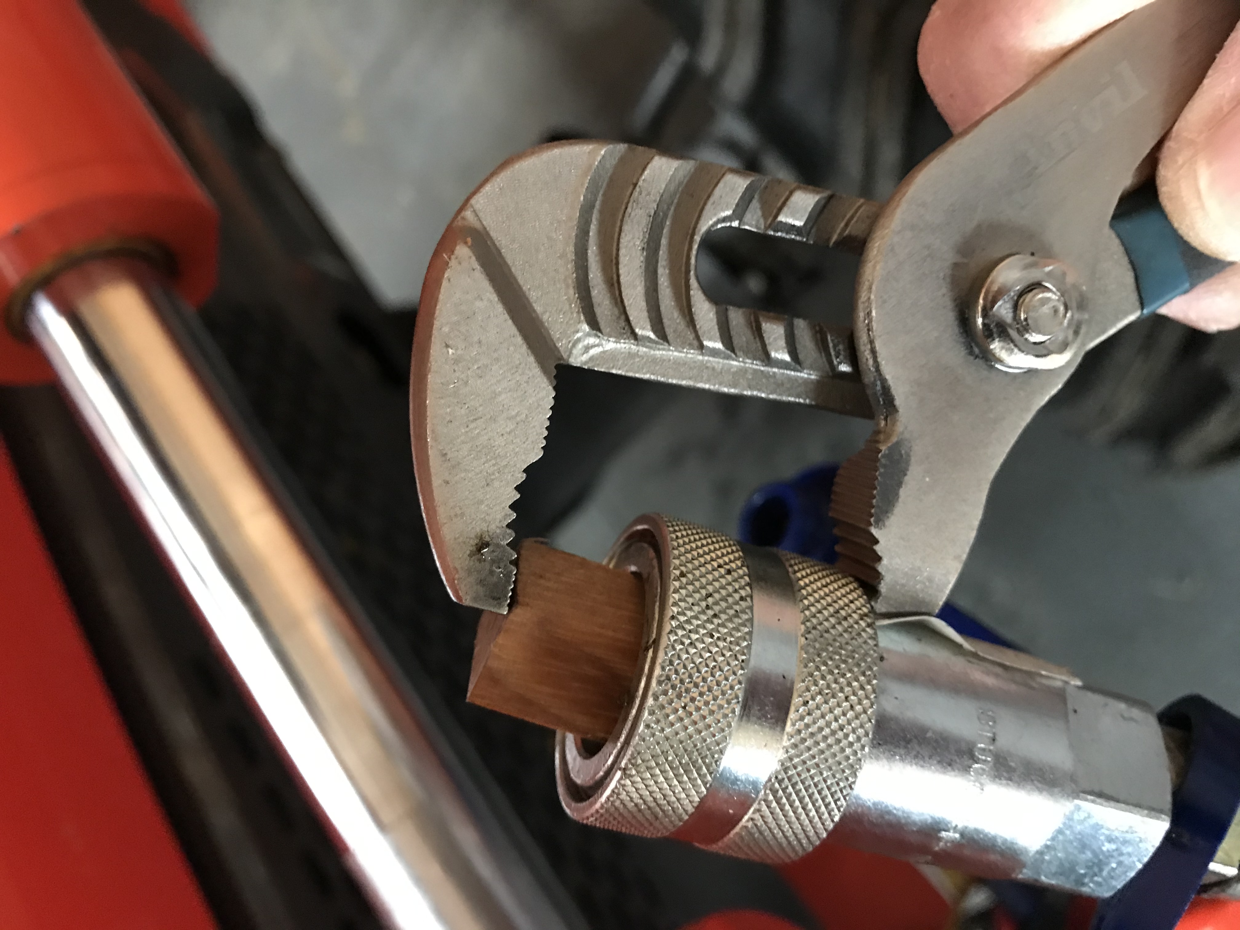

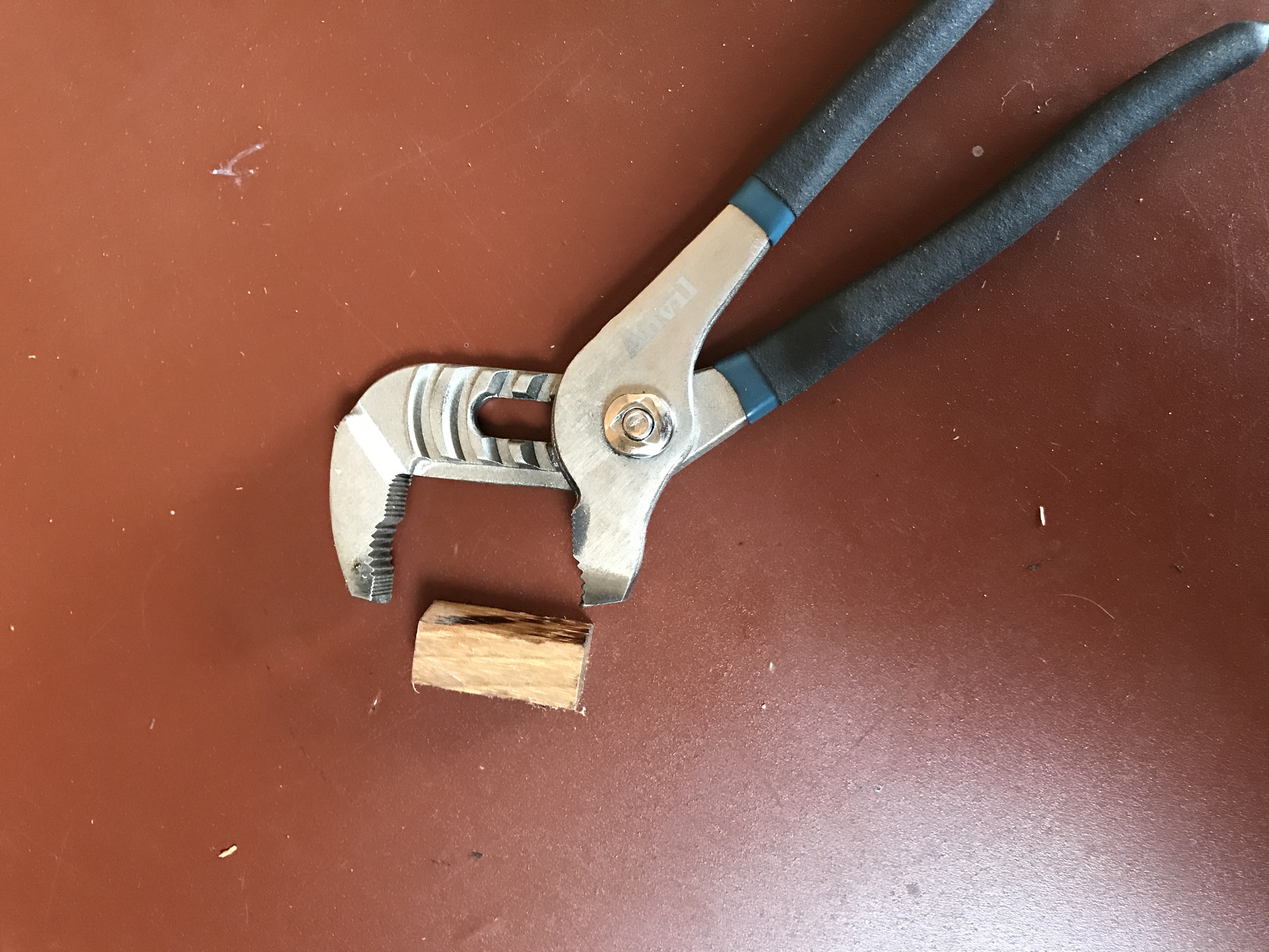

Most of the time I can reconnect the loader hydraulics without trouble. There have been times when it took way too much effort. A month or so ago I damaged a hydraulic fitting by tapping on a piece of allthread to relieve the pressure. Wanting something more fitting-friendly this is what I came up with. The cheapest small pump pliers ($3.99) at Tractor supply and a slice of hardwood. The hardwood is from an old axe handle.
Both jaws have been ground down a bit. The lower jaw had more removed so the top jaw could be more centered over the wood. When positioned as shown, I wrap a rag around the pliers / fitting so it doesn't squirt all over the place. Works great.

The pliers apply MUCH more pressure than when pushing the connectors together.

When I drop my grapple if it’s a hot day it tends to build up pressure if it sits in the sun for a while. I pump the male connector on the cross bar on the grapple and use a screwdriver on the female connector. Probably not the way it should be done but it has not caused a problem yet. The OP’s idea is probably better than my approach.

I remember seeing a commercial tool that did the same thing but I was too cheap to buy it. I will make up a brass or aluminum piece in place of the wood plug, drill a hole in it, and attach it to the plier so I do not lose it.

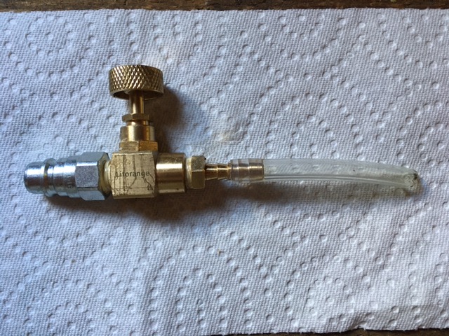

Was having trouble with 2 of the female connectors on my loader so I made up a couple of these. Connect them to the loader when I take it off, crack the needle valve to relieve the pressure and they connect easily to the tractor.

I like it. So far, i've been able to fiddle around to get them to work but when they finally let me down, i'm gonna wish i had one of these!

I can see the valve trick working, but unless you had everything on hand, it would cost a whole lot more than a small hammer and dowel.
/ Simple tool for relieving hydraulic pressure #19
Used a hammer and dowel for about 3 years and ended up having to replace 2 of the connectors because. I damaged the orings. That's why I was looking for an alternative. Got the 2 valves for $16 and the male connectors for $8 ea. On Amazon.
