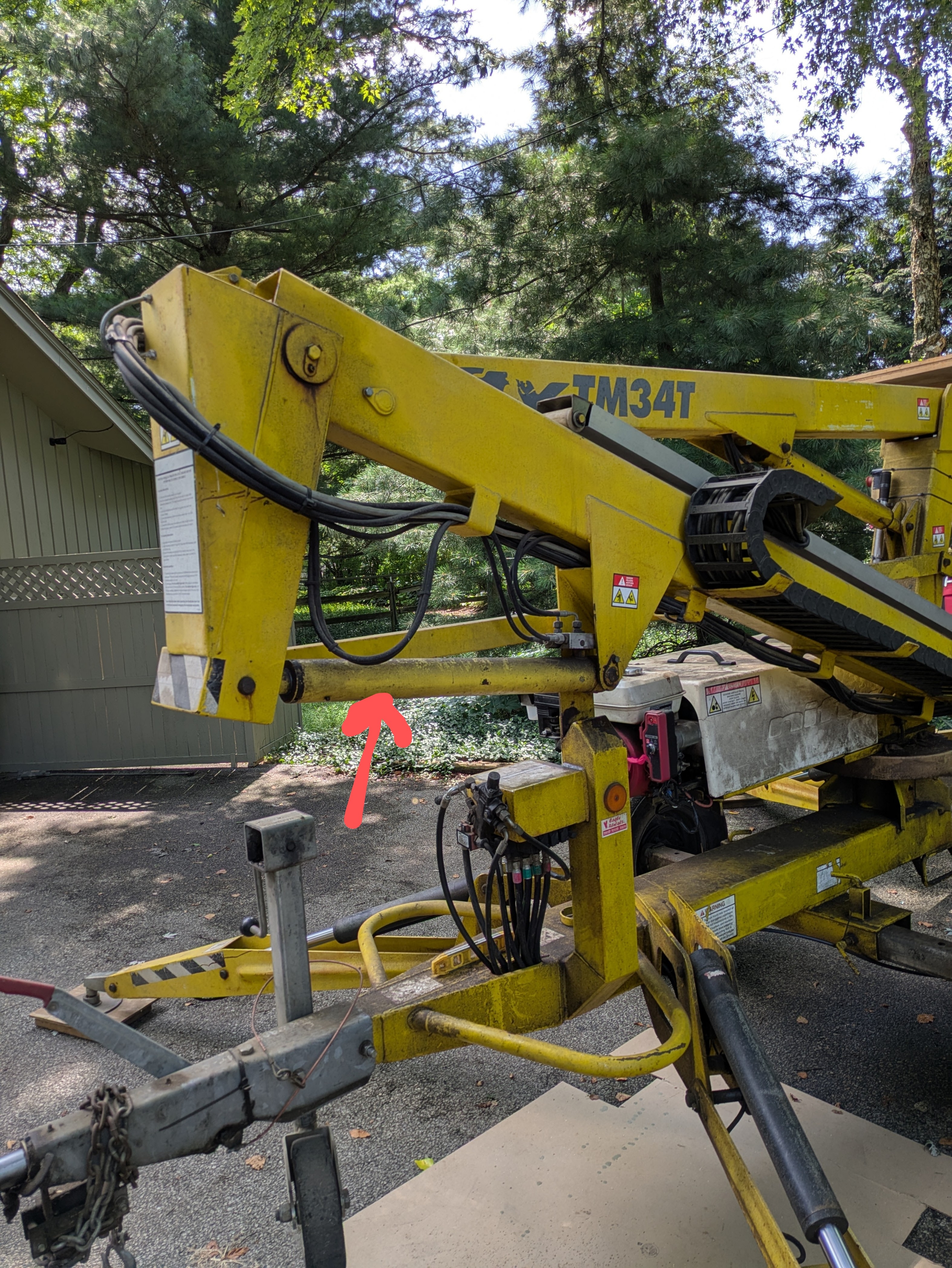

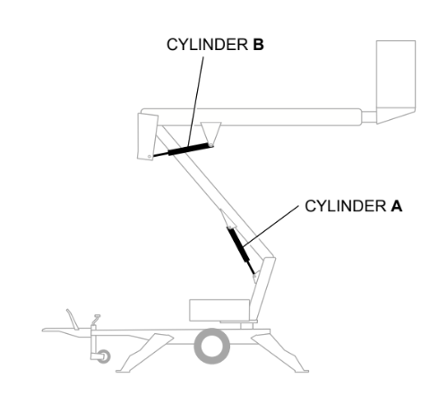

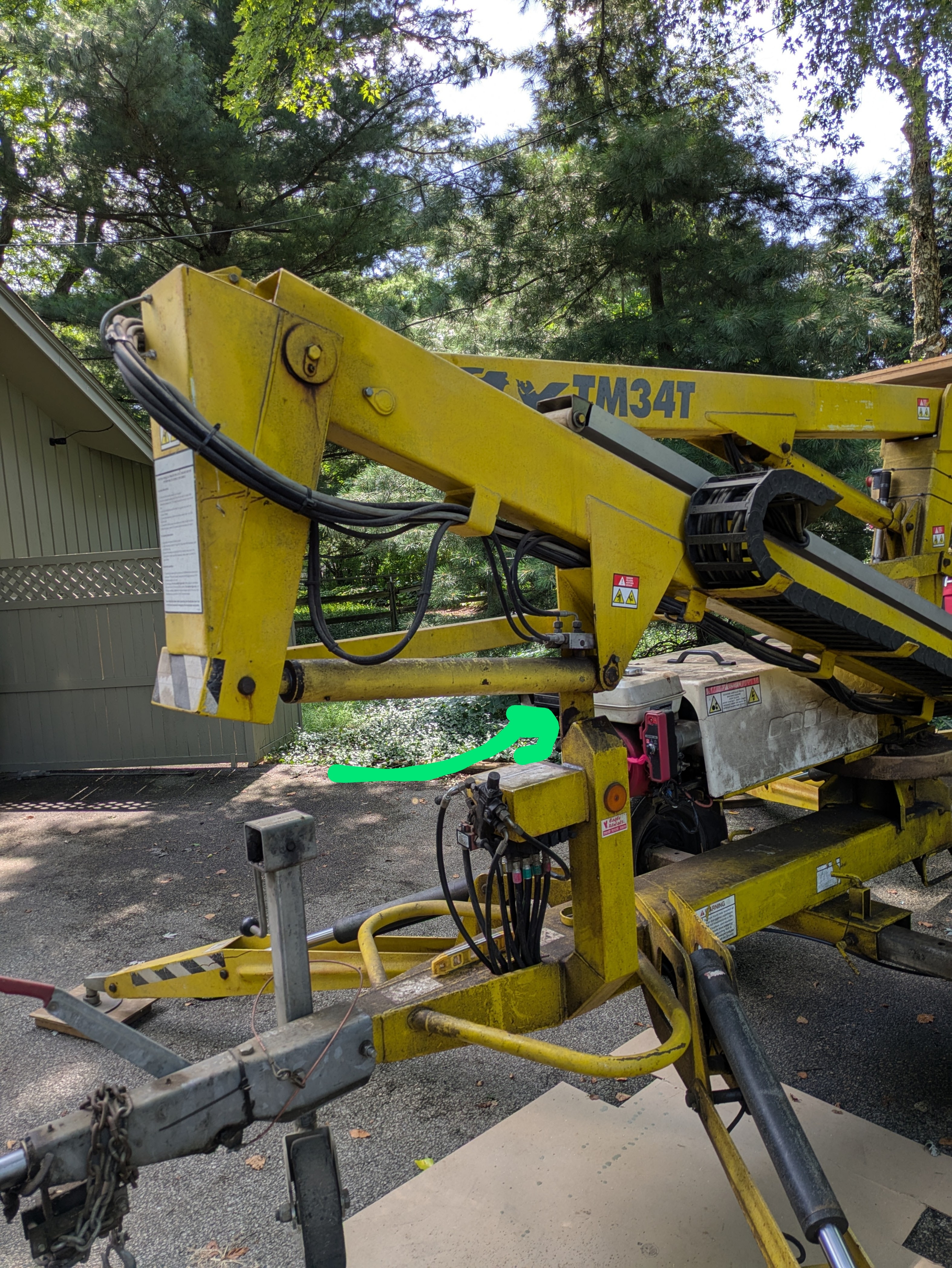

A single acting cylinder on my lift is squirting oil out the vent, so I assume the cylinder seal is bad. The check valve has 4 lines coming into it, I assume because it's synchronized with the leveling cylinder on the basket. My question is what is the safe way to relieve the pressure on the cylinder so I can remove it?
Here's a stick figure of the lift, I need to rebuild cylinder B:
The lift is in the rest position, so I can't see there being any mechanical forces on the cylinder shown by red arrow:

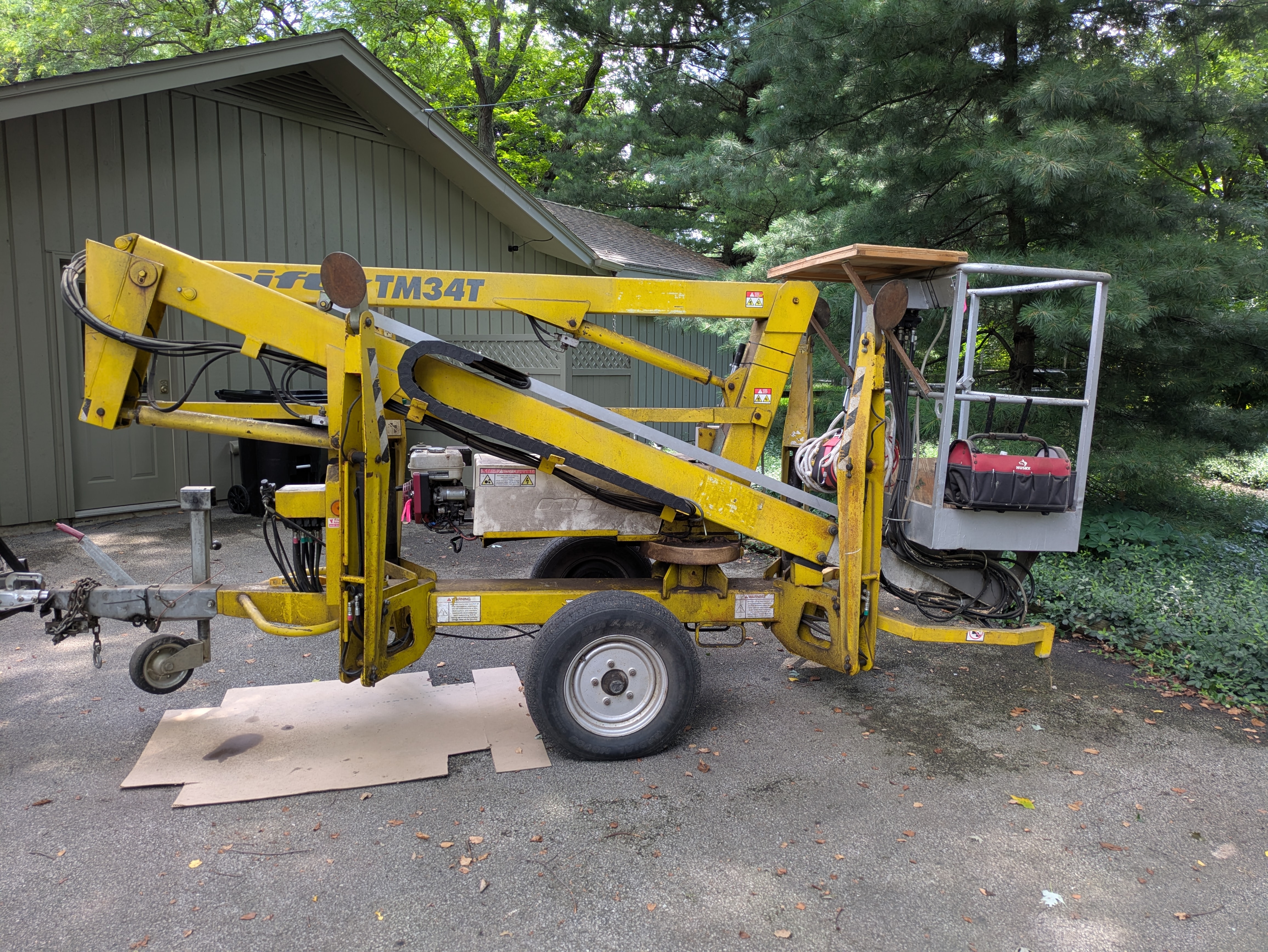

Here's the whole lift:

With lift fully lowered is that bucket arm sitting on a mechanical stop? Looks like it is in picture but not sure. If on mechanical stop there should just be little to no pressure in that line to the cylinder.
   / Relieving pressure on hydraulic cylinder
Yes, the bottom of the cage rests on a rubber pad, and the frame at the opposite end also rests in a cradle pointed to in photo below. I would feel better if that cylinder flopped around a little when I try to move it. It feels like it's being held very tight and I won't know for sure until I drive one of those pins out. Is there any reason to take that check valve off the cylinder when I rebuild it?
   / Relieving pressure on hydraulic cylinder #4
Is there some way that you can slightly lift that boom segment with an overhead chain hoist or a jack underneath to relieve the tension on the cylinder pins. Not sure how close to end of stroke that cylinder is when sitting on stop.
You should not have to remove the check assembly to rebuild the cylinder.
Yes, that's a good idea. Surprisingly I did find a brief description in the manual about removing the two main cylinders. It says the one I'm working on can be removed without any additional support. The other cylinder requires a forklift or something to support the upper boom while the cylinder is removed. I know what I'm doing tomorrow...

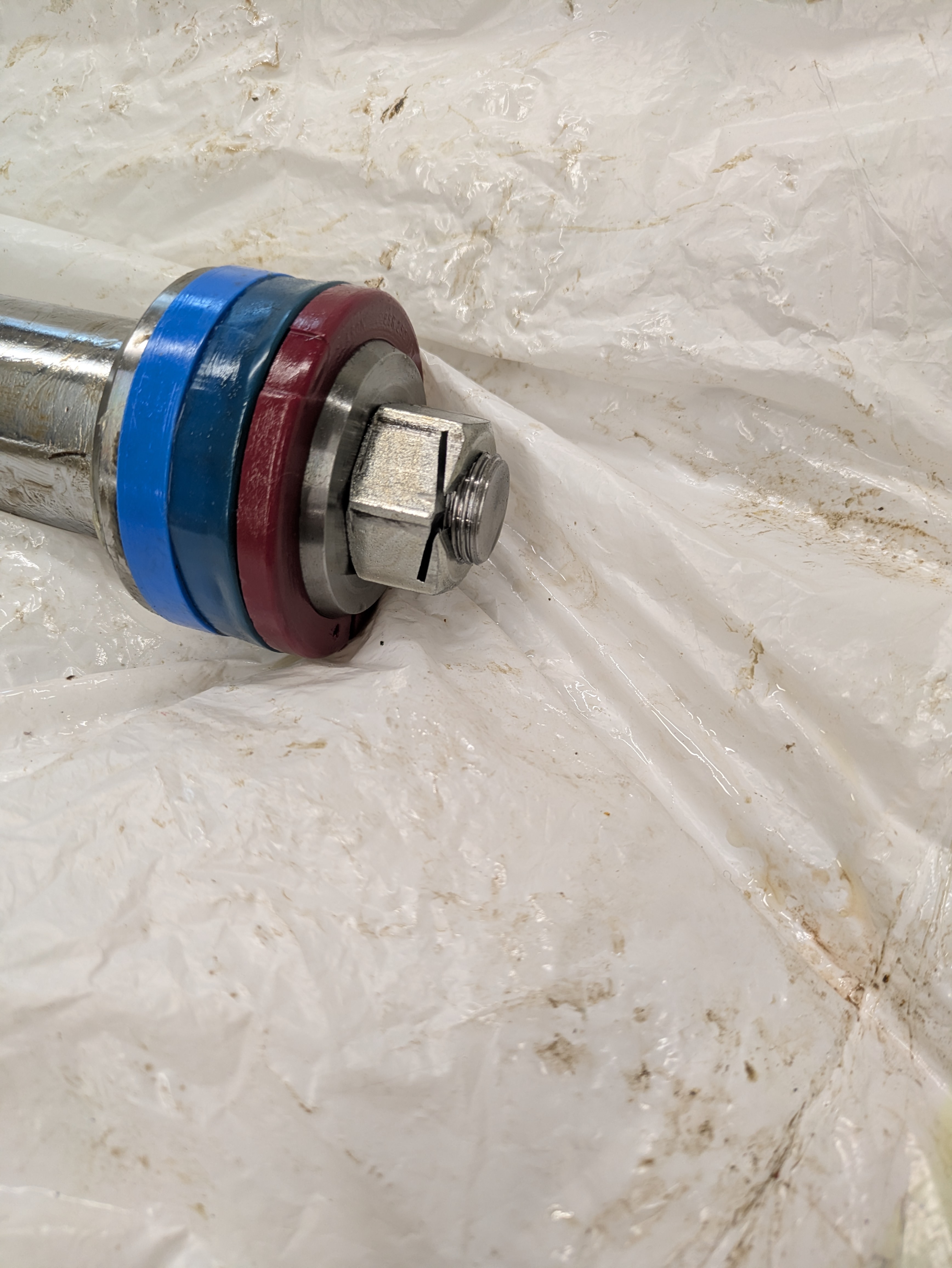

Got it all apart, what is the purpose of the diagonally machined slot in the retaining nut on this rod? All it looks like it does is make the nut weaker.
Seals were cracked from age but the cylinder and rod look like brand new. This cylinder was taken apart before I owned it, so the seals are at least 10 years old. I was pleasantly surprised that the OEM seal kit was $35 and they had it in stock. That saves me taking it to the local hydraulic shop to get after market seals.
   / Relieving pressure on hydraulic cylinder #10
No clue on that slot in the nut unless it was meant to bent in to act like lock nut once assembled but that is 100% pure guess.

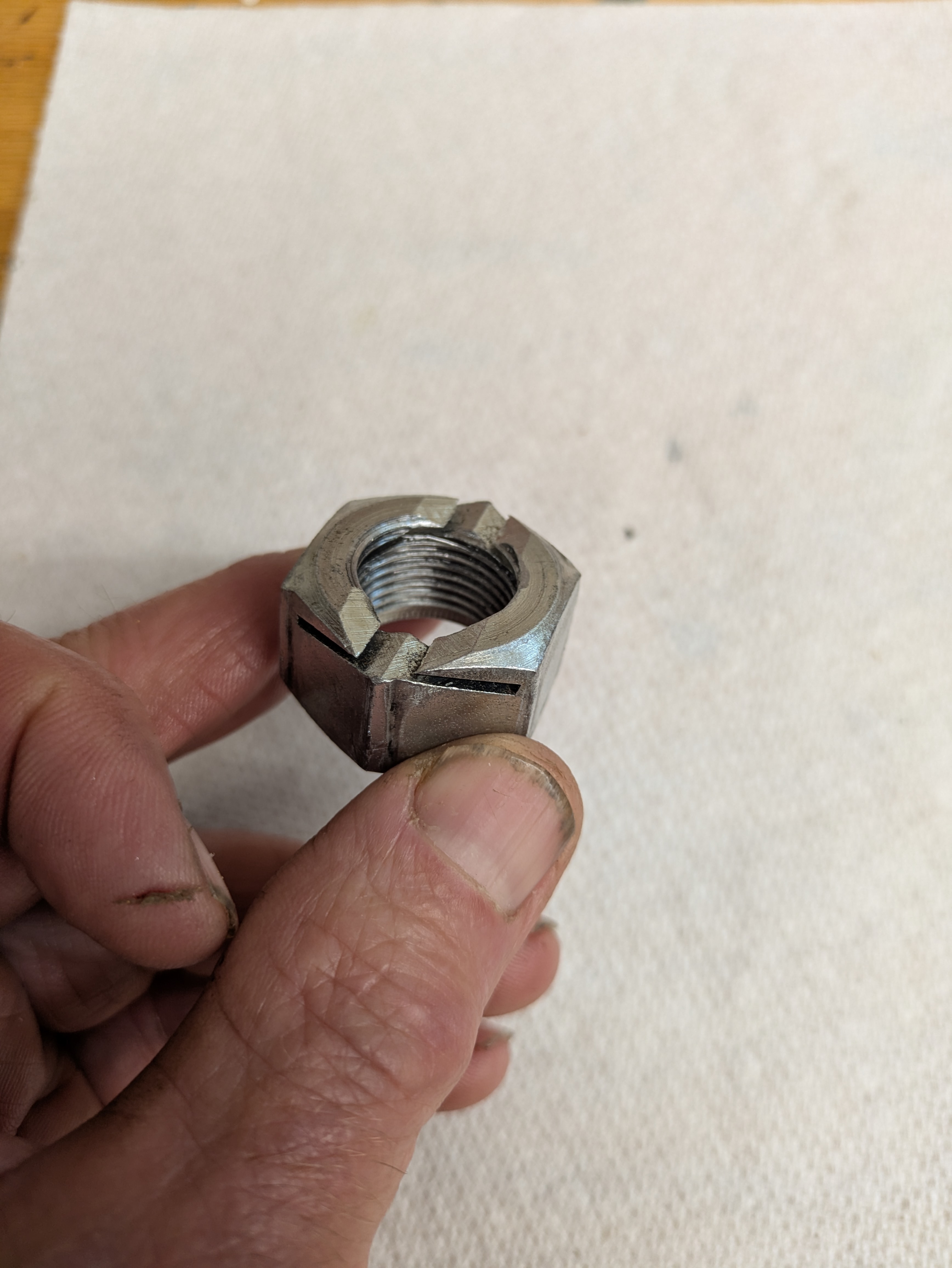

Here's the nut now that I took it off. Those slots closed up about .005" after I took it off, so it's some kind of lock nut although I still don't see how it works. Maybe they bent those wings slightly after they cut the slot to make it bind up on the thread. It was so hard to get off I used a 6' cheater bar, I thought sure the threads were galled. I can't imagine a more expensive way to make a lock nut.
