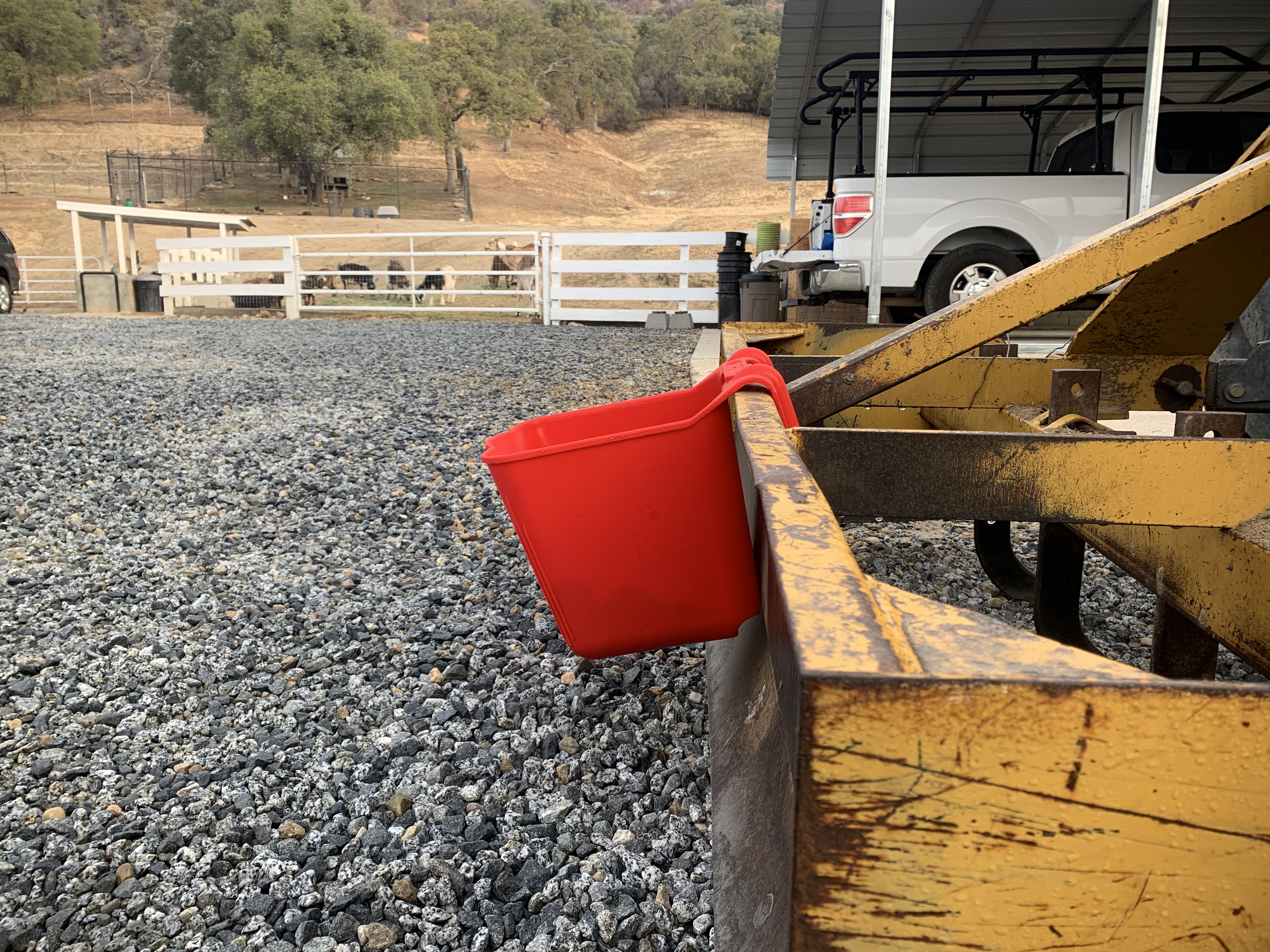

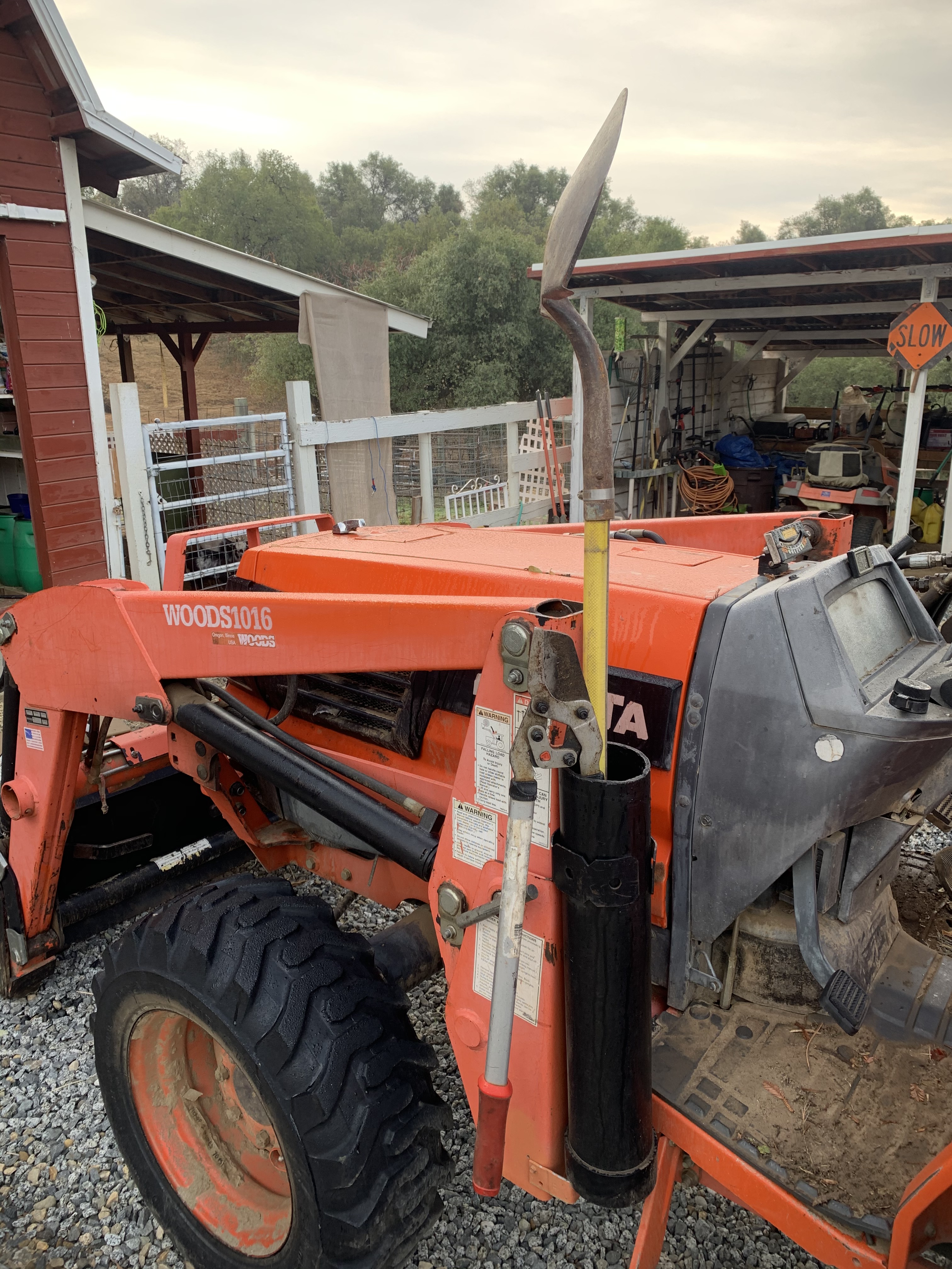

I frequently deal with the issue of how to carry my chains conveniently, and I have dumped and lost chains I had forgotten were in the FEL. I previously built (based on a design from someone else on this forum) a vertical 6" ABS pipe which works, but I find I use that holder for shovels, pruners and other things.

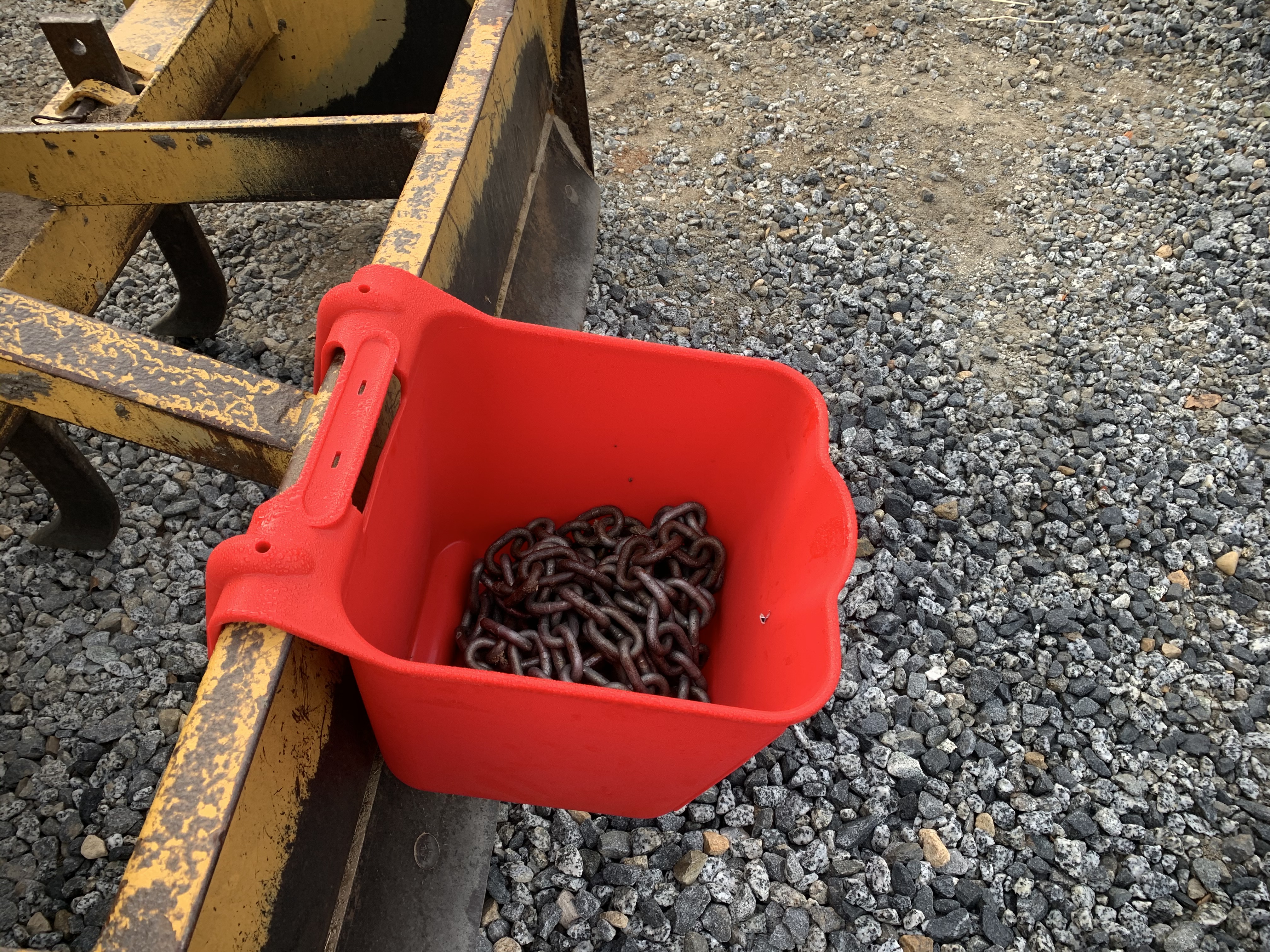

Anyway, now, as long as I have my box blade on the tractor, I have a solution. It is not a total solution and won't work for everyone in all situations or at all times but it works for me most of the time. And an added feature is that you don't have to carry, or drag the chain to where you need it - you can simply lift the 'chain carrier' off the tractor and carry it to where you need it - much easier than wrestling with a heavy chain. $13 at TSC. Looks to be durable. Color a bit bright but may be other choices.
There may be other places on some tractors where this could be hung. Pics of the ABS pipe solution and the new chain-carrier (aka feed bucket). The chain in the bucket is a 20' logging chain.

I ran across the large diameter plastic pipe thread years ago on here and it is a winner for me. I mounted it on the right side of my L4400 loader frame, below the loader handle. I keep a couple or three various chains in there. The hooks rest on the lip. It has been just handy as can be.

I have a pipe mounted vertically on my loader just like the one you are carrying the limb cutters in. Mine has a clean out with a screw in lid glued on top. Haven't lost a chain yet.

Could always weld couple J hooks on box blade for the chain,hope you dill couple holes in bucket for drainage.
Actually, I don't leave the 'bucket' hanging there unless I am going to do something that requires a chain. Those particular 'buckets' provide a nice handle so can I can lift off, carry away and put on easily. Holes in the bucket are a good idea though.

Safely carrying chain and tools on tractor attachments are used everyday. Good idea with the feed buckets.

Beowulf: What did you use to attach the 6" PVC pipe to your loader upright?

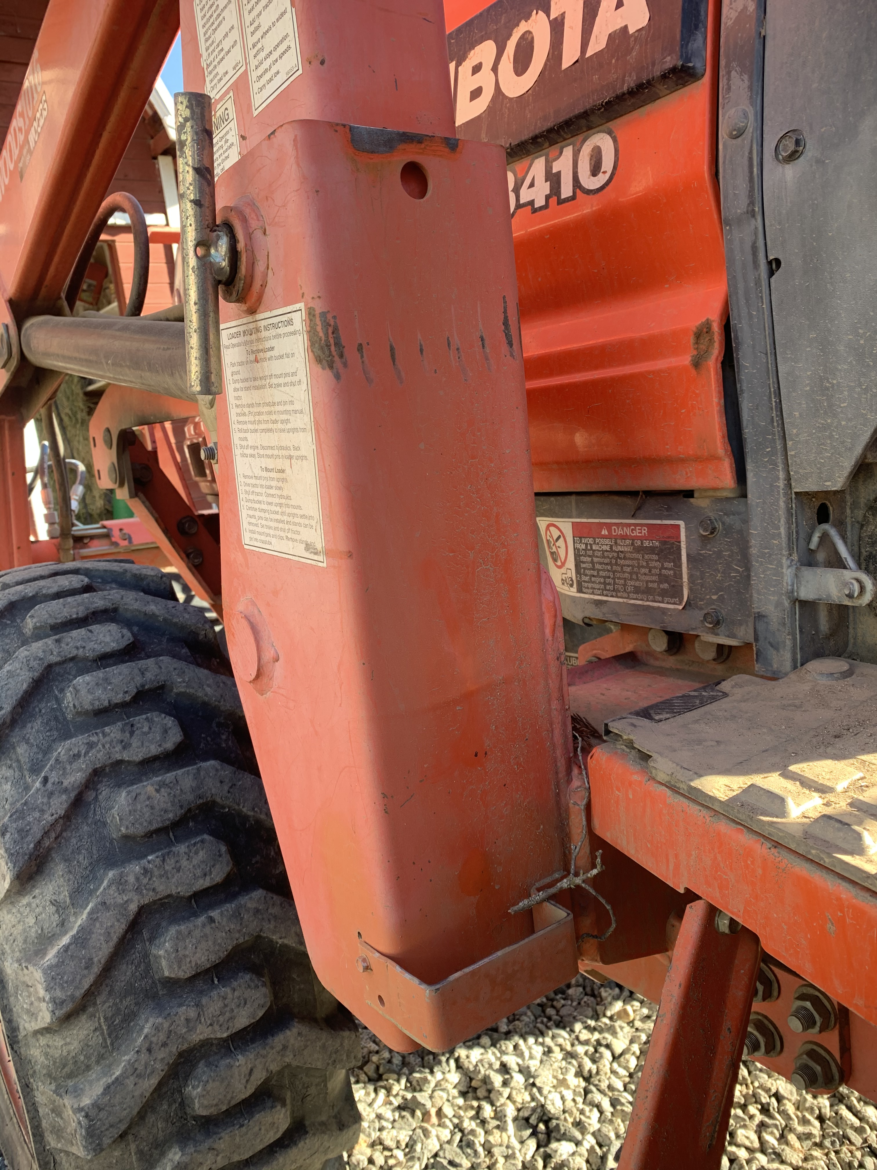

Actually, it was what I had here already. I will try to attach the Home Depot links to the items I used - or to similar items. To hold the top of the ABS pipe against the loader upright I used an ornamental black T bracket, the horizontal T part was shaped around the ABS pipe. The vertical part of the T slipped nicely into the gap in the loader upright. For the bottom support I used a 2x4 stake holder (or something similar) bent/shaped in a vice to fit my needs and attached it with some self tapping screws into drilled holes. Simple but works fine and lifts off as necessary.
https://www.homedepot.com/p/OWT-Orn...ERCH=REC-_-searchViewed-_-NA-_-206842595-_-N&
https://www.homedepot.com/p/Everbilt-2-in-x-4-in-Zinc-Plated-Stake-Holder-31230/205386640
Some pics of the holder pieces separately below. Earlier photo shows it installed on the tractor.
