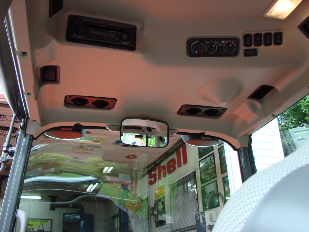

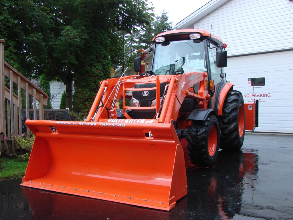

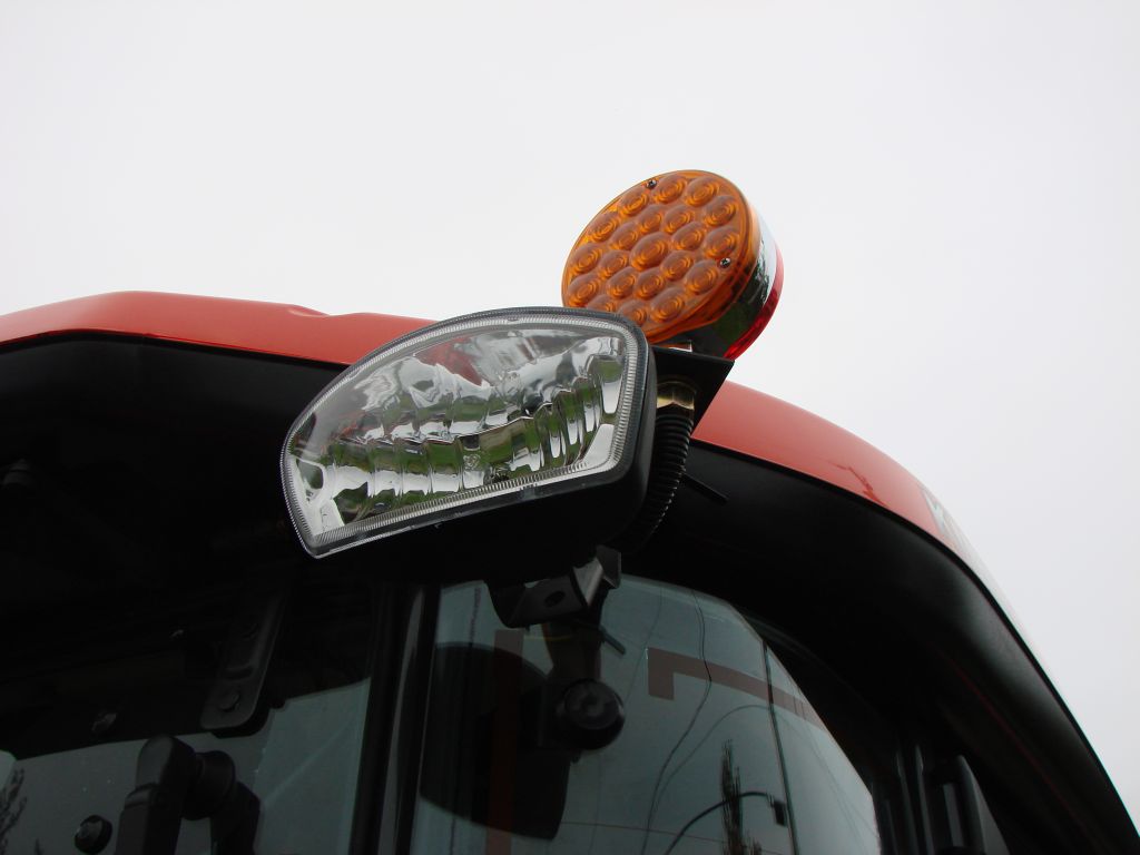

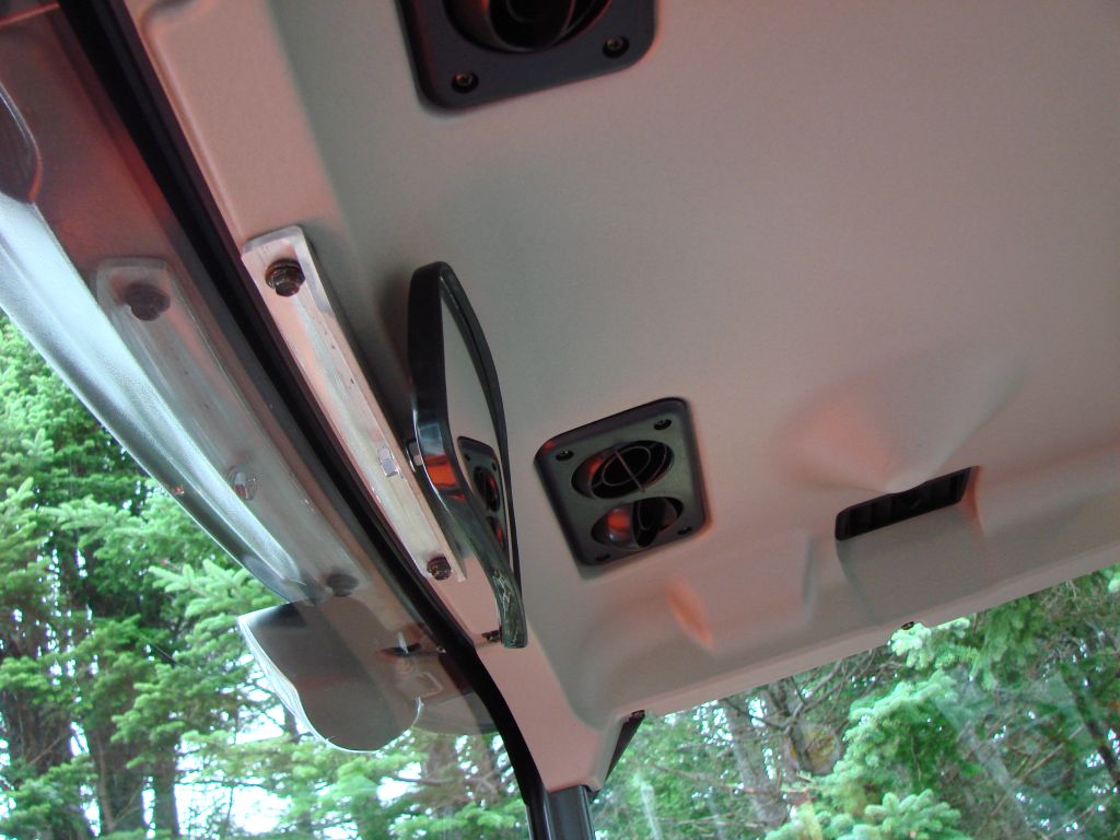

Well I received an email from a fellow member asking to see the in-cab mirror I planted in the beast last night so I'll attach a picture of that along with a few hooks I mounted on the bucket.
I also removed the ugly rear round top cab lights and replaced them with ugly round LED lights.:D
The mirror was just a convex mirror I got at the local auto parts shack and I used a 12 inch piece of 1 inch aluminum angle to mount it. I used the existing bolts that was in the cab. I didn't want to modify the cab for a mirror.
I mounted it dead center because if I mounted it to the left or right it might have an effect on the defrost vents in the winter and I didn't want that happening.
The mirror gives a great view to the rear but I do see myself in it so I just start singing that old song "Oh lord it's hard to be humble" ;):D

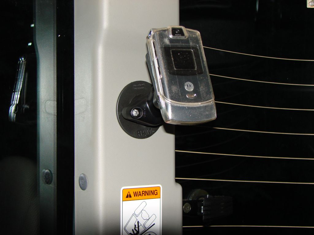

Just installed another cool item. It's a cell phone mount made by Ram mounts. A magnet comes with the mound and sticks to your cell phone.
The mount itself has 3-M adhesive on the back so just clean up the area with rubbing alcohol and peal and stick. Works great.
I'll use my blue tooth with it but now that it's mounted I can see who's calling me at a glance like the bill collectors.:eek:
Cost of mount $20.
Usefulness: Priceless :p
Sorry about the photo. snapped in the dark! :(

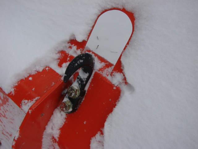

I am thinking that the first mod I will make is adding chain hooks to the bucket. I like the simplicity of how you bolted yours on (versus welding) and since I don't own a welder (yet) thought this might be a good way of getting started with my mods.
So . . . quick question for you. Will I be able to drill through the bucket steel with my standard corded Dewalt drill or will it take something more powerful / specialized to drill the holes. Did you just use a simple bolt/nut approach or did you actually tap the holes in the bucket to accept the bolts? Can you post a picture of the underside (inside the bucket?)
Thanks again for all you do to add to this site.
Thomas (aka Kubota Tee)
/ Simple add-on's for my L4240 #11
You should be able to, it will be easier than you think. Start out with a smaller bit and work your way up. It will be alot easier if you use some kind of cutting fluid also as you drill, just have a helper give a little squirt of it every now and then as you drill. I have used WD40 in the past as cutting fluid, you just have to be carefull as it is flameable. You can also buy cutting fluid at most farm stores.

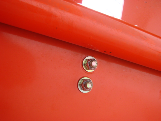

Hey Thomas welcome to the site and congratulations on the purchase of your new tractor. Your going to love that machine. Thanks for your kind words on my work. It was very much appreciated. I have to say that Dodge Man answered your question perfectly and I wouldn't have answered it any differently so go ahead and get to it.
You need hooks. Although I have made some modifications to my bucket and don't mind welding on it when it came to the hooks I just bolted them on. the most I'll be pulling on it is to pull a vehicle out of the snow which I have done just the other day and they work fine. the plating on the bucket is plenty strong in my opinion and don't need a backing plate. I just went out and snapped a few pics for you to see how I did mine. I used coated bolts and washers. I also used lock nuts and it worked out great. If you search my posts you'll see I enjoy working on my tractor almost as much as I do running it
Be sure to post pics of you new rig when you can. enjoy. Paul AKA 4shorts

Thanks for your reply and the extra pics showing the inside of your bucket. I will definitely post some pics once I get the new tractor delivered. I am hoping it comes the week between Christmas and New Years. I have been researching all your mods and I will certainly be using some of your ideas in the months ahead. Keep up the good work and keep the posts and ideas coming.

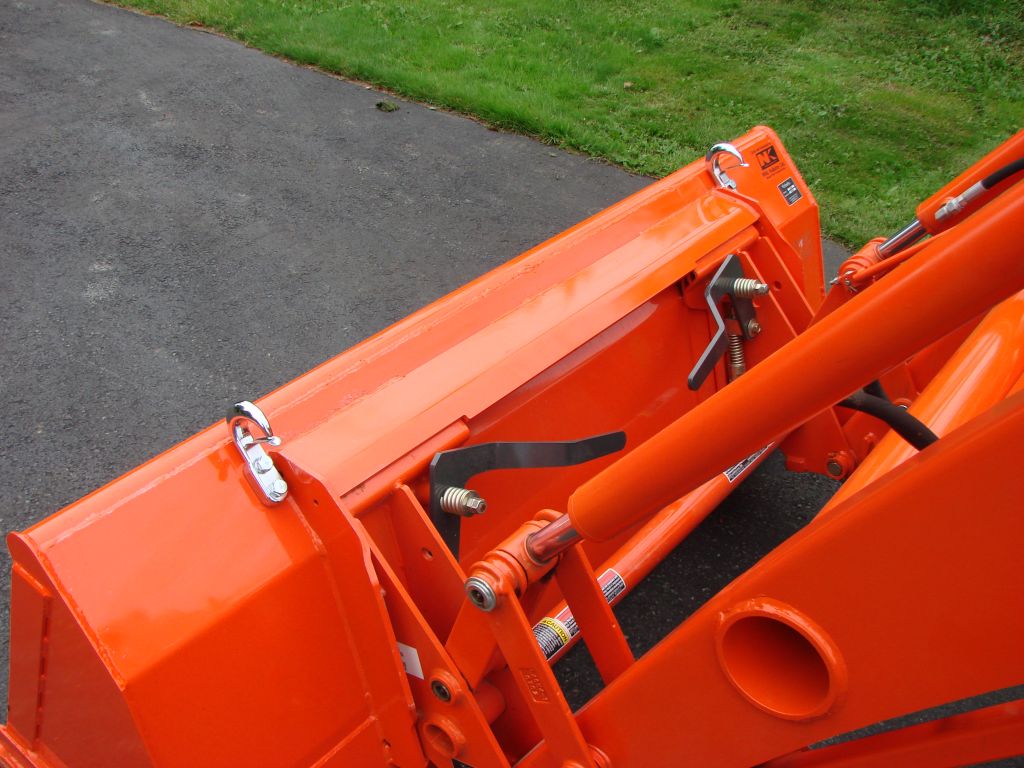

My tractor arrived this week and I took the time today to add the bucket hooks - similar to yours. Thanks for the idea and encouragement to just go for it. I have to admit, I was a little nervous drilling holes into a brand new bucket. I used cutting oil and stepped up 4 different sizes of drill bits. Could not have gone any smoother.

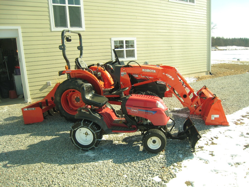

Thanks for the reminder! We had a nice sunny day on Saturday so I snapped a few pics of my two tractors. Been using the Toro to plow snow off the ice of our lake. The ice is close to 10" thick now, but I still don't trust it enough to bring the new Kubota onto the ice. The Toro does a nice job and is better than using a shovel.
It's a beauty, You must enjoy seeing that by your door :cool: The little Toto is nice as well. Makes the Bota look like it had a kid :cool: Thanks for posting the pics.

quick ques. where did you buy the hooks-looked at lowes, home depot and tractor supply-these look almost like tow hooks on the front of my pickup
I found the hooks at the local Tractor Supply. They were in the automotive section and I had to have them order in a 2nd one as they said they only ever keep 1 in inventory. I do think they are the same as the ones use on SUV's. My Suburban has 2 very similar hooks mounted to the frame at the front.
