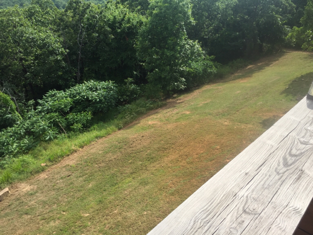

This is about 20°
Some of these slopes hit 45°, which is my max going up and down.

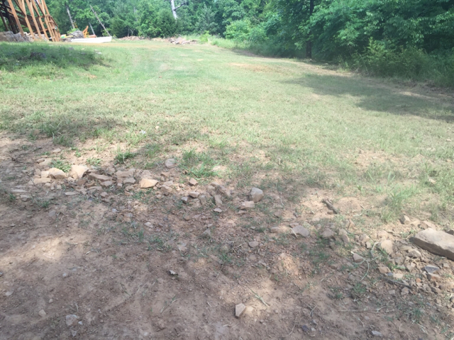

Mowed it today. After taking FEL off and slowly traversing it, tractor never felt "tippy". At the worst part it seemed the tractor may want have a slight tendency to slide rather than tip.
I'm watching for some weights that I can add underneath the center eventually. Thanks for all the information. It's nice to actually know it can be done.
