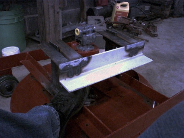

I am thinking that if I only want a small offset (say six inches) that I could make plates with some holes in them. Then I could unbolt the "U" support bracket assembly from the deck and use the two plates to bolt between the deck and the "U" support bracket. I think this would give me 80% of what I want. It would also help mow under over hanging branches. Easy to make and do. Easy to undo.

Sorry moss I haven稚 been on here for a while. The mower does fine. And the size hyd motor was just right. My deck was a 28" you might go slightly larger if yours is bigger.
