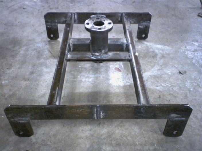

That is some kind of tractor wheel weight with a piece of railroad iron inside. I'm not sure what it weighs but it seemed to be enough.
/ Side Mower
#83
Thanks Moss. Here is a pic of the mower and counter wieght folded for tighter storage.

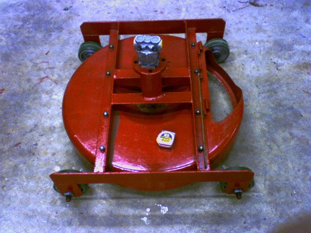

Here is one way of cleaning under the side mower deck
/ Side Mower #85
Just plain good design. You DA Man!!! /forums/images/graemlins/grin.gif
I like that cleaning method, too. /forums/images/graemlins/wink.gif
How much $ do you have wrapped up in the whole project? Just curious.
