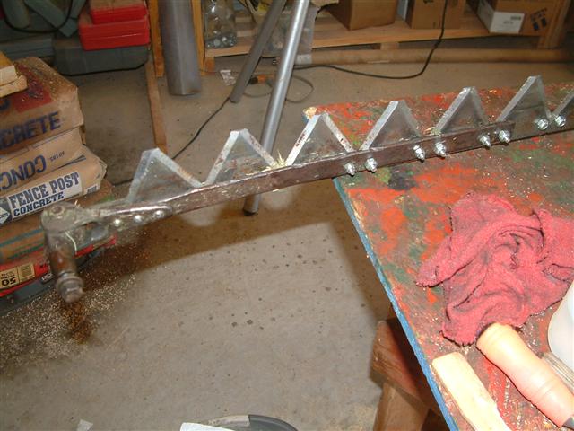

After I ran the sickle mower for an hour or so I checked the sections and one had worked its way loose.
I used a 3/4" ratchet extension standing on my concrete pad as a tiny anvil that could tuck in behind the rivet so I could whack on it some more. Guess that would be another advantage for bolts... easier to replace just one or two sections without taking everything apart.

Bolts allow you to replace sections without removing the sickle bar. I always put a small amt of #638 Loctite on the bottom back portion of the sickle section where it is clamped to the bar, and also on the bottom surface of each nut [not the threads]. Loctite offers very good strength in shear. Between the clamping and the broad surface bond the sickles never move.

Well, the price of the complete knife/section/cutterbar is now $205 dollars for an overserrated 36 section 9 foot assembly. Still not ridiculous considering the time it can save you if all your sections are worn/rusted out. PS, I have the heavy duty "C-clamp" rivet remover/installer tool and it works pretty good if you keep it greased and use a good 1/2" impact driver air tool to work it. Grinding off the head of the rivets and punching them out is just as easy, so I mainly use the installer end of the tool.
