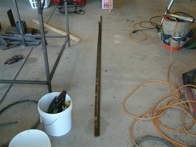

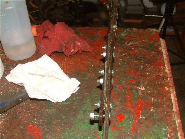

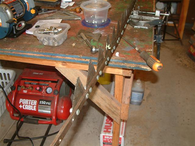

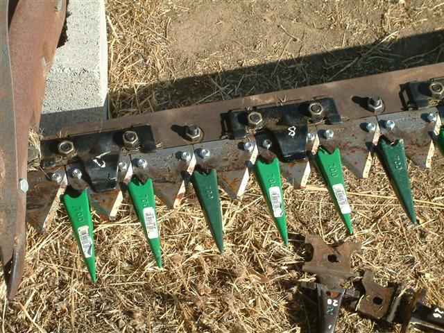

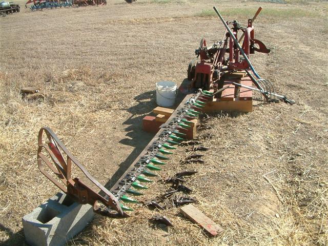

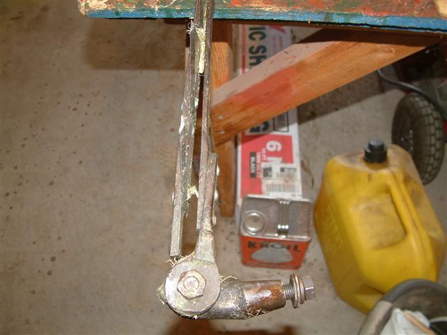

I replaced the rivets on my old 7-ft MF31 sicklebar with nuts and bolts.
First I had to replace the steel bar that carries the sections (and drill about 60 holes) since the original bar was bent and twisted
Nuts and bolts installed
Hope this helps.
Good luck.

flusher
Your third pic shows extra length on the bolts used to hold the sections, whereas the last pic shows the bolts flush with the nuts (that appear to be lock nuts). Did you change bolts along the way?
Looks like you replaced a number of parts, and have a good rebuilt mower now.
/ Sickle Bar Section Rivets vs Bolts #11

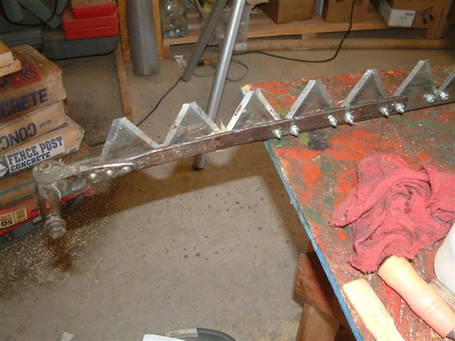

flusher
The short bolts are used to hold most of the outboard sickle sections.
The long bolts hold the cutter bar and the inboard sections to the gizmo that connects the bar to the mower drive unit. Here are a couple of closeup shots

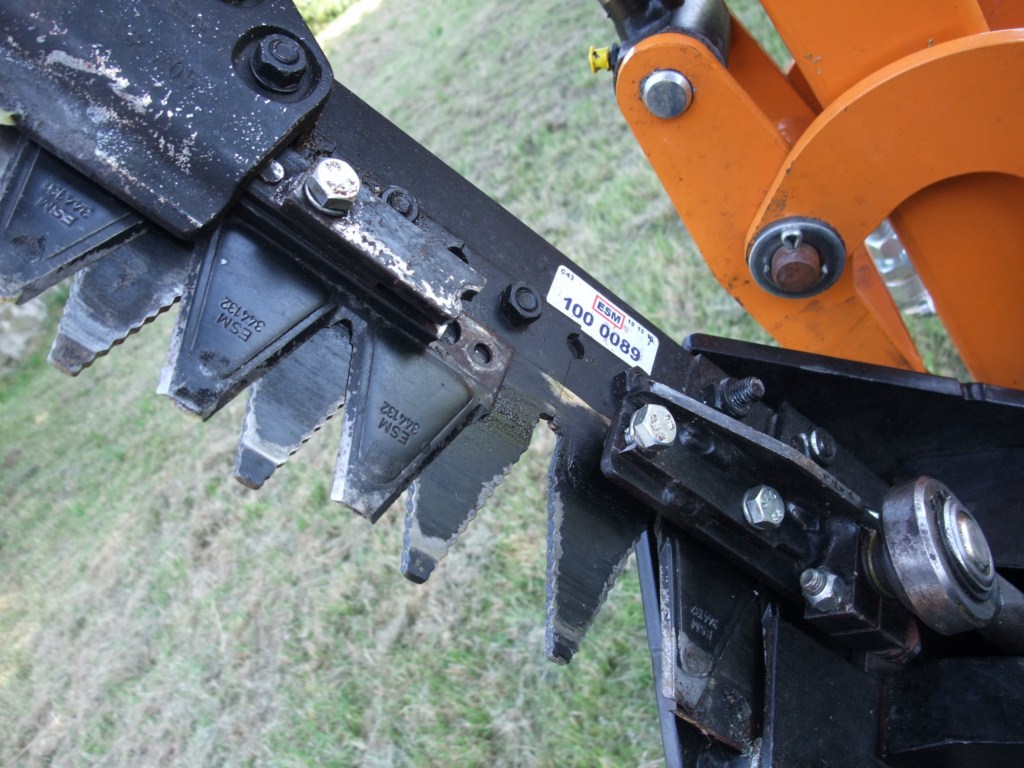

My sickle bar uses both rivets and bolts. The rivets are for the part that slides under guide plates. I include 2 pictures of the time when the new sickle bar broke because these guide plates had been made too tight at the JD dealer's (they replaced the complete assembly in a matter of days). There doesn't seem to be much trouble with the bolts catching grass or branches.
