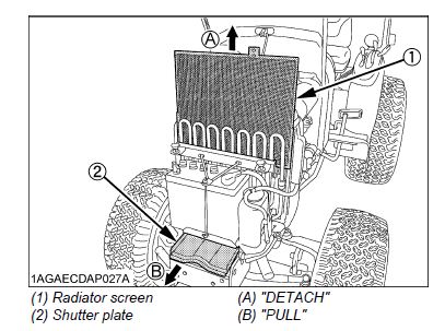

on my 2012 Kubota B2620 under the battery is a "shutter plate".
This is what the Kubota manual calls it.
Any idea what its for or what it is supposed to do?
Thanks

I am thinking it has something to do with keeping exhaust heat away from bottom of battery. (rad overflow protects the side)
   / Shutter plate #3
My guess is it's to be sure the intake air flows through the screen.
   / Shutter plate #4
I think it is to direct the airflow through the rad screen so it doesn't suck unfiltered air into the radiator.
   / Shutter plate #5
When cleaning area in front of radiator( ie..hosing off), pull the shutter forward and it allows debri to fall clear.
   / Shutter plate #6
boakley - The shutter plate on my 2003 B7500 collects a lot of debris that would otherwise find its way to the radiator fins. I pull the shutter plate and remove the debris when I clean the front grille, radiator screen and radiator fins. The debris collects on the underside of the shutter plate.
