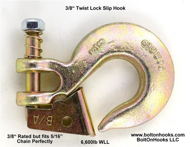

Try what sixdogs says. I get mine at a logging supply store. There are a couple near by. Labonville also has some cheaper ones.
Choker Hooks
5/16" Choker Chain Hook
There is also BaileysOnLine you can google.
Shipping to CAN is probably high though. I run 5/16 choker chain and have a couple of the 5/16 ones and have not broken them.
Slip hooks are tough to use. You might have a little better luck if you use a double wrap like this - place the hook at 9:00 o'clock on the log with the hook point facing up and away from the direction you are going to pull. Wrap the chain up over the top, and around the other side. Come up just forward of the hook and keeping the chain tight cross over the first wrap just above the hook. Now make your second wrap behind the first and come up thru the hook when you come around. Now let the remaining chain hang down to the ground so you have a 180 degree turn of chain around the hook. That might help it stay while you walk away and start your pull. I rig chokers that way too on very light logs where the chain wants to just slip off because there isn't enough log weight to make the chain bite in.
gg
Thanks GG. I priced them out and its $6.95 ea x 3 plus shipping its Just shy of $60 US plus customs????

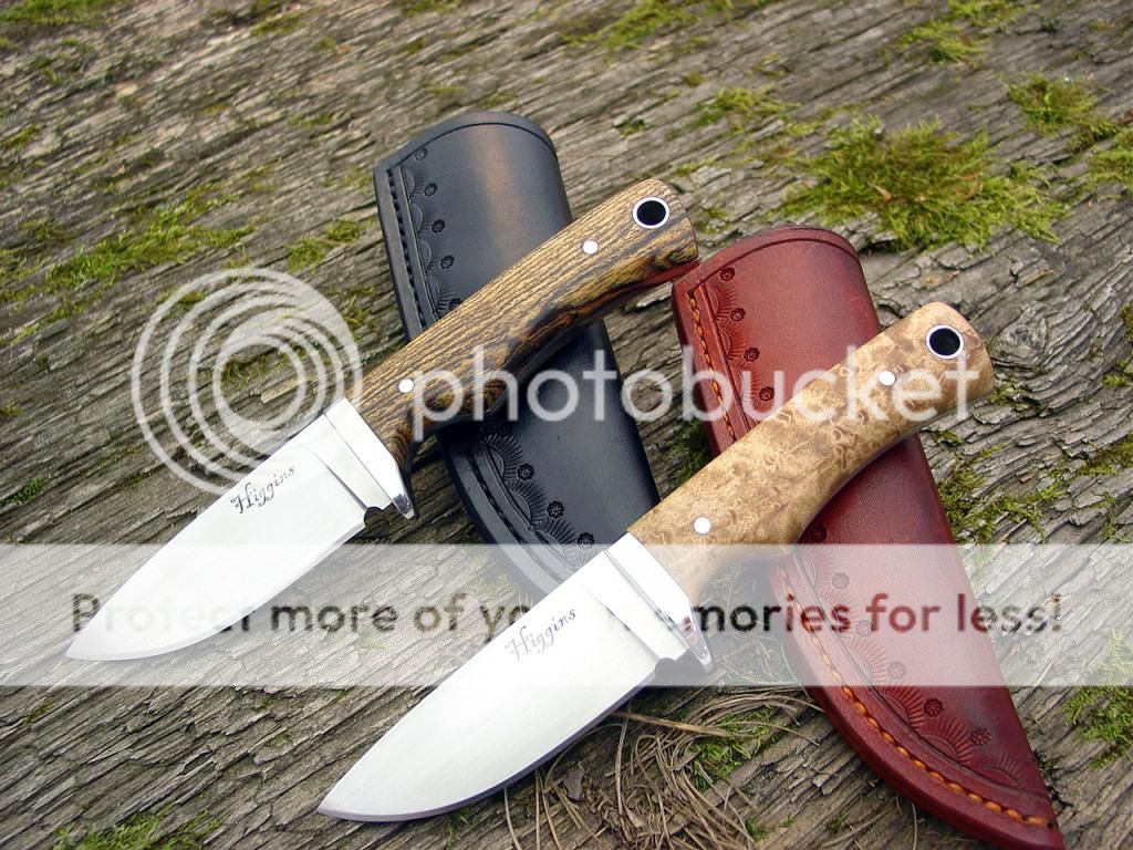

New guy here. I've made a lot of stuff over the years. I used to be a custom knifemaker. I'm a life-long machinist and mechanic.

I used to build tap-holders that hold taps from 6-32 to 0-80. A very solid rig. You can cut a perfect 0-80 thread in titanium like butter. I sold as many of these as I could make for $75 each to other knifemakers.

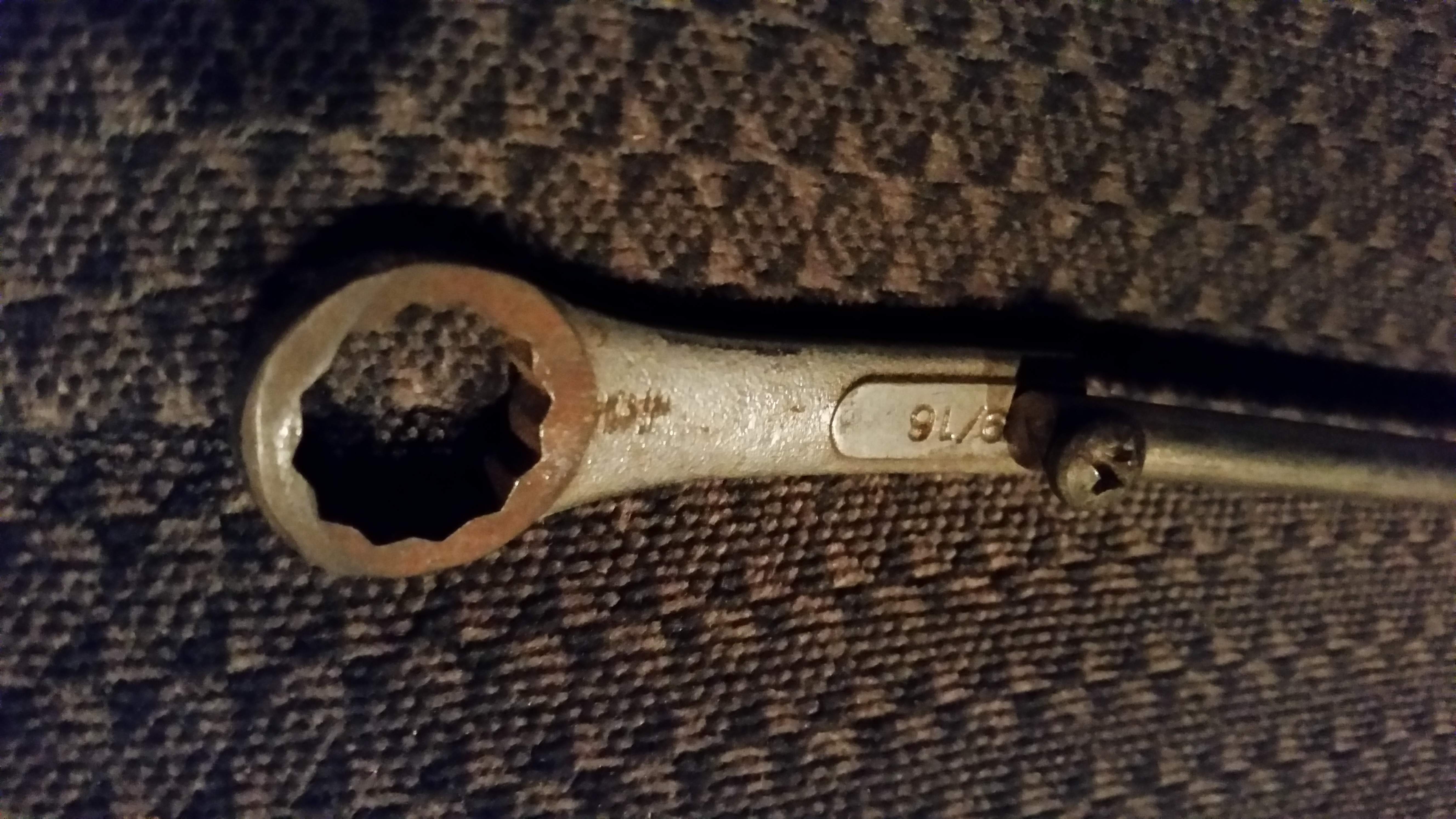

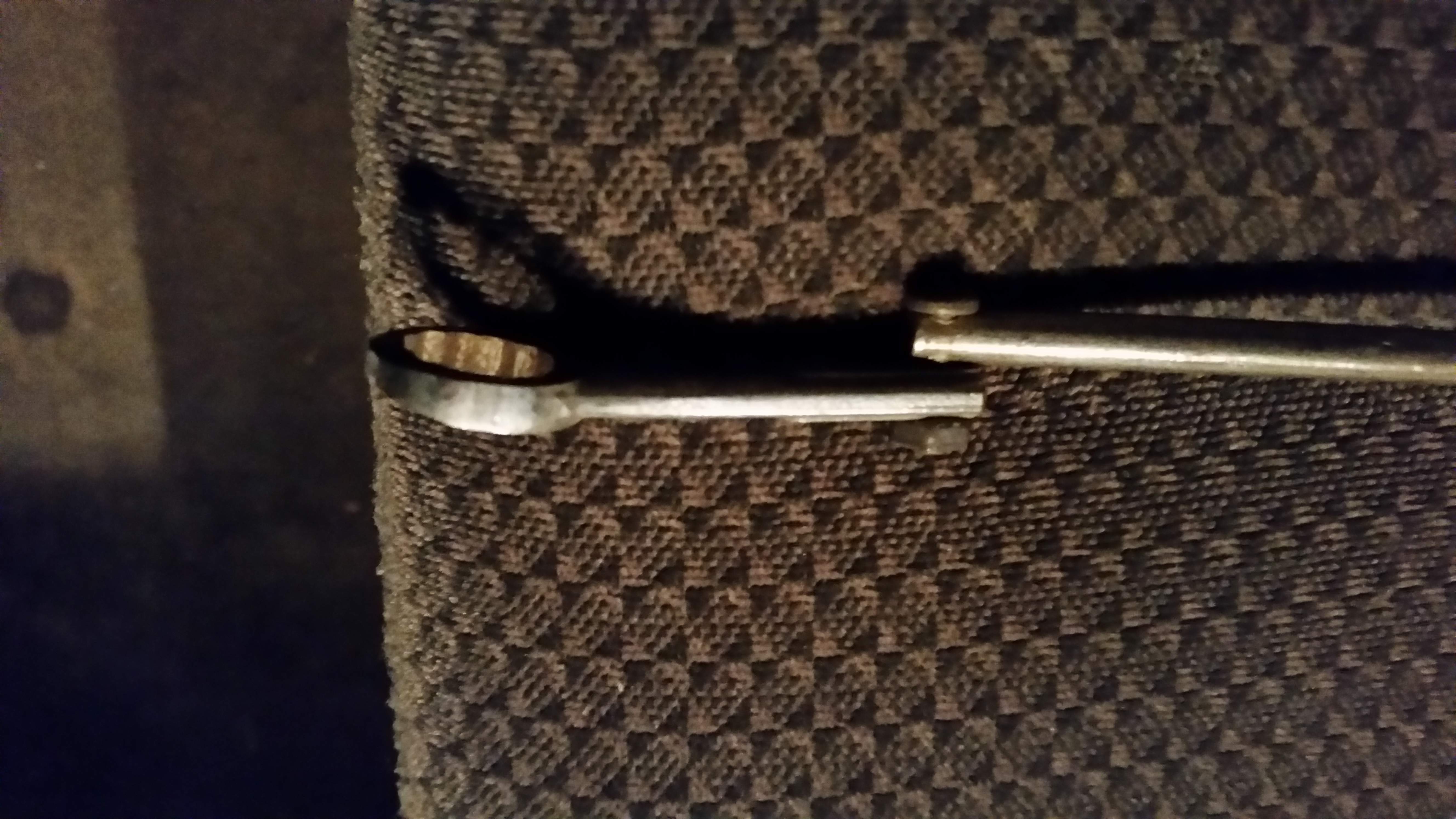

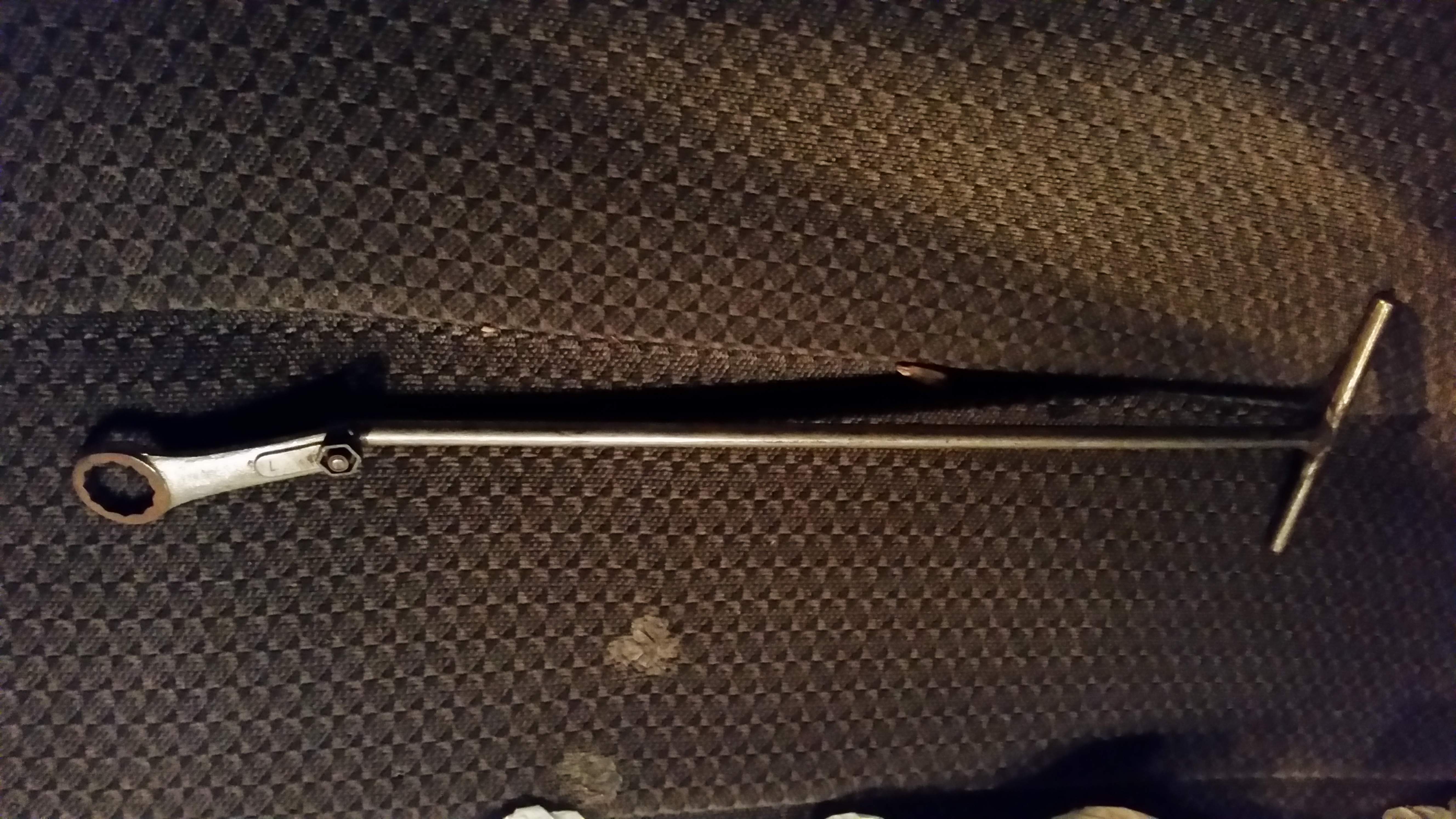

We used to do a lot of work on 727 freighters and did a lot of engine changes and swaps on the weekends. I made this tool to reach the nuts holding the hydraulic pump on the engine. It's a cut and ground down Craftsman 9/16ths box end of a combo wrench. I brazed the rod to make the "T". This tool is kinda used like a Racoon reaching around a corner, blindly. We could see the nut, just couldn't reach it with a half moon box end or even a socket. 727 Hydraulic Pump Wrench.jpg727 Hydraulic Pump Wrench Close Up.jpg727 Hydraulic Pump Wrench Side View.jpg

We used to do a lot of work on 727 freighters and did a lot of engine changes and swaps on the weekends. I made this tool to reach the nuts holding the hydraulic pump on the engine. It's a cut and ground down Craftsman 9/16ths box end of a combo wrench. I brazed the rod to make the "T". This tool is kinda used like a Racoon reaching around a corner, blindly. We could see the nut, just couldn't reach it with a half moon box end or even a socket.View attachment 416107View attachment 416106View attachment 416105

Thanks! You can buy these now with a box ratchet on the end. They are not cheap.
