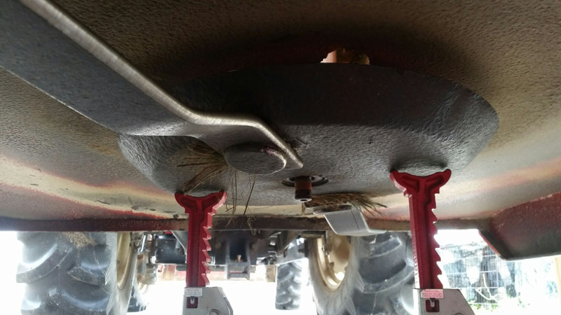

I just noticed the stump jumper on the brush hog is loose. I can move it up and down a little on the spindle. The Castle nut was still secured with a cotter pin, so this may have been the way I got the brush hog originally (got it used). I removed the nut to check if the spindle bolt shows signs of wear from the thing being loose, it does not.
[edit to add]: Actually, until I drop the jumper down I won't see where any wear would be. Going to take it off the spindle later today.

I don't know for sure, but on both of my rotary cutters, the stump jumper is secured pretty tightly. One is only about two years old, the other is many, many years old. I would think that if I was able to move around or up and down, it'd rub the threads off the shaft
/ Should stump jumper be loose? #3
The stump jumper should not move at all. If it moves, it means the castle nut is loose. Perhaps someone removed it long ago and didn't properly reseat it onto the tapered spindle. I would first try to tighten the castle nut to see if it will snug the stump jumper down, if not, then nothing left to do by try to remove it and inspect for damage.
I had to repair my B-I-L's 4 footer once when the stump jumper appeared loose but was actually a broken weld on the spindle hub. The stump jumper is bolted to the spindle hub where a T section of thick flat bar is welded to the actual spindle hub. His was completely broken loose from the hub and only held on by the stump jumper.
So if your castle nut is tight, you need to remove the nut, remove the stump jumper and inspect for damage. Keep us posted on what you find.

I got the stump jumper off, and the spindle looks fine, no damage. I reassembled and tightened the castle nut down, and it will, in fact, secure the stump jumper. But the nut goes up above the cotter pin hole, so what I think happened is that the castle nut backed down to the cotter pin. Why they would put a cotter pin in below the castle nut...? Maybe they just didn't tightnen it down all the way to begin with.
I'll need to add a shim to get the castle tight tightened at a location where the cotter pin actually secures the nut. There are a couple shims on it already, I have a piece of 5/16" plate, might try cutting a washer out of that. Get to play with...er...ah...I mean use the plasma cutter. :D

If you look at the rust pitted, saucer shaped object in post #1 of this thread, you'll see a stump jumper. As the name implys, they hopefully allow a rotary cutter to ride over stumps rather than break something that you don't want broken.

That rust pitted saucer is a mechanism to allow the blades to be mounted so they can swing back and absorb the force if they hit something stationary, like a stump. Unlike a centrally mounted blade that has no way of absorbing the force. The name, stump jumper, may be misleading. It doesn't jump over anything.
Having said that, I wasn't sure if these things were mounted loose to allow even more movement of the blades in the event something is hit.

The bevel on the edge of the disc helps it ride up over a stump. Jumping is a whole 'nother concept.

My guess is it had a washer, at some point the washer was not put on, either at the factory or previous owner.
