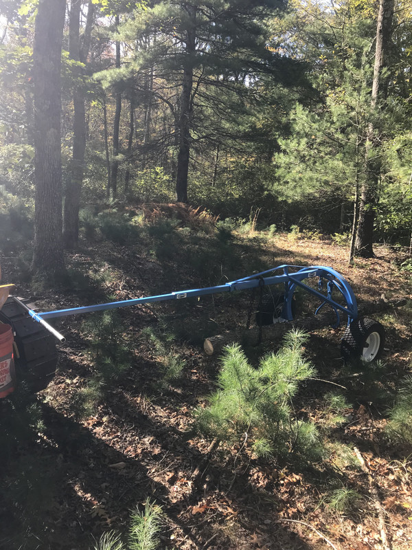

I think in one of your posts you said you're moving logs 1/2 mile? To me that calls for a better log handing system than dragging them the whole way. I don't drag logs farther than I have to. It gets the log all dirty which is hard on the saw, and it's hard on my dirt roads.
I'd look into an alternate, like a log arch that lifts the logs entirely. If you're cutting to 8' you won't need a really long one. Or a log trailer. Then take the money you'd spend on a new tractor and buy a grapple and rear ballast, or a forestry winch, or both. The winch is useful for logs that you can't drive up to with the grapple. Then use the grapple or winch to pull logs out to a landing where you can load them on the trailer or log arch for transport.
Or come up with your own system, that's just some ideas.
OTOH there's nothing wrong with buying a new tractor. The new Bransons have some cool features like a 4 speed synchromesh range transmission and the ability to command a regen if it ever needs it (that was a problem for a few people in cold area, mine doesn't have that and hasn't needed it). Bransons are heavy and have a lot of loader capacity which is useful for grappling logs.
