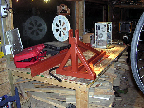

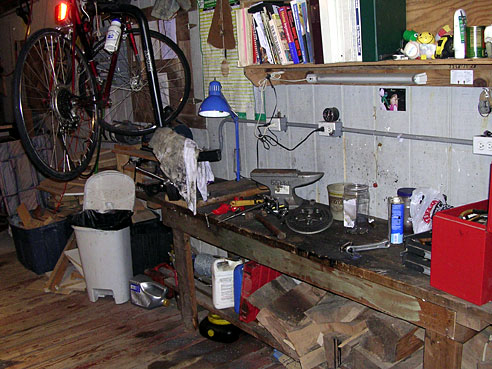

Picture is always better, right? My dirty table and assembly table.
/ Shop Ideas #56
What's that ATX tower doing in the background? Are we looking at the first 3-point implement powered by Windows? ;)
