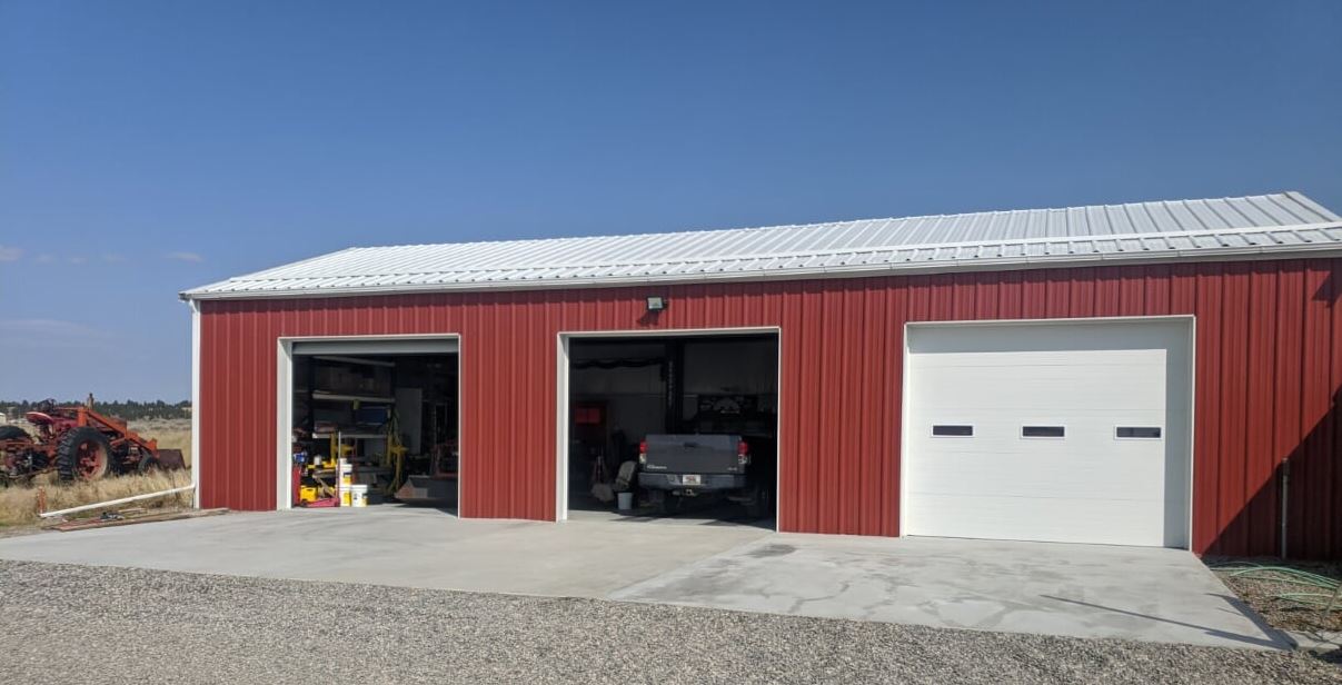

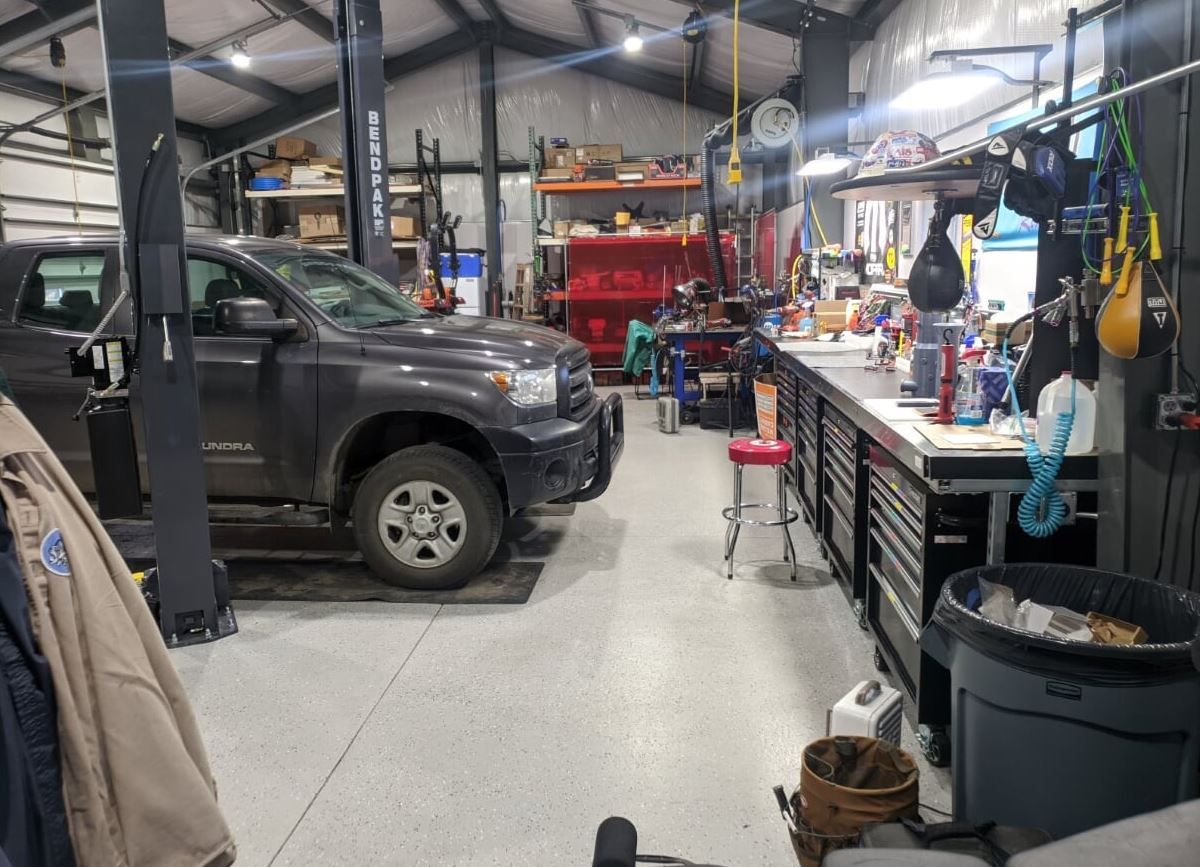

My Mr Heater Big Max is going on its 2nd winter running on LP in a 30X60 steel building.
I really like this heater and it is great on fuel. Bought mine for $400 two years ago, comes with a LP conversion and thermostat. I am running it off a micro smart TS now and what's nice is I can fire up the heater with my phone 20 mins before I go out to the shop if it is really cold.
MHU8 Big Maxx Natural Gas Unit Heater | Mr. Heater
I also run 2 - 1500W milk house heaters 24-7, if it does not get sub zero it never drops below 50F.
   / Shop Heater #18

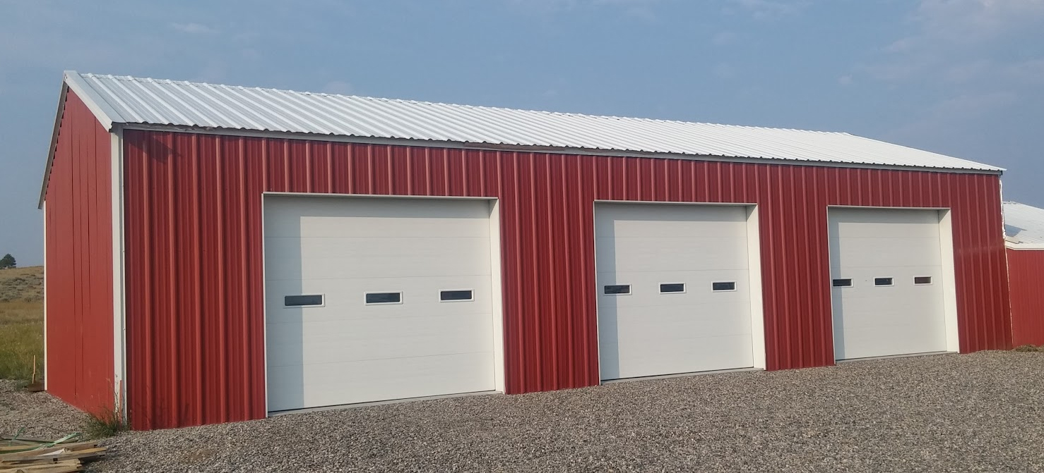

How tall is your steel building and how much insulation do you have?
   / Shop Heater #19
16'-9" at the peak, 13' walls, R19 roof and walls.
It was 8F here last night and the shop got down to 51 with the two milkhouse heaters this morning. Cranked up the Mr heater and it was 62 in about 10-15mins.
