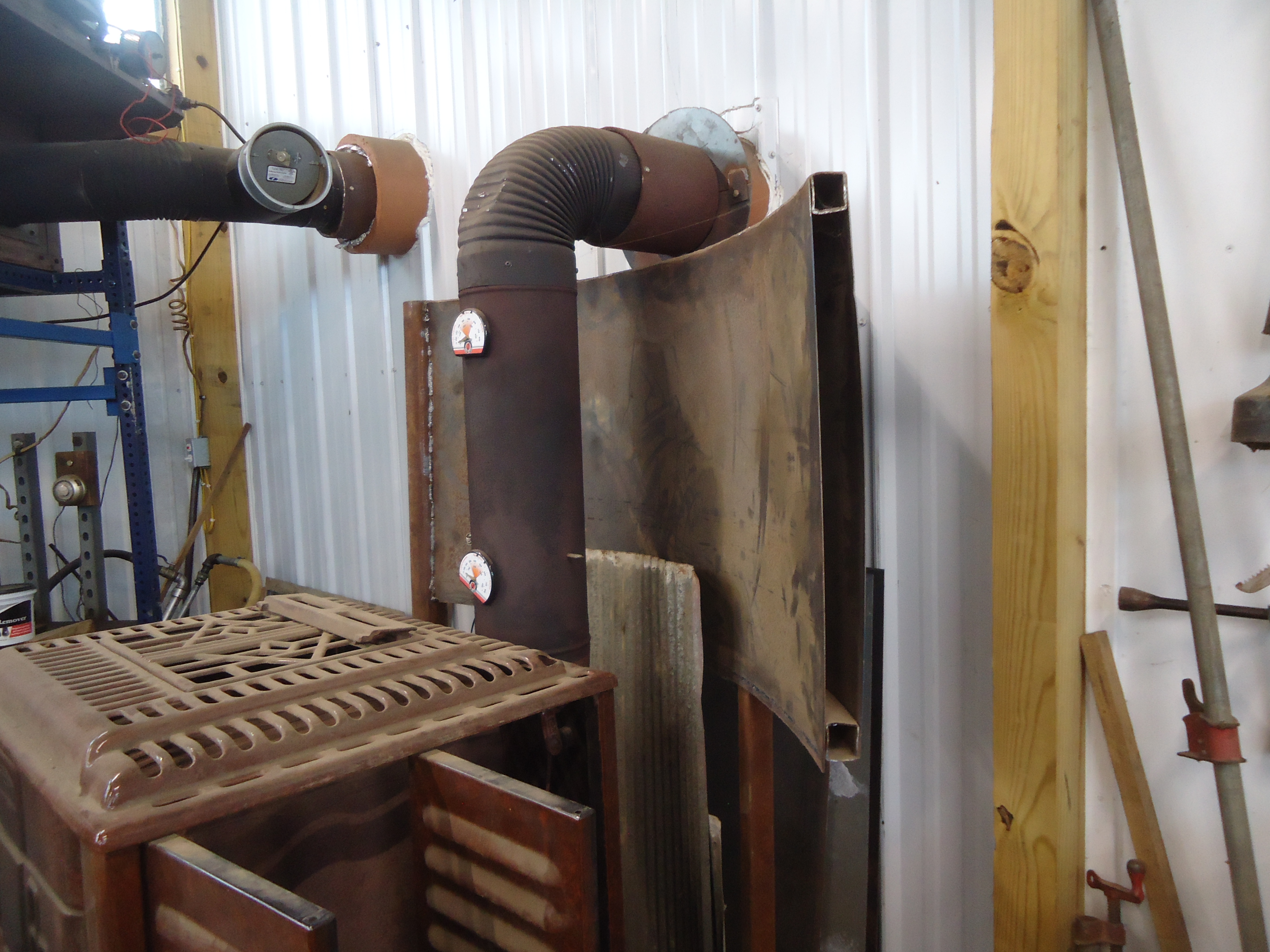

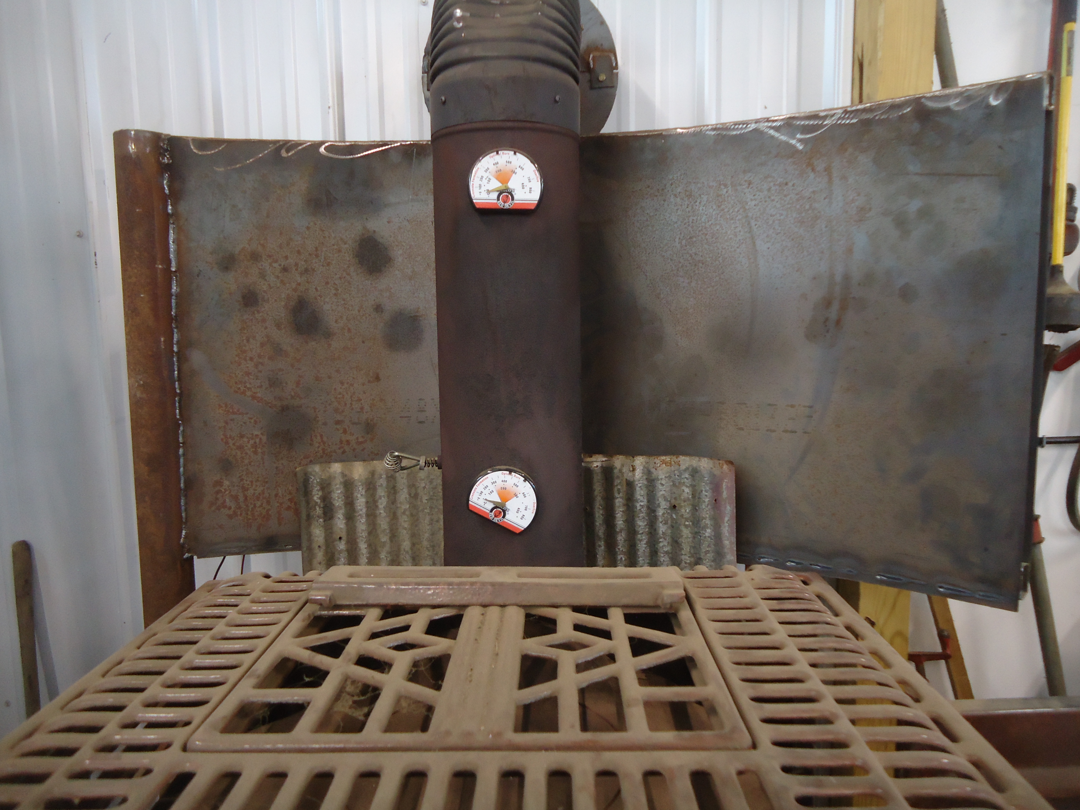

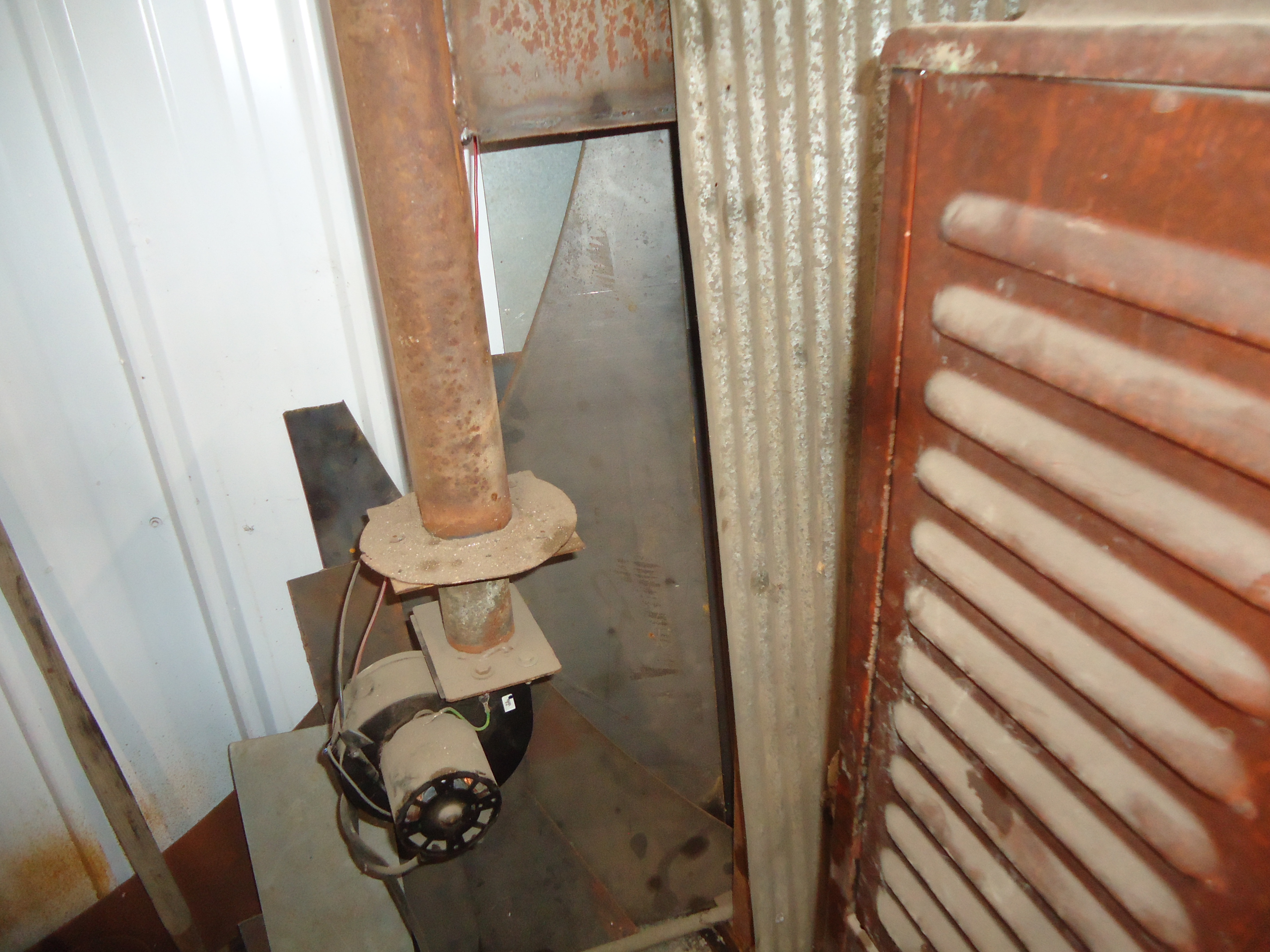

Instead of one of the heat robbers on the flue pipe, and needing a heat shield of some sorts to protect a post in the shop, I came up with this. A heat shield/scavenger combo. All made from some scrap pieces I had laying around, except the 140 cfm blower I already had, and still use on my forge, and, an adjustable temp. snap switch, to make it pretty well automatic on & off, eliminating a thermostat. I have the snap switch set @ 90コ. It will turn on when the backside of the shield gets to 90コ, and will shut off, when it gets down to 70コ.
Like in the past week, where temps were pretty frigid, and I kept it fired pretty good, it'd kick on every 5 minutes or so, when the upper flue temps stayed around 300コ - 325コ. That's the magic number it needs to keep a good draft, if there is little wind.
It could use a larger blower, but just using what I have. I just wanted to scavenge what heat that was there, and blow out across the shop, yet not stir up dust.

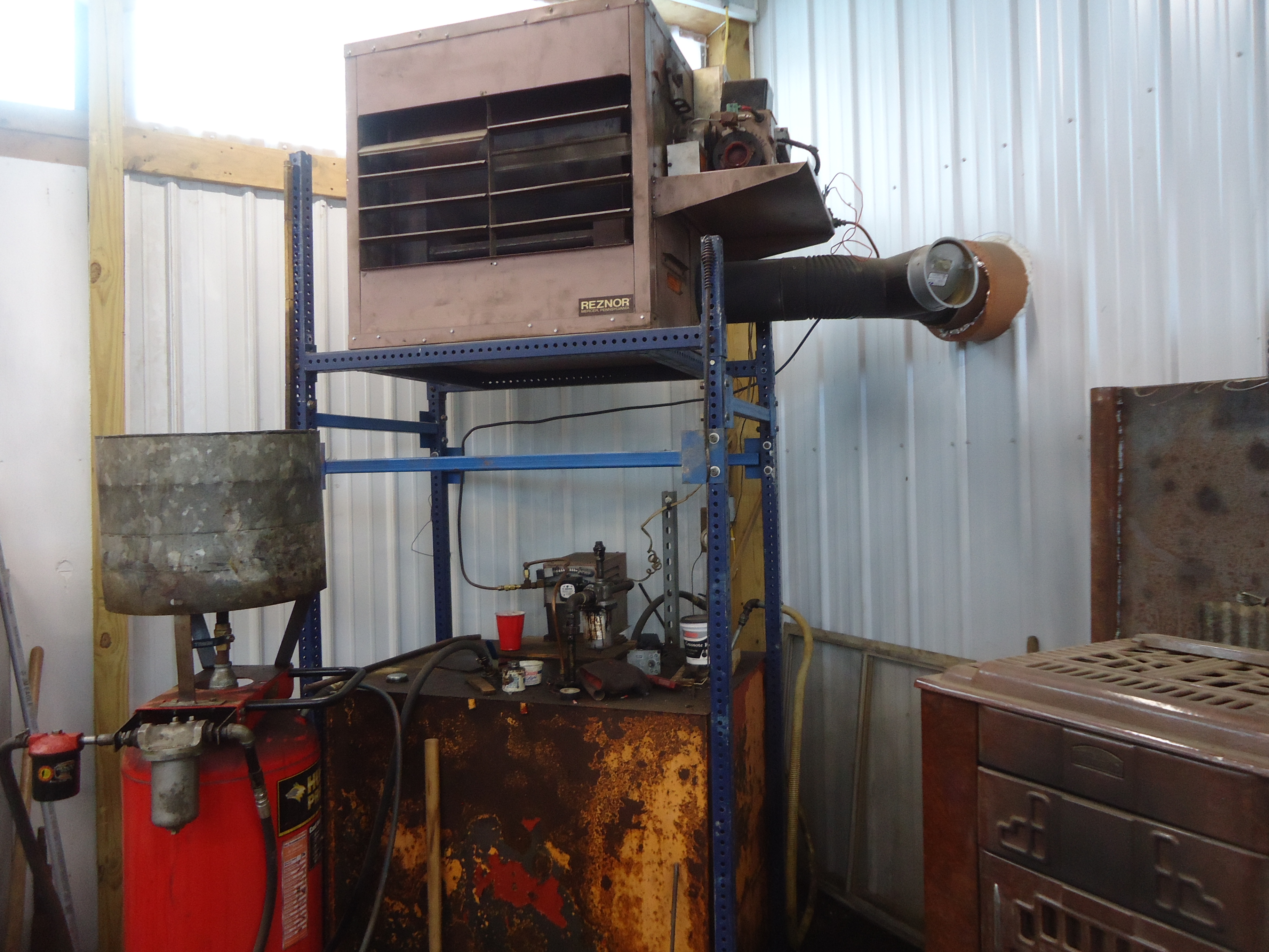

The last pic is the whole shop heat setup. The trusty ole' Reznor RA-110, 110,000 waste oil burner, vintage 1974. My oil refiner, made from a NOS upright air compressor tank, with two separate filters. First one contains a 200 mesh convoluted filter, to catch the solids, and the second, a standard HHO filter. to catch the non-desirable liquid types, like the Thompson's Water Seal a buddy left in one of the cans of oil he gave me last year, and gave me fits for 1-1/2 months last winter. Not the prettiest, but it ought to be between 54コ, and 64コ when I go to the shop here in a bit. I'll jack the thermostat up to a more comfortable work temp., and fire up the coal stove to hold it there the rest of the day.
