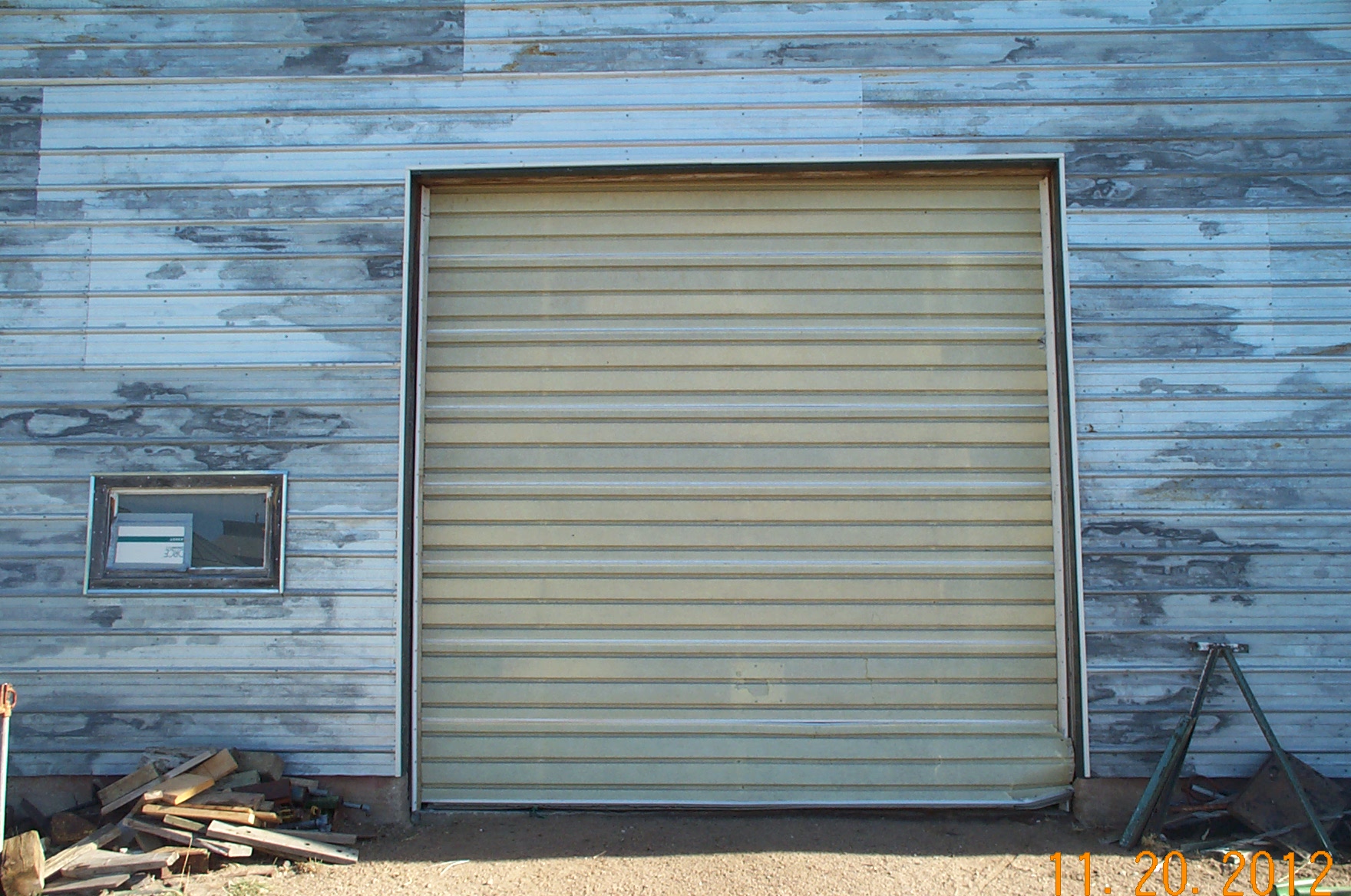

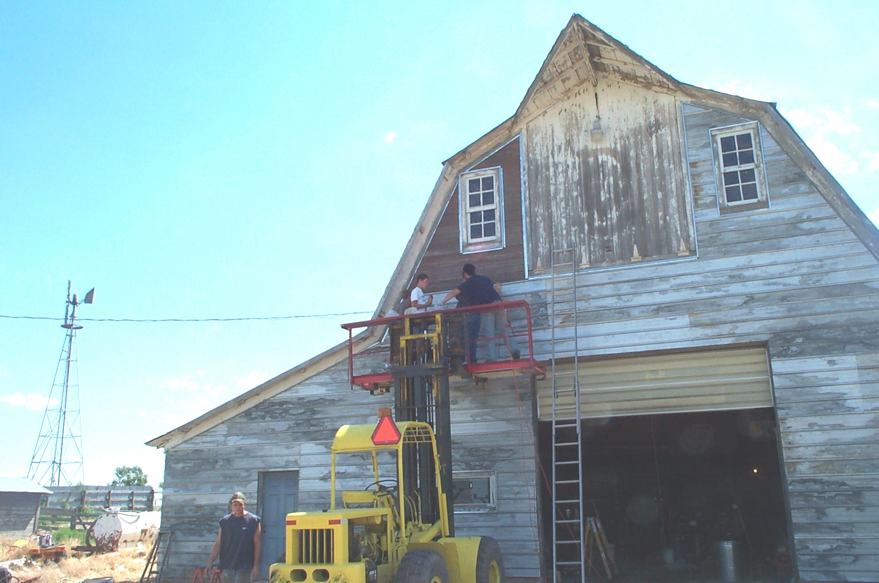

I have a old fiberglass roll up shop door, I bought it used for 35 dollars when I made the old barn into a shop, it was wore then and now nearly 20 years later it is really wore out and I had a goat that got in the shop and the door was up about a foot and he exited and took out the bottom panel,
I have a high delectable on the insurance on the building and the insurance would cover less than 50% of the doors cost, the prices I have got so far are $1800 to $2400,
was thinking maybe I could build some thing much cheaper,
my son was talking about a new shop door his boss just put in on there shop it is a one piece hydraulic lift, hanger type door,
I have seen some bi fold doors as well,
My door is 13 x13 rough size, I do not like the idea or the weight of a 13 x13 foot panel stuck out in the wind, like on the hydraulic doors, the bi fold door has some appeal as I could put a walk in door in the unit and some windows that would let in light and could see out of, I realize that a bi fold or hydraulic lift could cost more than a slider it would be power lift,
any other Ideas?
I am not really fond of sliders they could work, as there is room,
the pictures are not the best but gives on some idea of what I am trying to put a door on, (the walk in door does not enter the shop area, it goes in to a side room and then it enters about 20 feet in,
the tin was used take off that has set for some time, the price was right, and hope to paint it some time soon,

I think a standard roll-up door is going to be your best bet. Whether you can build replacement panels is known only to you based on your skills and tools, and the condition of the existing tracks, springs, etc.
Another type of roll-up door doesn't use panels; but is corrugated and rolls into a drum mounted above the header. These are generally used in industrial settings and have the advantage of saving ceiling space that could be used for electric lighting, and would allow you to have plenty of light and the door fully open on a hot summer's night.
/ shop door, needs replacement, #3
Your fiberglass door is an overhead not roll up. Roll ups roll into a drum as mentioned before. They have their place but I prefer an overhead.
The $1800-2400 quotes are reasonable for a QUALITY overhead door (installed) that size. Those prices may even be a tad low.
I'm curious how a single panel hydraulicly operated door compares price wise. I've only seen them used on much bigger openings where the other option is usually a slider.
I'm sure you could build something cheaper but it will likely be heavier and harder to operate, won't last as long, require more maintenance, and not look as good as even a cheap roll up or overhead door. It's easy to spend other people's money but I suggest buying a quality overhead door like a Raynor. You could save a few bucks by doing the installation yourself.

You already have all the hardware for an overhead door. Why don't you replace/build new panels using your old hardware?
#11
I may do that,
but nearly every thing is shot, all rollers need replacement, springs need replaced, panels (fiberglass is cracked in many panels), about three of the frames have bent, parts, the hinges are questionable, the pulleys are wore out, the cable is in need of replacement, about the only thing that is not bad may be the track,
approx 20 years ago I bought two doors that had been taken out of a local business, and bought them both for $35, I took the best door (panels) which was the wider of the two, height about the same, the best track, and best rollers and so on and assembled one door that worked but well used at that, even when I first installed it I had to cut some sections of fiberglass and patch over holes in the door I choose to use,
the simple is it is wore out, and not just a little wore out but really wore out, and needs replaced IMO, and I do not replace some thing just because it is not new, I usually end up working on it about every few weeks to keep it functional, (meaning to be able to open it up and shut it),
and for some reason I really do not see it logical to spend maybe 30% to 50% of a new door to fix a shot door, that when fixed still won't seal and will need replacing in a few years any way.
and the track is the 2" track for very light weight doors so if I made new panels the weight would most likely be much heavier, and then even with new rollers and parts and pieces, I am not even sure the track would be heavy enough to do the job, (I most likely can do one panel but not three or four,

what I have chosen to do, (the insurance company choose to decline my claim on the door) If the damage would have been done mechanically they would have covered it, but since it was an animal it was not covered, the animal was never supposed to be in the building in the first place but that did not matter,
any way I found another panel it is narrower but I will build out a set of ends and mount the shorter panel in the ends and replace the springs with a torsion spring system, no it will not be a new door but most likely a better working door for a few years, the cost quoted to me for the springs from a local door man, said under $200 for the torsion spring system, and on the Net just the replacement extension springs like I have would cost me $82 each or $164 plus shipping, so the torsion spring system sounds like to me the way to upgrade the door,
also, I will replace the rollers, and patch the other panels some.
and I hope to make the bottom panel into a break away panel, Patent US5584333 - Releasable panel for overhead door - Google Patents
or about mid way down the page,
Edwards Door Systems Limited - Strip Doors
If I would have had some thing like this in the first place would not have a problem,
I have an idea on a lock that would lock the bottom section solid when closed, by a moving rocking lock that works when the door and the latch hits the floor, by rocking into a slot on the panel,
and the panel held in place up either spring loaded, pins with rollers, Abbey Trading 081368 HD SPRING LOADED GATE WHEEL
or a hose type seal, in two channels or angle irons set at a 45 degree angle with some space between, with a soft hose that would seal and yet soft enough to allow it to slip out if hit.
or even just use a few plastic bolts or a few zip ties,
as the bottom panel would be secured by the rocking locks on the edges of the door when closed,
that is my current plan,
