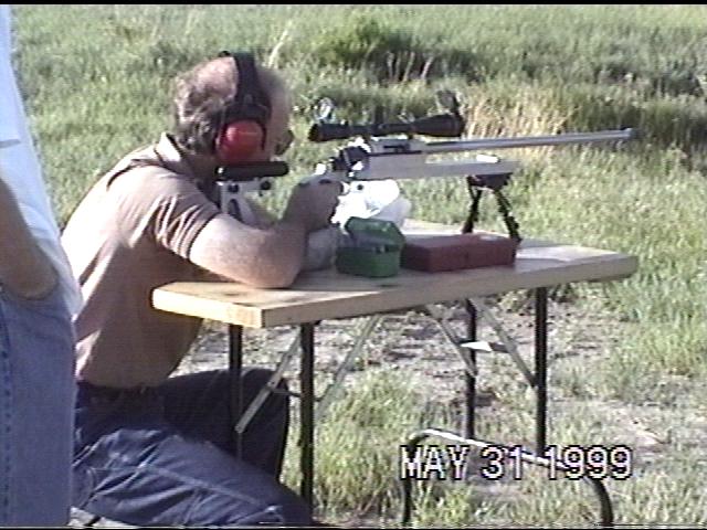

This is the one I built for prairie dog shooting. The top is a hollow core door and the legs are the ones you buy to make folding tables. I cut the rear leg down to a single to give you room to sit. It is light weight so I could carry it to different shooting points.
Kays_Supply,
I like your shooting table.
I might be thick headed, but I'm not sure exactly what you did in cutting the rear leg down to a single? In the picture, I can't tell. Seems like if you cut one of the upside down u shaped legs off, it would wobble. Got any more pics?
Thanks.
