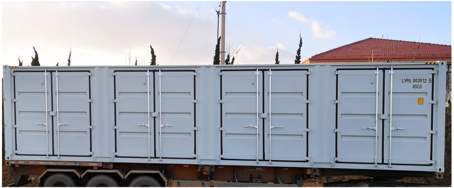

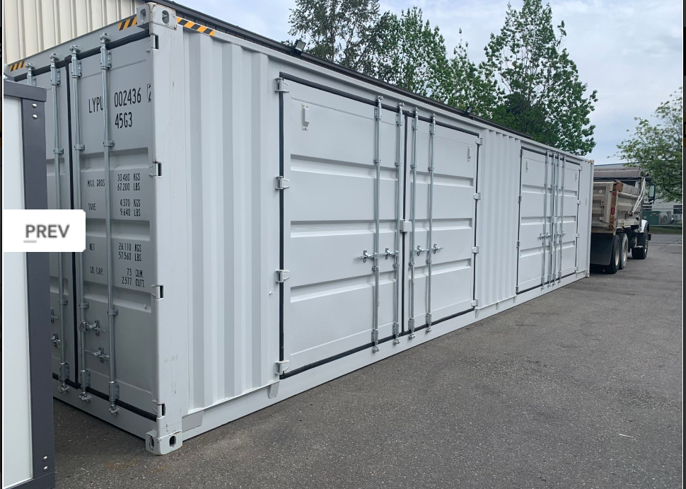

Here is one that is 40ft by 8ft. This unit has rear doors and then two sets of side doors. This is the kind of unit I am thinking about. I have seen a wide range of prices from new at 13K to used ones at just under 6K.
I just contacted a local place that sells shipping containers today. They actually have these side door units but do not have used ones. They are $12,500 new. In my opinion that is a whole lot of extra money for something with side doors. If you just bought the regular shipping containers I'm sure you could just buy some garage doors to fit, put a foundation under it, install a mini-split unit and all for less than buying a side door unit new or even used really. I have watched some videos and it looks like people are saying if you cut into the regular units to add something like a door you should reinforce that area as cutting a hole in it reduces the structural integrity of the unit.
