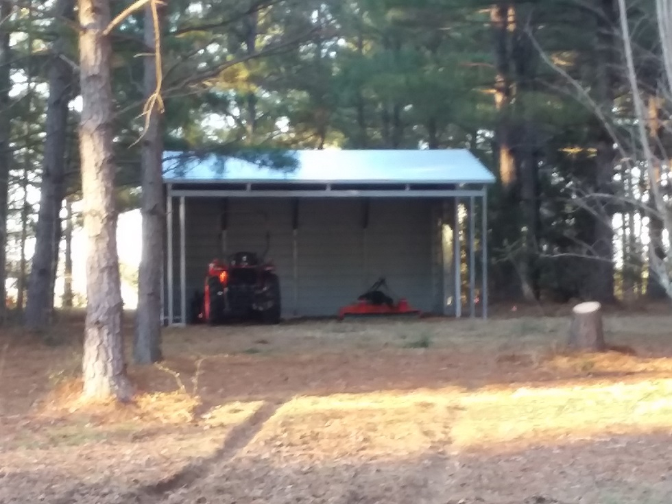

What about a carport for your implements?

If you just need a simple shelter, the carport idea is about the cheapest. What I use for implements is similar to what tradosaurus pictured except:
  • It has a shed roof - the front is higher than the back
    • this makes for cheaper construction by only building a flat sloping roof, sloping toward the back and giving a higher entrance opening
  • The bays are 10' x 20'
    • 10' wide seems to be enough for most cars, tractors and implements
    • 20' is deep enough for cars. It can be shallower if needed. (The typical parking lot space is ~10' x 20')
  • I shoot for 9' tall opening to clear the ROPS. Sloping to 7' in back.
  • You can build one or two 10'x20' bays and then add on over the years as budget allows or need occurs.
  • You don't have to put on sides, but having three sides enclosed really helps keep out the wind and rain.
  • Support posts can be 4x4's, but I like to use 6x6's on the front (because I'm not the most careful driver and often bump into those front supports when backing in).
    • Old utility poles also work well. Or cedar posts if you have lots of cedar trees and want to find a use for them!
  • For a 10'x20' bay, you can put in support posts on 10' centers. This gives a middle support post for the roof rafters.
  • Using 10' centers, roof rafters can be 10' - 2x6's if you don't have a big snow load to deal with. I put the rafters on 24" centers and then lay 2x4's across as purlins for a metal roof.
Hope all this makes sense. I would send a picture, but just moved to a new place and am planning to start building this design sometime in the summer.

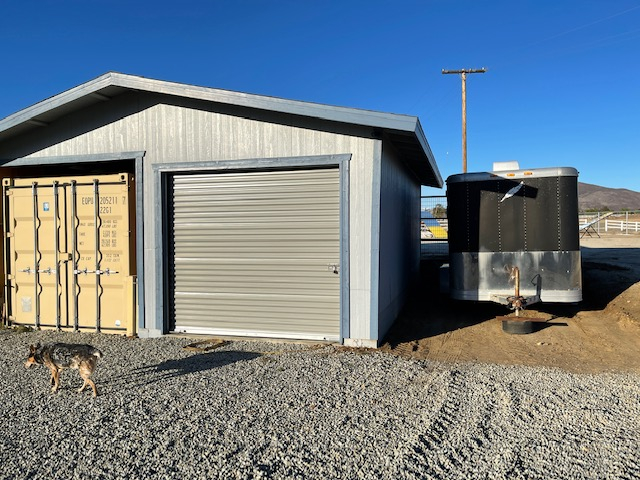

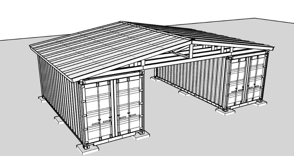

Containers have their benefits. I bought a one use container... looked new in and out. It is clean and dry, water tight, and secure. They do get really hot inside here when left exposed to the sun. So I started building a roof over it. The project grew and I ended up with this below. We store electronic inventory in it, it has industrial shelving on all sides in side. Very clean and secure. Neighbor has 2 spaced 12-16 ft apart with a flat roof over both and the tractor parked in the center.
You just posted exactly what I have been considering. Placing two far enough part, side by side and a roof over them. My biggest concern is definitely the heat and the condensation. I live in a area that gets very hot and humid in the Summer. I know equipment in enclosed trailers, especially dark ones, literally bake. I was talking to someone today about them that has access and can deliver them.
Another concern of mine, mostly that I just got is how they are going to look. I see people on YouTube using Harbor Freight paint systems to paint them which seems to really make them more palatable to look at. That is semi important to me. Again though my biggest concern is even if I plan a roof, I would probably still plan to ventilate them somehow. A couple fans maybe, like one intake and one exhaust on each.
So my question would be what did you neighbor use for base? Concrete all the way, gravel all the way, a mixture perhaps?
