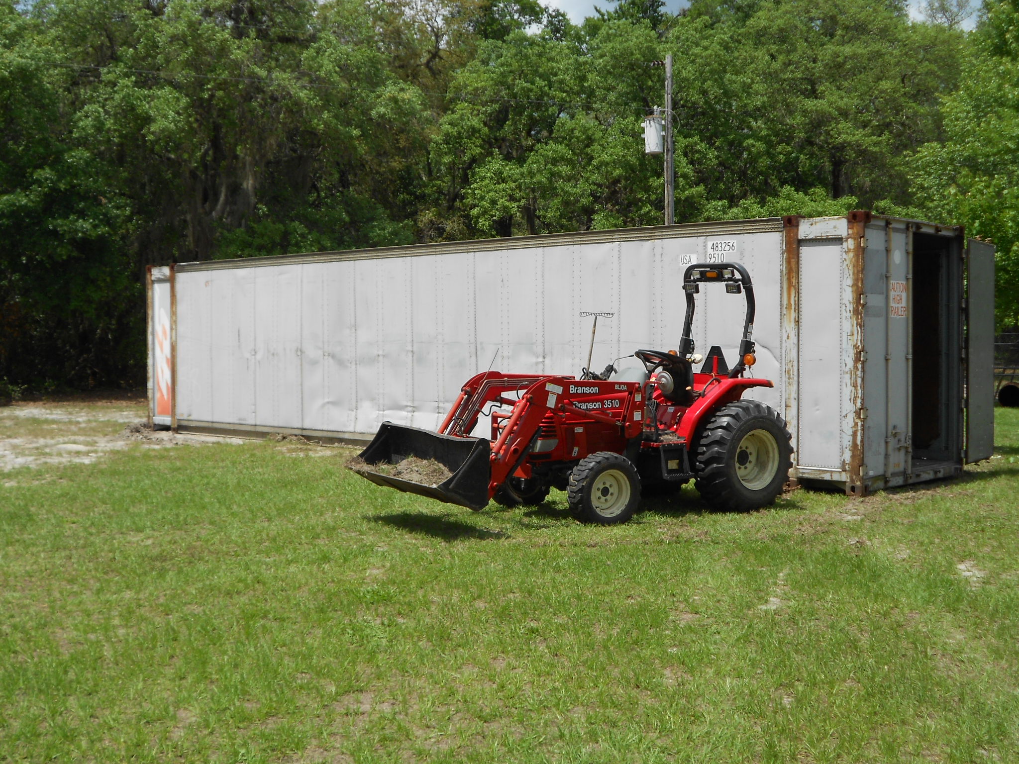

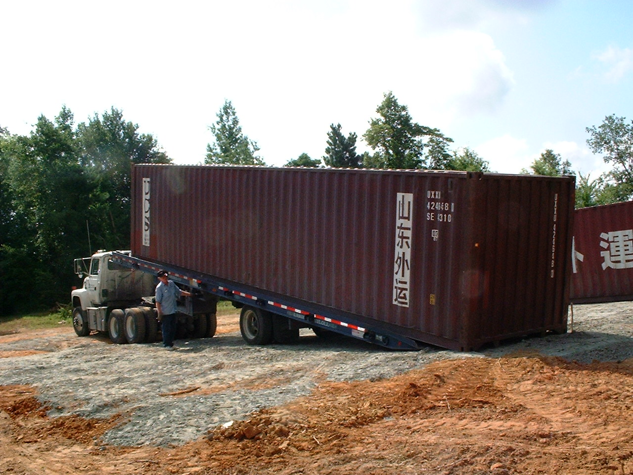

Been there, done that!
It took me about 6 months to get my building put up so I kept my 3510 Branson in my 45' container. I lived 50 miles away and wanted it secure.
Pic is of my moving the container, I had it put down where I wanted the building and had to move it.
It is now 12' away from the building if I ever want to do a roof-over.
When shopping for a container look for a "High Cube" they are taller inside.
My tractor was a little tight but it can go in with the ROP up.
Just know that they get very hot inside and you need some kind of roof venting for long term.
I just went right on the ground but all I have is sand under it.

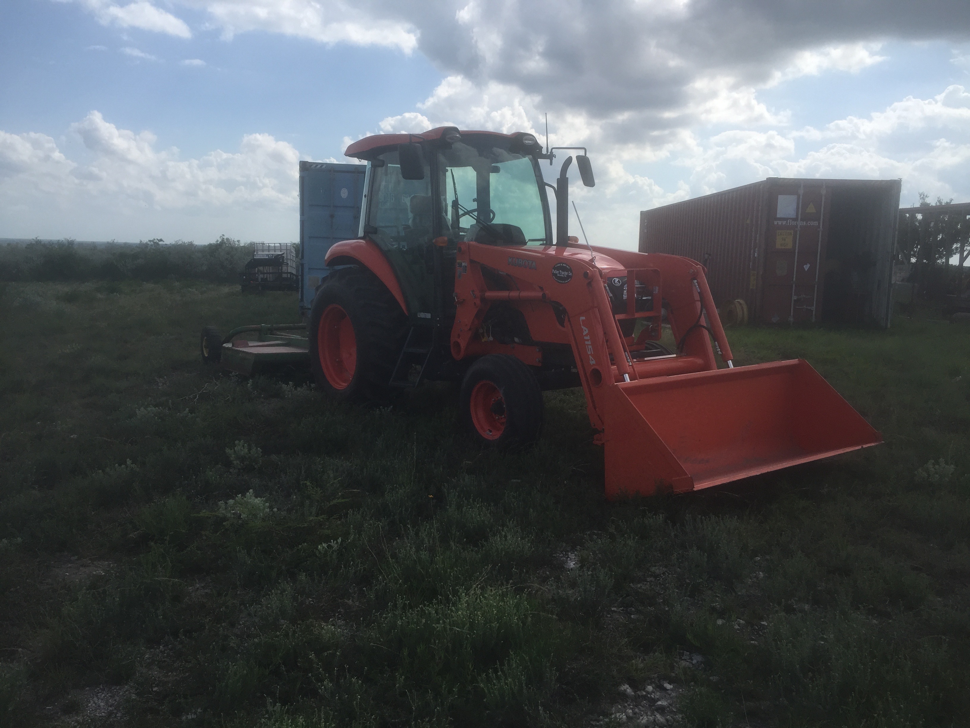

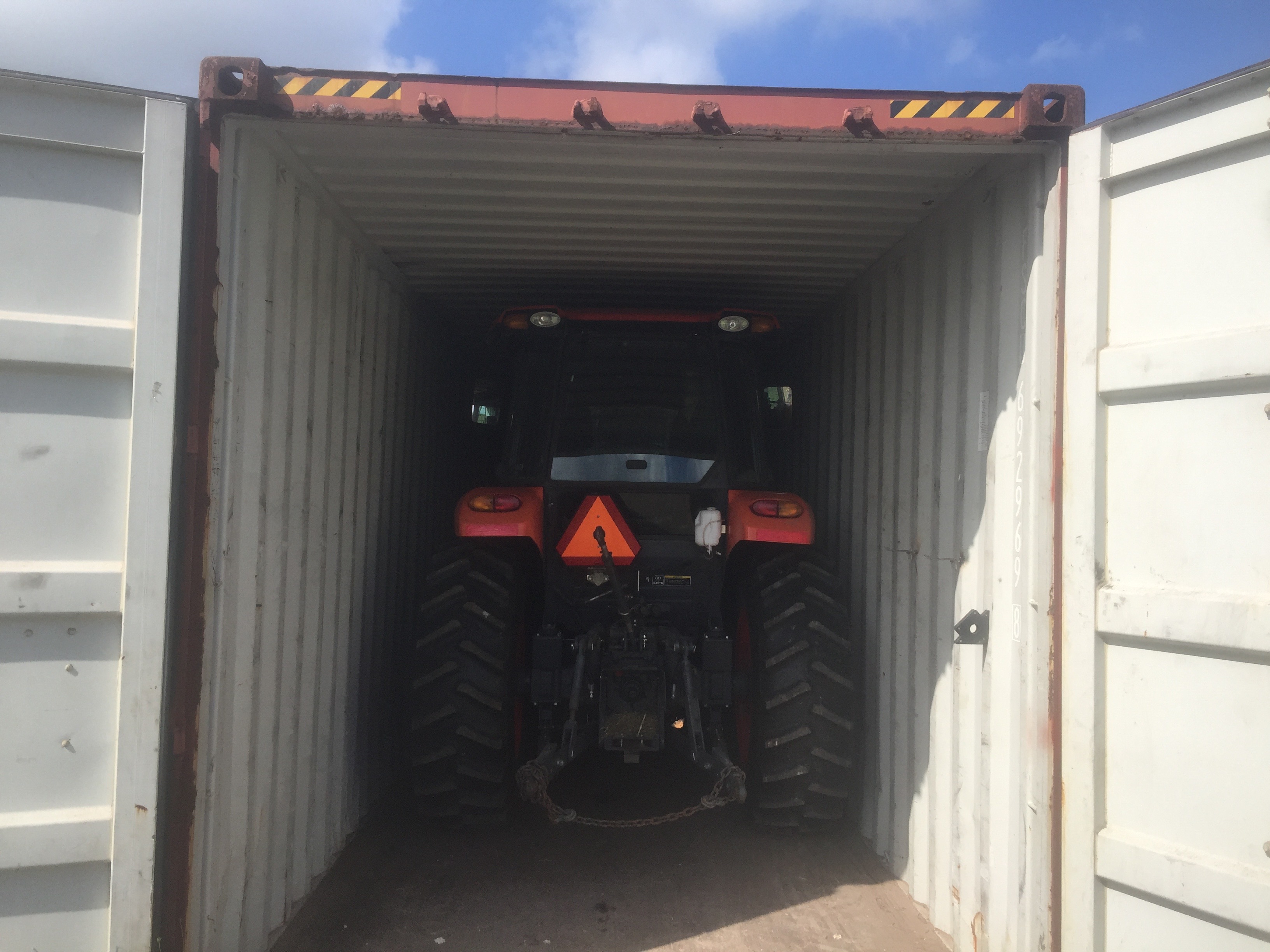

In my opinion, unless you're using the tractor once a week, a shipping container is the only way to store it. it'll keep all of the rodents away from your wiring and eating your plastic parts. I would be scared to death to see what a rat could do with all the new computers and harnesses in tractors. A shipping container will also keep your tractor out of the elements. The paint will never fade in the tractor will look like new if you ever decide to resell it. I recommend adding some vents to the front and the back to keep some air moving through the container.. Jusy, FYI I now back the tractor in so that I can get out of the container much easier..

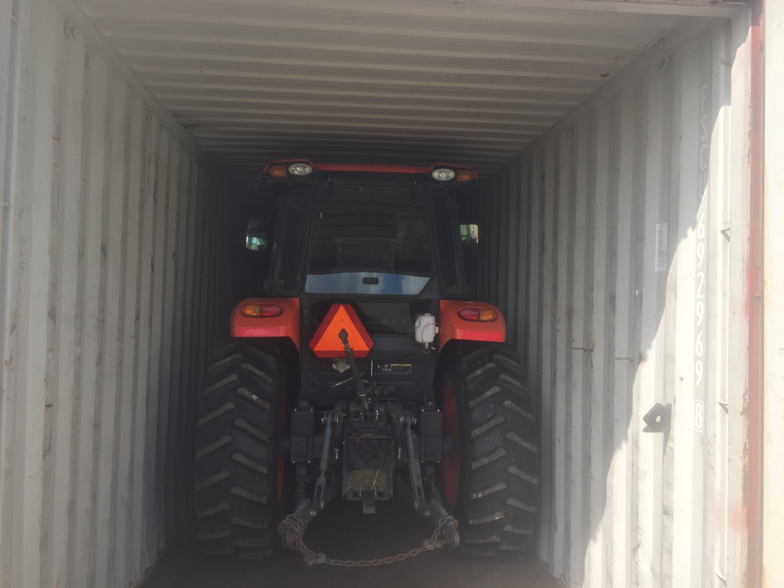

Pics of Bota backed in..

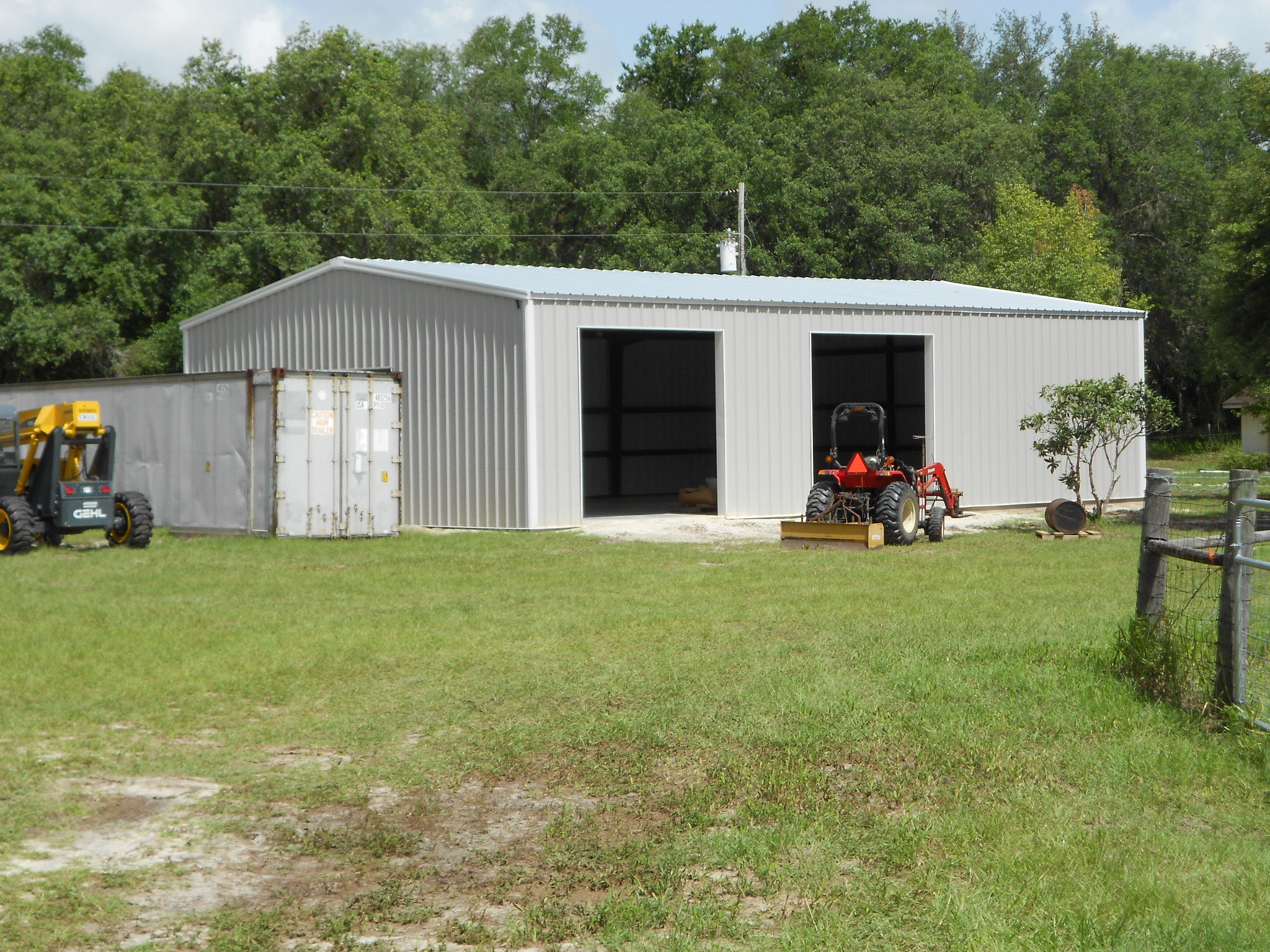

What size building is that?
/ Shipping container as SCUT/CUT tractor barn #19
Building is 40' X 60' X 14' and yes they shrink after you get them up! :)
What size of tractor is this. I'd like to store my 5030 in a sea container but not sure if I can get in and out of cab
