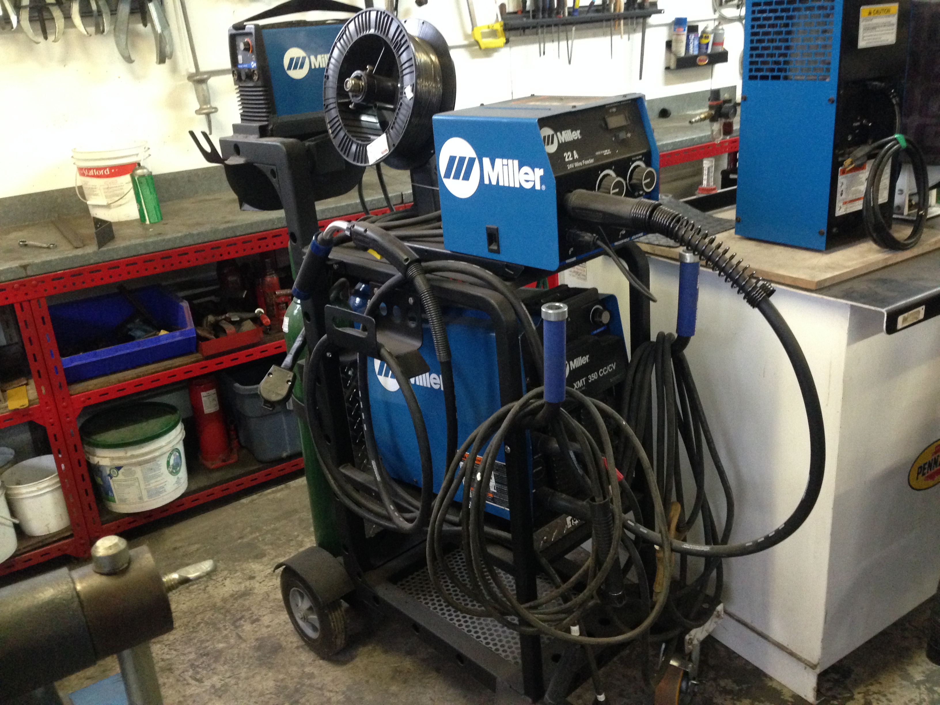

Like this ?

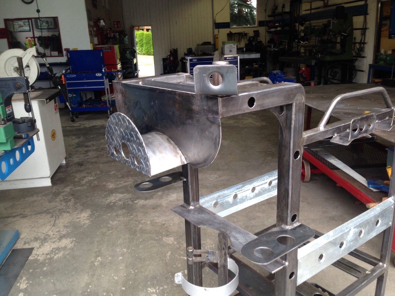

The real question is it finished BB? Like to see how its laid out.
The next thing I want is a dual feeder so I dont have to deal with switch between solid wire and dual shield!
/ Shield gas mixer #13

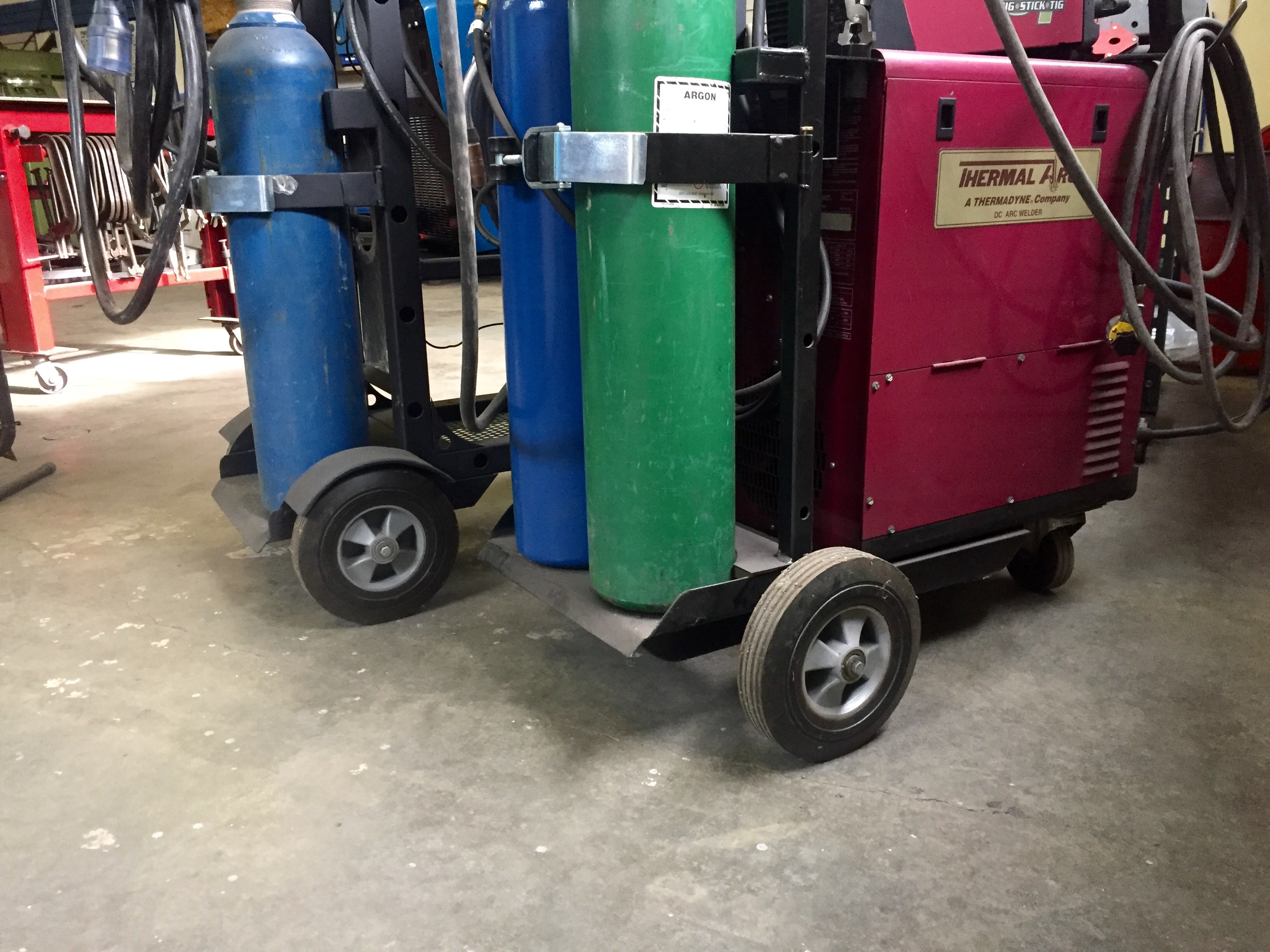

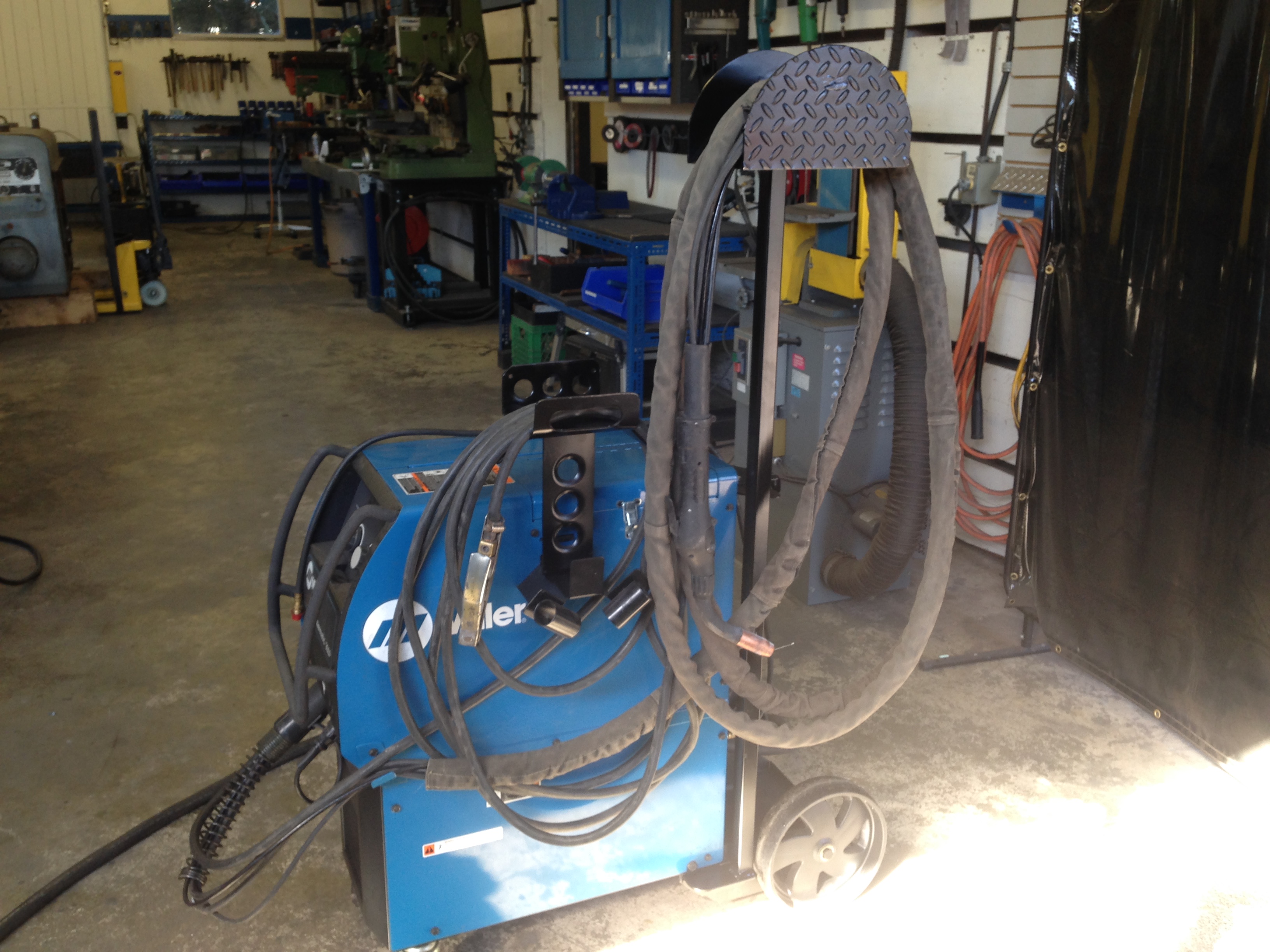

This is the cart that holds my XMT350. It is set up for two shorter tanks which would not be suitable for you. It has holders for a spool gun and a spot for the WC24 contactor.
Feeder on top and BB “tip and drop” holder to secure Miller Extreme plasma cutter OR Miller Maxstar 150
Here’s a pic of two tanks per cart
Here’s the original cart I posted with a Syncrowave I have since sold. The cart will need to be modified to accommodate a different welder if it requires two tanks.
Perhaps a more revealing photo prior to paint.

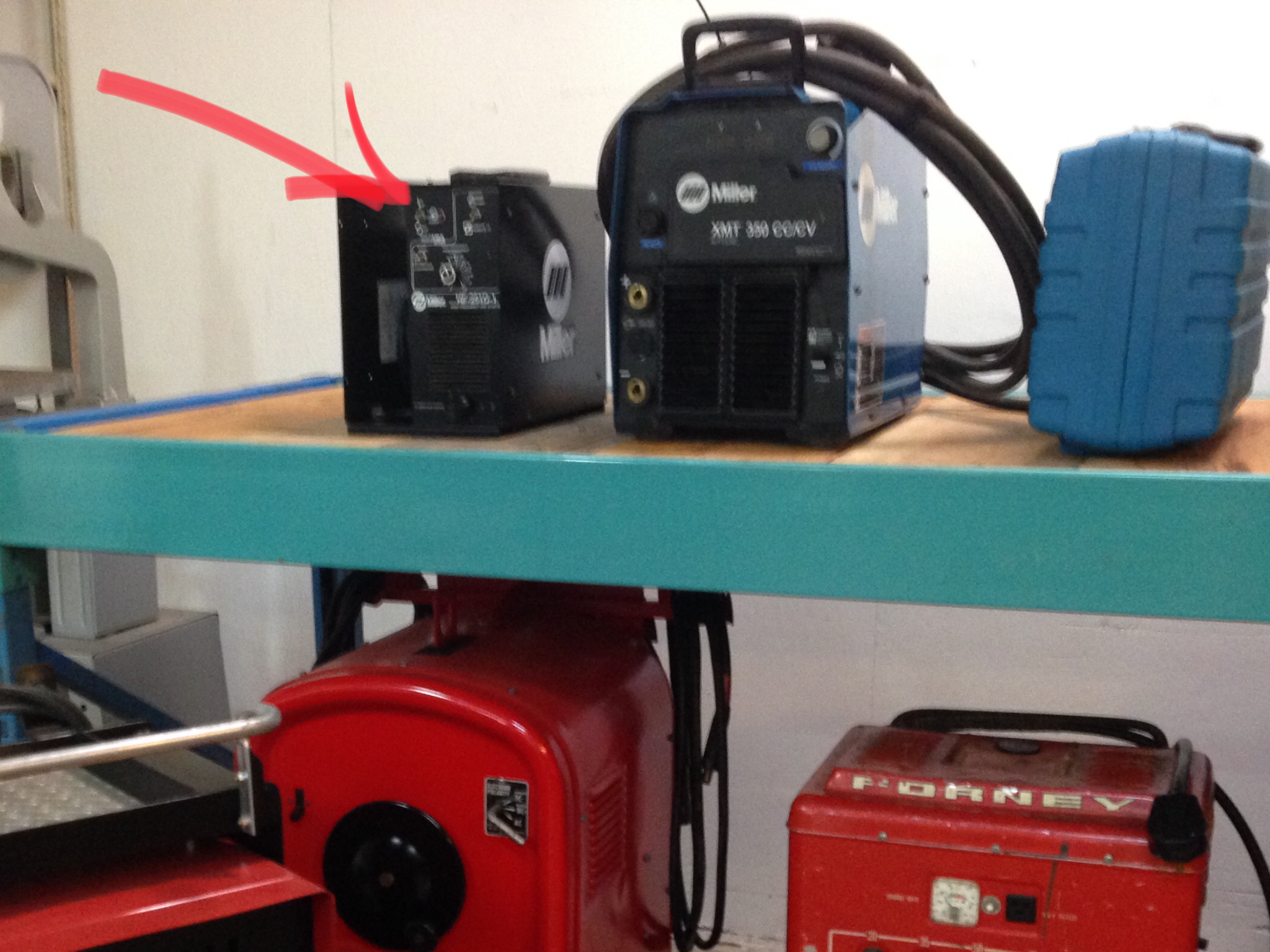

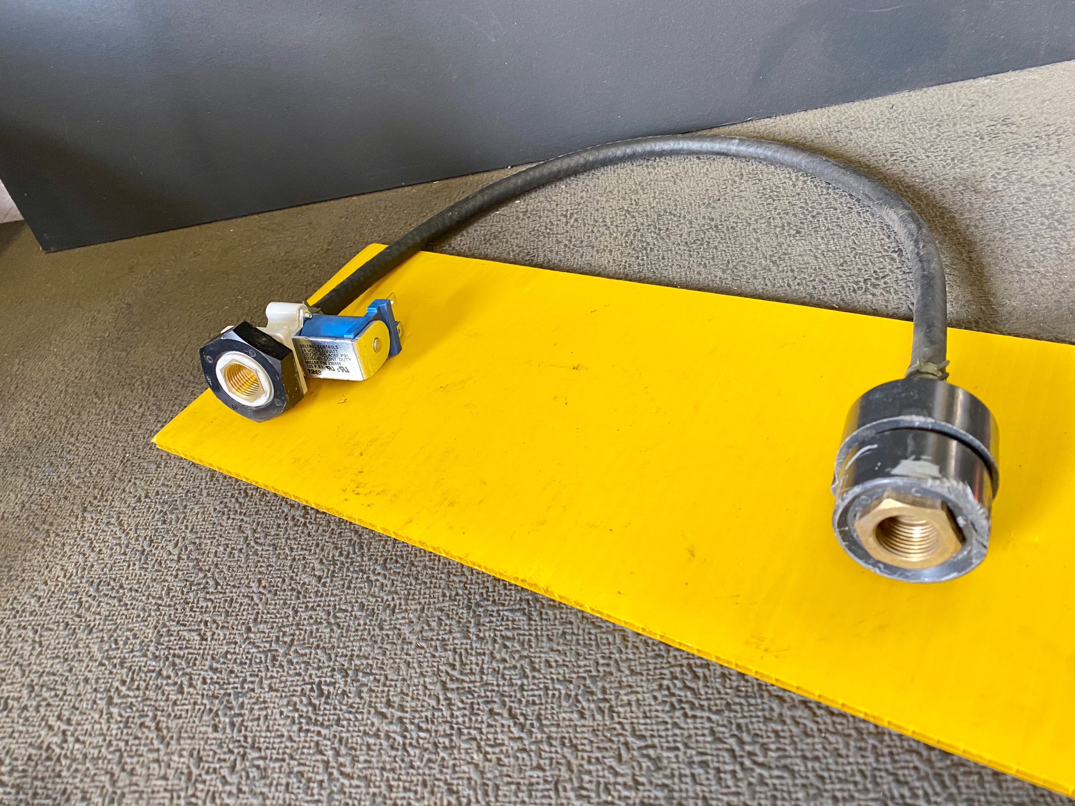

Let me know if you decide to DC tig with the XMT. I have an extra gas solenoid valve with pig tail for plug and play (if your machine doesn’t have one) that you can have. It’s light I can just mail it out to you.
I sold one of my two XMT 350’s and I saved the solenoid for the welder I kept but I will never need it. I can just use the torch valve if I tig.
I just looked to be sure I still had it
It has a panel plug for the front of your machine.
/ Shield gas mixer
#20
Wow BB that is a very generous offer! I actually would probably use the xmt for tig, I just didn't want to buy a valve torch that would only get used on it.
