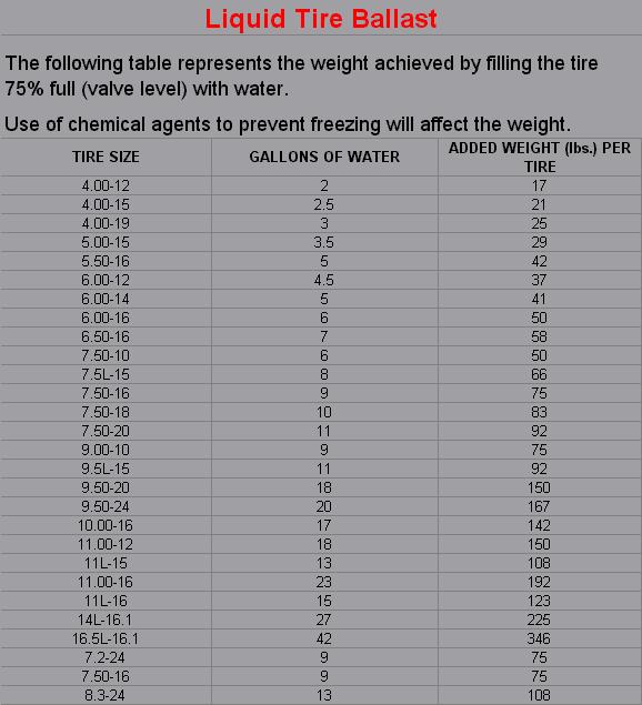

/ Shibaura D28F (tire loading) #10
I've posted a liquid ballast chart over three .jpg's. This might help you.

/ Shibaura D28F (tire loading) #11
2nd part

/ Shibaura D28F (tire loading) #12
And the last...
