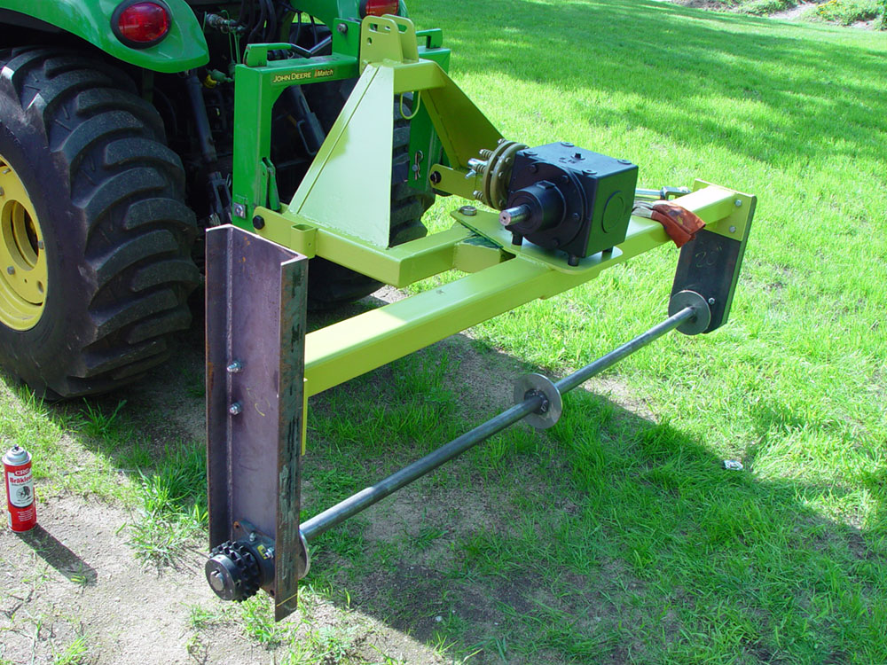

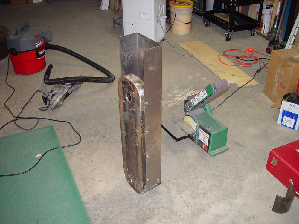

Yeah it took me a day to get the shaft aligned, internal disc & end caps welded to the shaft, and then that unit welded into the pipe...
Took me a complete 9.5 hours to weld on all the teeth...

Dave;

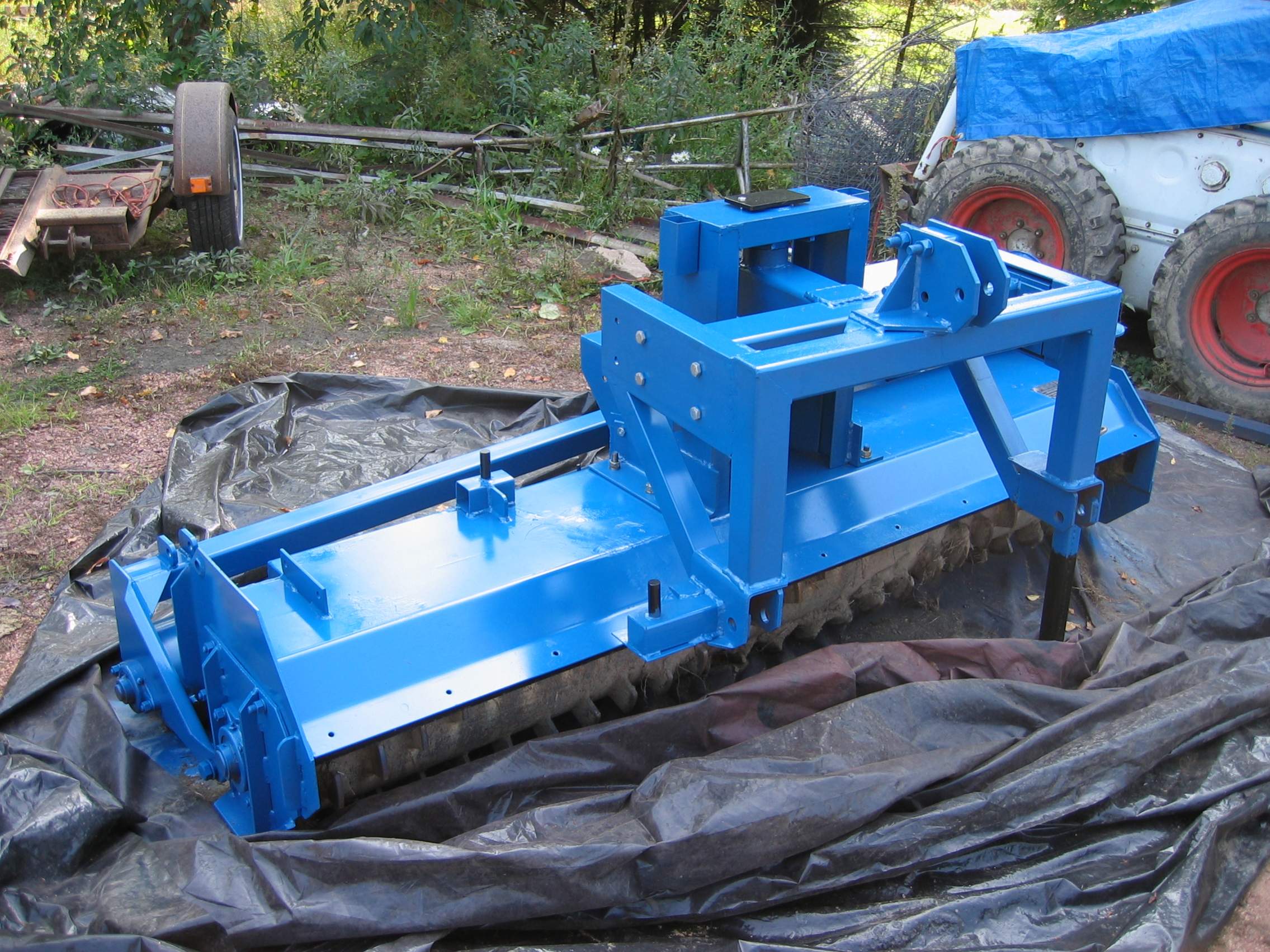

Super job. The Harley people would be proud. I knew we were talking about going 6 or 7' on the drum. The one I bought and revamped has a 9" x 84" drum. My TC 55 has 18" wide rear tires and it just clears the path at a 15 degree angle. I have a guy interested in buying mine so I won't be getting rid of my spare parts too quickly.

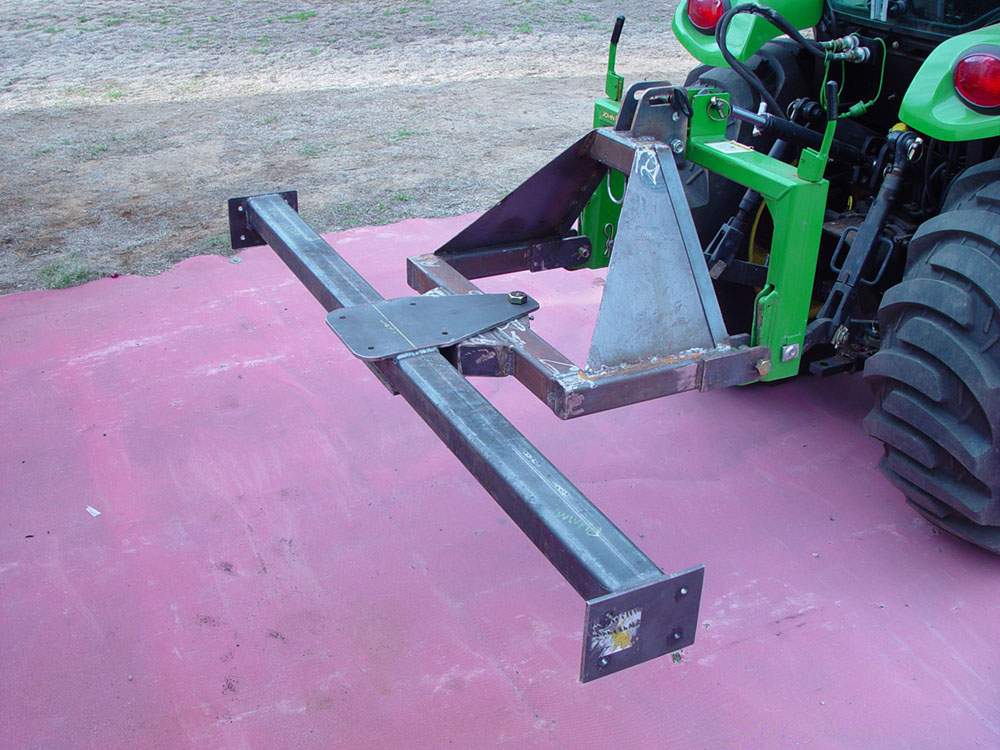

My tractor is pretty much exactly 60" wide so with a 75" Wide drum, even angled out at a little more then 15 degrees I got enough leeway, I hated to go TOOO wide because then navigation & where I can use it...All in all, I'm super happy with the way it turned out..

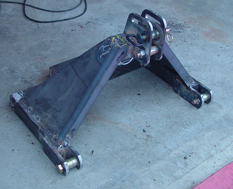

Looks good, Dave! I admire somebody who takes the time to do things right.
joes 427 vette: It looks like you began with a fixed-angle model 800 Preseeder. Nice job on the conversion process to hydraulic angle.
