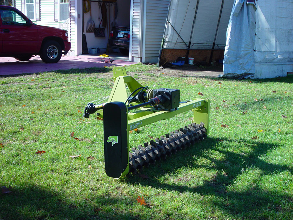

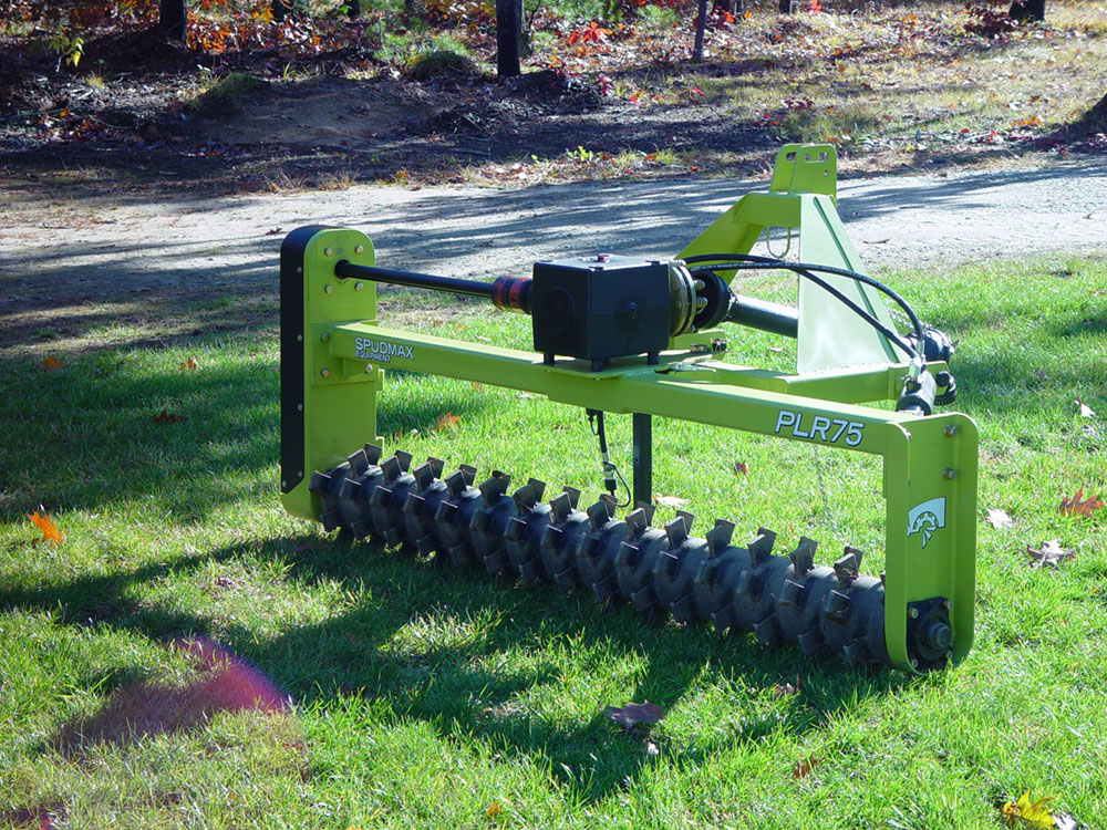

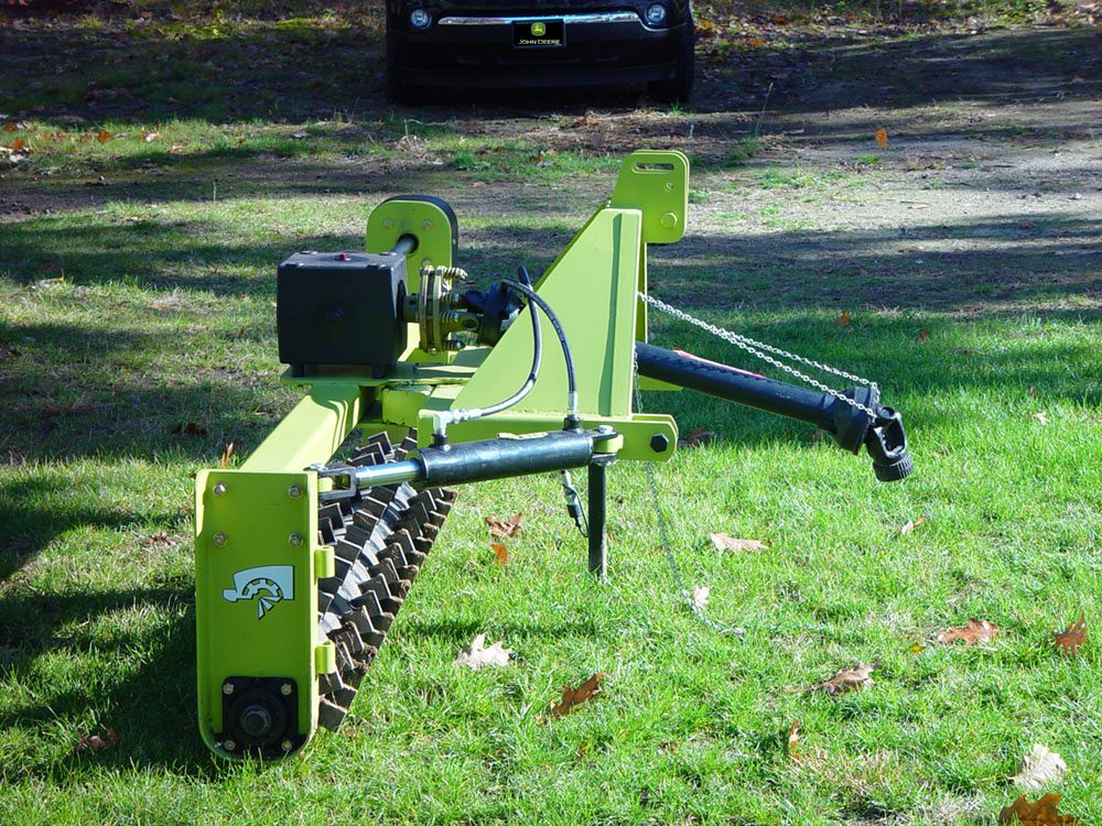

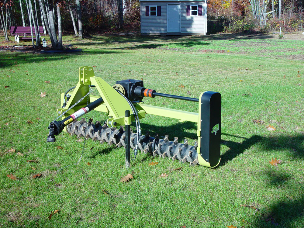

After many months of working "here & there" on it, she's finally "done" to the point of being able to be called a power rake...tested her out and she works beautifully.
I still need to build the end plates, gauge wheels and the rubber deflector over the drum, but quite honestly with the weather the way its going, I think mounting the snowblower will be my next project :D

That looks great, very professional. Now I have to ask a dumb question - what do you use it for?
Dave.

It's used as, just as the name implies a "power rake"
I have never used one, but have always wanted to try one on some dirt roads I help maintain in a private lakefront community I work for. The roads there are typically so hard packed that my rake doesn't always like to cut the surface.

/ She's DONE! - Power Rake Build #7
Looks great! What gearing are you using at the gearbox? I take it that it is also chain driven. Is it geared up or down there as well?

Thanks! Built it totally from scratch...I'll post more pics tomorrow of the build process.
Gearbox is a 2:1 unit which is what the Harley uses. Correct on the chain drive, and I took the liberty of gearing it down slightly there too... 18 tooth drive, 22 tooth driven sprocket, I have a 22 tooth sprocket here "spare" just in case I find its too slow...but I dont think it will be a problem, in doing my research for this build I think I'm right excactly where I need to be...

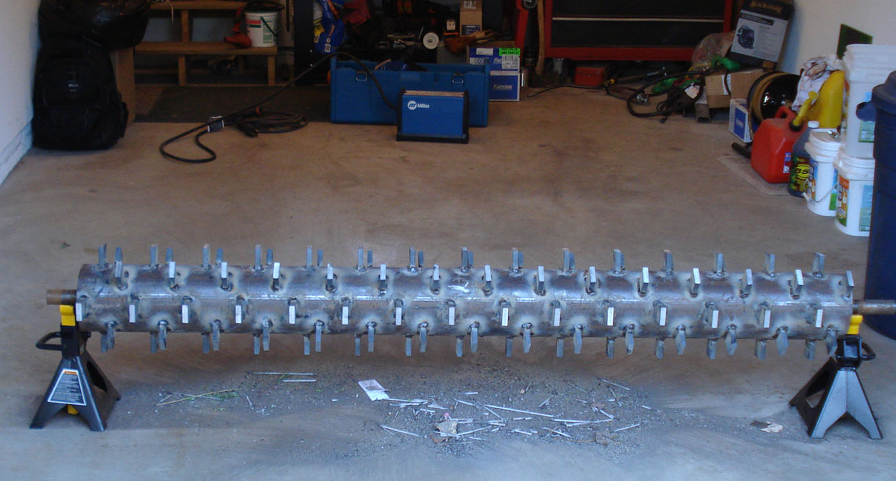

Very nice job on the power rake! I am just in the process of collecting pieces to build my own rake so I have a few questions for you if you don't mind. First, how big in diameter is your drum? How wide is the drum? How far apart are your teeth and how long are they? How many teeth in total? I am going to use the same style teeth as you did instead of the carbide tips Harley uses. I am having my teeth lazer cut out of Hardox plate. Thanks, and good job!

I love what you did with the rake! You did one heck of a nice job,but I think you really need to add 2 adjustable guage wheels to the back of the unit.Its going to be uncontrollable as far as biting in if you do not put them on.It is difficult to adjust it right the first time,with the rear wheels,I cant see you getting any kind of level surface without them.I have used the Harley T-6 for several years,they are am an amazing tool.If you've never used a harley rake to level out an area or put in a lawn,you dont know what you are missing.These things can turn days of hand raking into an hours work with an experienced operator who knows how to adjust one.I preffer the older harley rakes with the horizontal tooth bars,and twin counter rotating drums,it does a much better job,as it kicks all the rocks back in front of the drum,the newer style with the rubber flap/wiper lets everything thru,you have to rake quite a bit still by hand when using one to put a lawn in.The only downside to the old style is the dry gearbox,and the teeth clog when the ground is wet,you really need to use it when its dry.

Rotation - if you are standing as you mentioned...it would rotate Clockwise.
Because I'm not done, it didnt level too good...well, It worked great, but I know it can be better & easier once I get the gauge wheels.
Drum Dia: I used 6" pipe so the OD is something like 6.625"
Width: my drum is 75" wide
Tooth Spacing: Very tough to answer that one because its tricky...long story short is they are 5" apart from each other, but the spacing from row to row is funky. I duplicated the Harley tooth setup exactly. Easiest thing I can tell you would be to find a harley somewhere and take pics/measurements yourself so you can see it.
Total Teeth: I cant remember exactly, something like 118 or so...I CAN tell you it took me 9.5 SOLID hours (No breaks except to drink a pepsi and return said pepsi to the earth :D)
Thanks! As for the gauge wheels in my first/original post I mentioned I WILL be making some, I got most of the parts (Wheels, tires, hubs, etc) in the basement, but I was devoting my time to getting the actual rake itself done first. I've got the gauge wheels, End Plates & Rubber Deflector to build...Safe to say the "tough part" is done though... :D

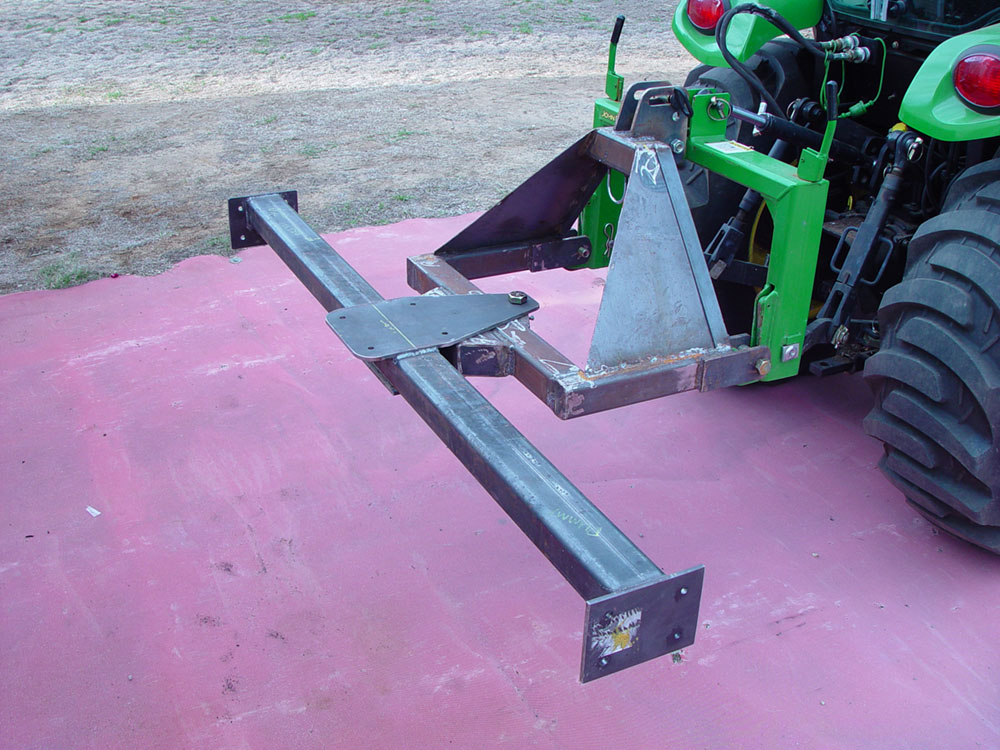

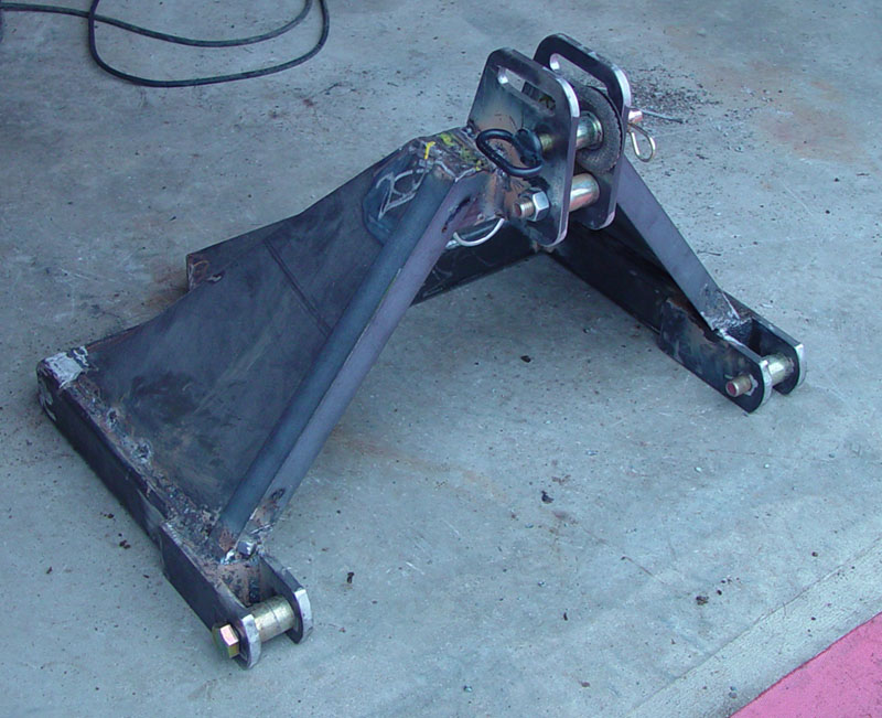

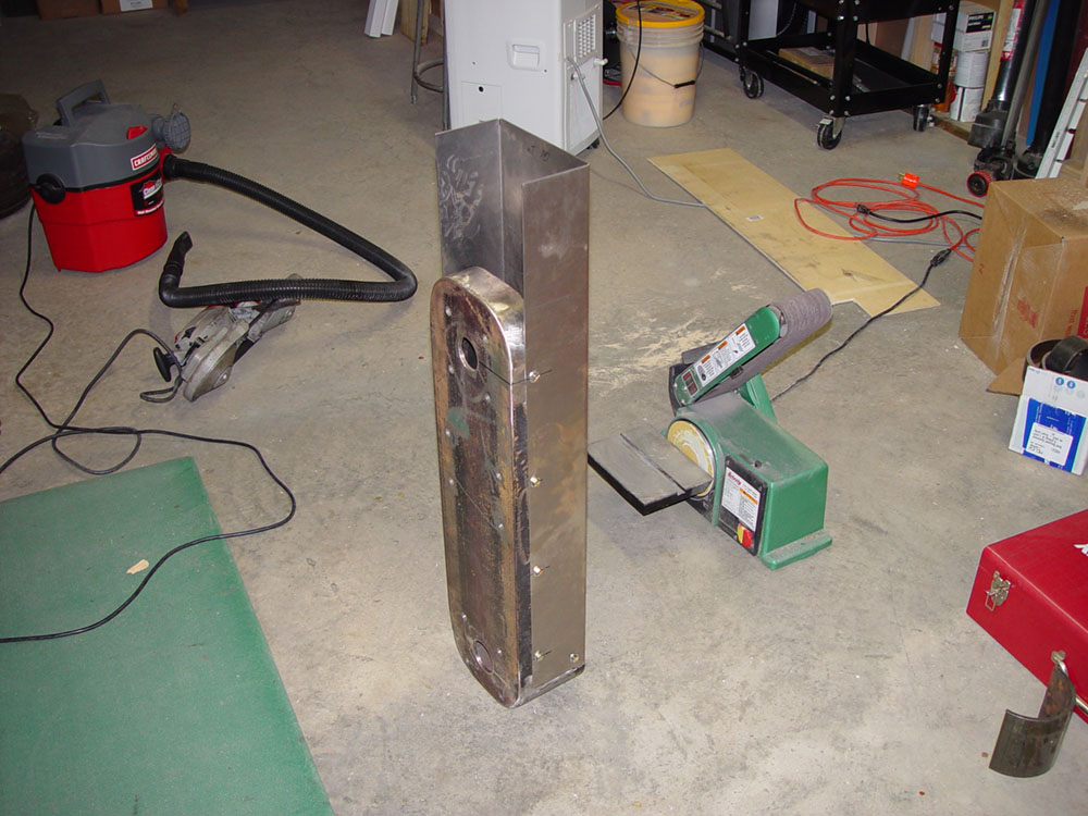

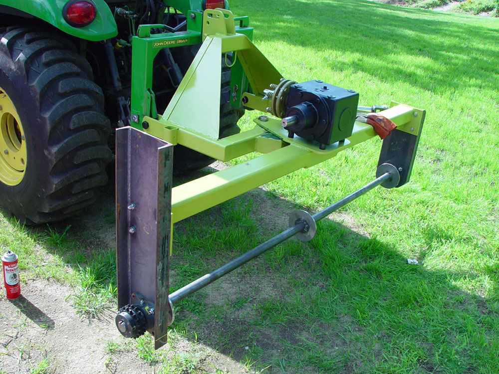

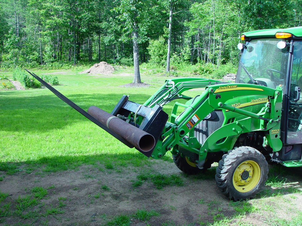

Build Pics:
