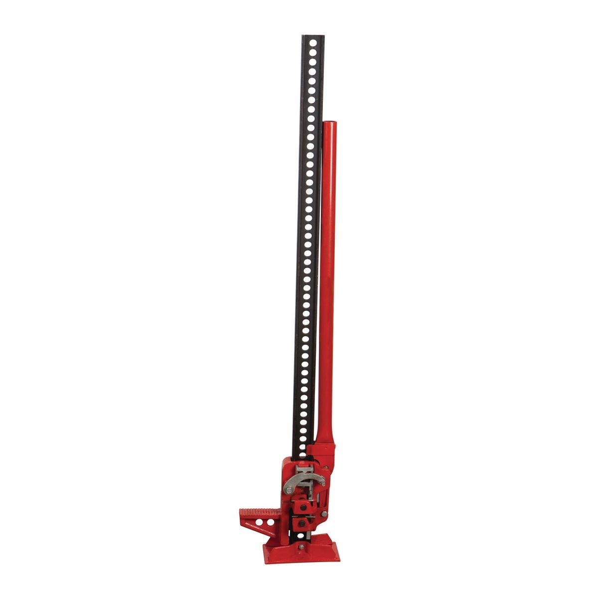

A hi-lift jack (farm jack) or two will work. Unless your trying to justify the expense of pallet forks......2x2 or 2x4 shed construction, plywood sides, shingle roof, wood floor? About 2600 lbs. - 2900 lbs.

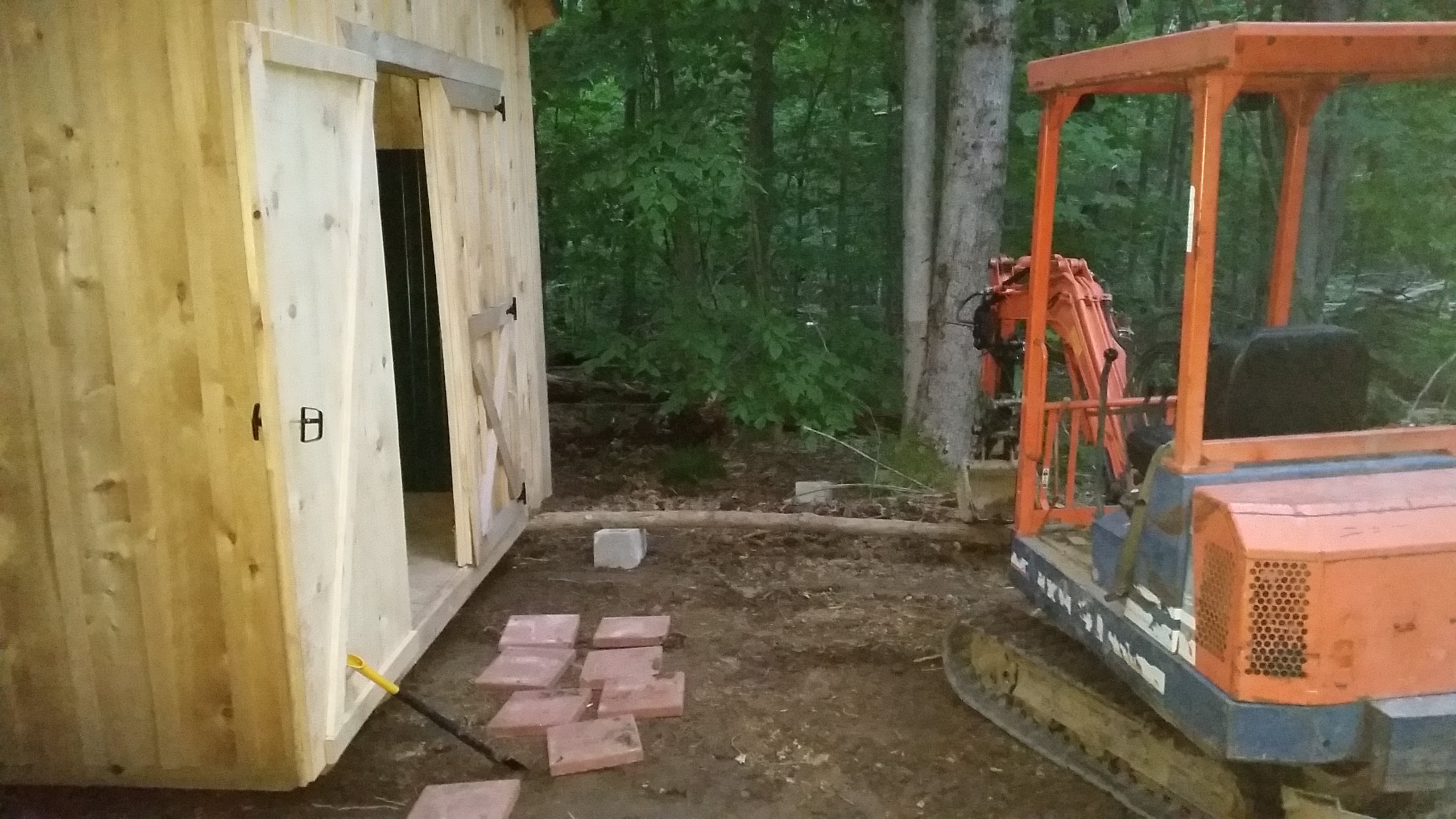

You need a bigger prybar. Leverage works..i swear. I recently leveled my 10x14ft shed made from real wood.(the pic)
A few years ago i helped my father move a 12x16 cedar shed. He jacked it up to support the runners a bit then we chained it to a dodge pickup with next to no air in the tires and drug it about 100ft. This shed was not empty.
