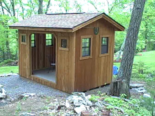

I not a professional carpenter, although I have helped professionals to trim and frame some houses. I built a shed with a wooden floor: the floor joists are 2x6's 16" on center, the floor 3/4" plywood. I've been storing my 800-lb ATV on it with no problem. I think you can go with 2x6 floor joists 12" on center with bull nose planking and not have a problem. Just be sure the joists and planking are pressure treated. And leave 1/8" gap between the planks for drainage, if water or snow gets in there. I would also put a row of blocking down the middle of the floor to keep the joists from racking. Another thing to look at is the base. Before you put down a bed of gravel, it's a good idea to lay out some wire mesh under the gravel. This wil prevent critters from digging under your building. Posted is a pic of my gazebo which I built.
Good Luck
