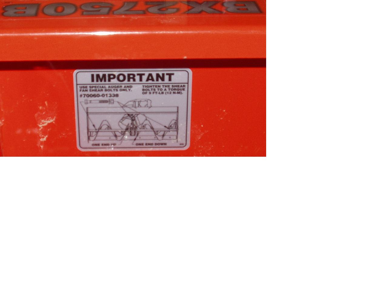

They must have changed this at some point. When I got my bx2750b snowblower it came with a couple of spare auger shear bolts and a spare fan shear bolt. The fan one was smaller as you note. But when I actually had to change the one for the fan, it turned out to be the same size as the auger.
In fact, while I was changing it I happened to notice the decal in the attached picture that shows the same part is used in all three shear bolt locations.

He is breaking both the auger and the fan shear bolts. The snowblowers that were manufactured for the 2004/2005 winter season have been changed and now use the same shear bolt in all 3 locations. The previous models use a different type of shear bolt system for the fan. He believes that the closeness of the fan to the steel cage is the problem. I believe that this is a manufacturing problem, because none of the rest of us with the same BX2750 snowblowers are having problems. When one out of many is the problem, then it is the defective snowblower. If we all were having the same problem, then it would be considered a design problem. Personally, I believe that Kubota should just bite the bullet and replace the snowblower. Junk....
