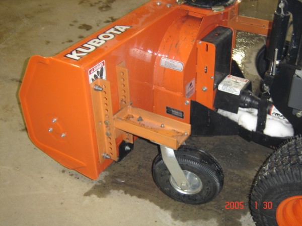

It appears that the snowblower is returning to my house today. The dealer was told by Kubota to use a grade 2-5/16. Kubota also told me the same thing when I called them to question it. The dealer said that when they tryed the grade 2 bolts they didnt have anymore breakage. I guess I will have to wait til I get home to try it myself.
   / shear bolt madness
#33
Just thought I would let everyone know the standard grade 2 bolts seem to be holding. Thanks to everyone for the help. I will try to post some pics of my caster set-up later today.

I think I have this attachment figured out now.
#38
custom cutting edge. (1"pipe) so it cant dig into my gravel driveway.

Finally had a snow fall to try out the blower shear bolts. I am sorry to report that I still have a problem with breaking bolts. The grade 2 bolts held longer than the grade 5 shear bolt did but they are still breaking at a high rate. I have about had it with this ordeal. Any new ideas on what I may try.
   / shear bolt madness #40
Call your dealer and tell them it's time to replace the driveline on your blower housing (because of the drilling). Maybe you can work out paying for part of the labor or something. You have a gearbox/driveline problem.
With your "pipe" trick and the caster wheels, you are doing everything possible to keep the gravel out of the blower. It has a mechanical fault somewhere.
I hope you can get some satifaction. These are good blowers.
