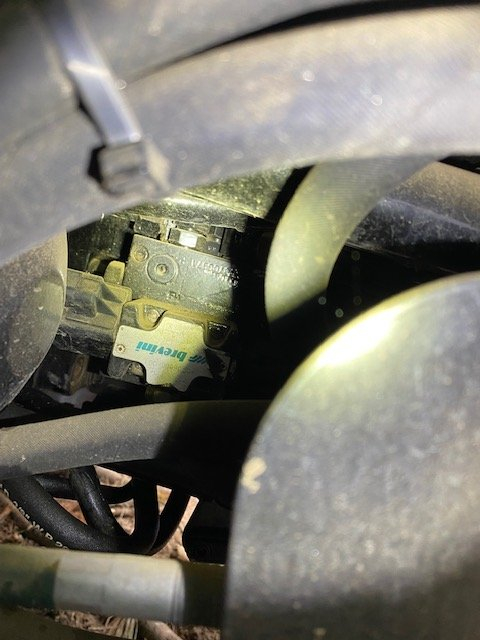

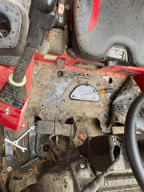

The long and short of it is the pic looking down at the deck of the tractor... where the tip of the screw driver is... I need access directly below the the floor in that area to get to a hose.
I spent a couple hours yesterday trying to figure it out I don't see how the floor comes off.
I expected to see access panels I could un bolt but no such luck.

Could you unbolt and remove the floor pan? Most tractors you can but not sure what is involved on yours.
I don't see a way to do this... Maybe the seat and fenders need to come off not sure. I'm hoping someone has some experience here. I have a shop manual but it is no help.

Without seeing one in person, it looks like you can unbolt the cross member to back out the distribution block that the line broke off from. Put a jack under it to relieve any droppage if you can unbolt it.

Not pretending to know how to do this, but from the first photo am wondering if the A hose can be removed (inspected for damage), then the B fitting (square block) turned off. Then wondering if the bracket C can be unbolted to allow putting the new parts back together.
Guess the debris with ?? mark is the woody chip that may be what is left of the cause of the damage.

you are right. "C" part came out after removing another piece of steel that runs perpendicular to the axles. Then I was able to actually remove the banjo bolt/fitting while leaving 'B' on the tractor. Hose 'A' is fine the piece of wood is superficial. My only trouble now is getting under the deck to remove the other end of my broken hose!

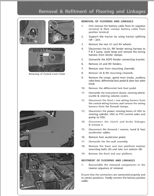

About my 3rd time through the service manual I have finally identified the part.
I am attaching (2) pics that are screen shots from the manual. The first is how to remove the part the top end of my broken hose attaches to. It is the PTO Control Valve. Steps to remove the valve include disconnecting all the hoses and "peripheral parts to access the PTO control valve". All the pics from the lower left hand corner of the sheet show the guy easily wrenching on the thing... from the top, through the plane of the floor, so the floor must be one of those "peripheral parts".
The 2nd pic attached are the steps to remove the floor of the tractor. Holy smokes, the guy who said that this hose was one of the first things bolted on at the factory wasn't kidding!
The removing the floor procedure has me concerned because I do not have a special tractor splitting jack. I do not have jack stands I would trust to support the rear of the tractor. I am concerned about jacking up the tractor out in the field. I am concerned about the weight of the wheels/tires. I do not have a way to transport the tractor this needs to be a field repair. Do I need a special jack? I could buy a big bad ass floor jack and get some meaty jack stands. Maybe some 2x10s between the bottom of the jack stands and the ground to prevent anything from settling. Not sure. Tractor is sitting on a slight side to side angle.
My alternative to removing the floor is to cut a section of it out and then weld in a few tabs to support the cut out piece (create an access panel). I am not thrilled about cutting up the floor of this sub 30 hour machine.
What would you guys do?

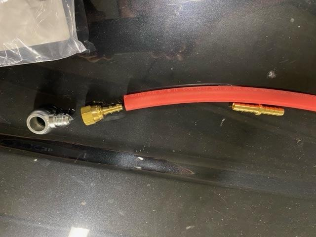

I think I have a solution.
I took a piece of the hose to a hydraulic shop thinking it was SAE 100r1 which is rubber/steel braid/rubber (based on the cross section I saw) to get the reusable fitting. They told me it was not SAW 100r1, it was just rubber hose with fiber/cloth reinforcement. We peeled back the outer layer of rubber and they were right. They told me no reusable fitting since this was not a high pressure line.
At first I was doubtful, but then had an epiphany... if the hose was dumping back into the transmission, there is no way this could be high pressure.
Checked the hydraulic charts, the PTO control valve is fed from power steering return and lubricates and/or activates the PTO clutch once engaged via a solenoid. Oil is then sent, via my broken hose, back to the transmission sump. They hydraulic chart indicates that this hose only sees tank pressure, which has got to be 20 psi or less.
I picked up a foot of hose (300 psi rated, they said it matched my sample), a new banjo bolt on a barb, and a splice barb to connect to the existing hose. Need to grab some hose clamps and I'll have her patched up this weekend.
