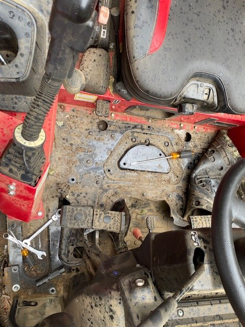

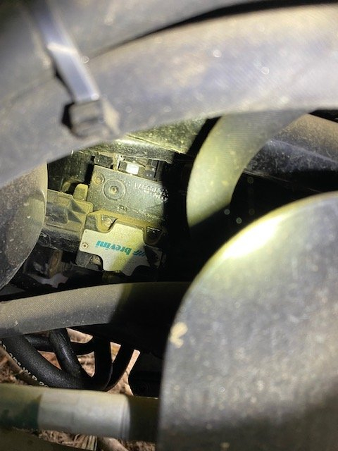

I found the other end of the hose. It goes into this block with a bunch of other hoses in it. Looks almost like a spool valve on my excavator, but I don't think that's what it is. Anyway the other end of the hose goes into the top of that block. I attached a pic of it. Top of hose is not even close to accessible as is. It looks like that block is bolted to something and I could unbolt it and take it down, but there does not appear to be enough slack on the other hoses to do so.
Getting to it from the top would be ideal. I took off the floor mat and plastic by steering column looking for access door, there does not appear to be any. The hose I need to access is directly below where the screw driver in the other pic is pointing. I really don't want to cave man it and cut through the floor but there is no way I'm going to drop the transmission to get to this. Taking off the fender does not appear to create enough room either.
Everyone was very helpful to my first post, any experience getting through the deck here? What am I missing? Thanks.

It would help greatly if people who post pictures would annotate the pictures, with arrows pointing out critical features.

Could you unbolt and remove the floor pan? Most tractors you can but not sure what is involved on yours.
