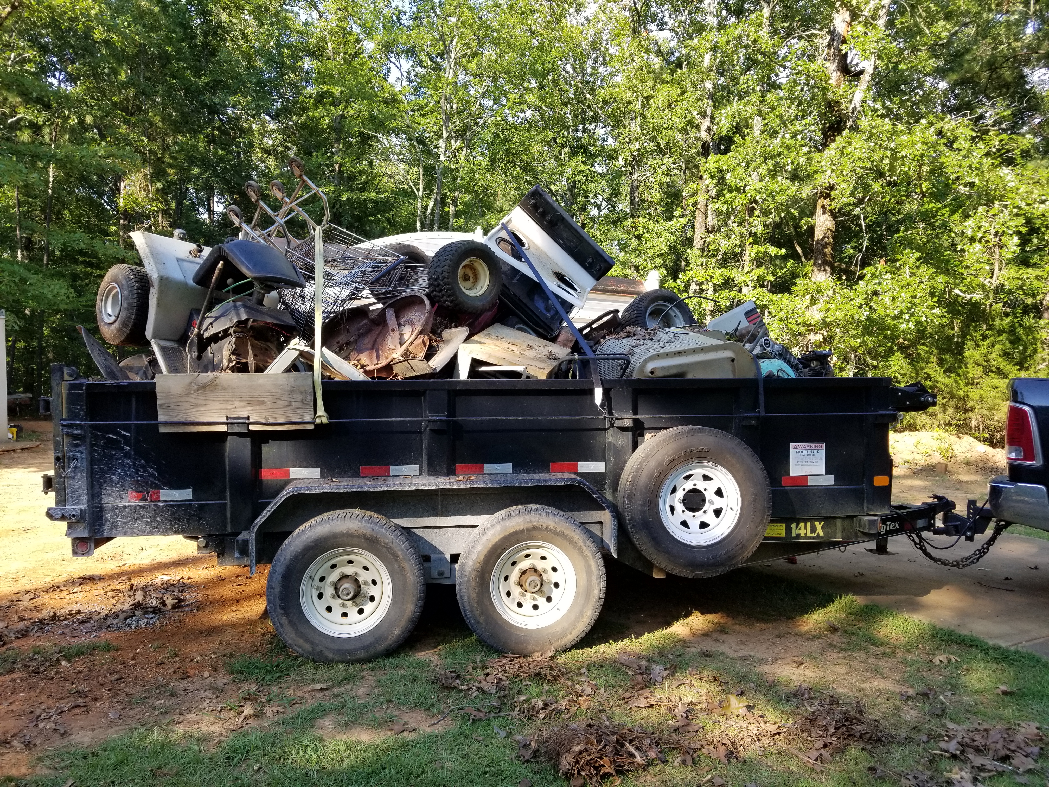

I needed that sign a few days ago, but now I have more room for some new to me junk.
/ Share Pics of People Hauling or Towing Something Wrong #10,446
Most of that will buff out!
/ Share Pics of People Hauling or Towing Something Wrong #10,447
Geeze, i'd probably asked you if you minded if i pick through your pile. Not saying i would have made anything out of the "junk" but.... :laughing:
Yeah, I could use a couple of those tires if they hold air.
a couple of those tires still had air in them but they were dry rotted bad, my wife wanted to check me for a fever when she seen it.
