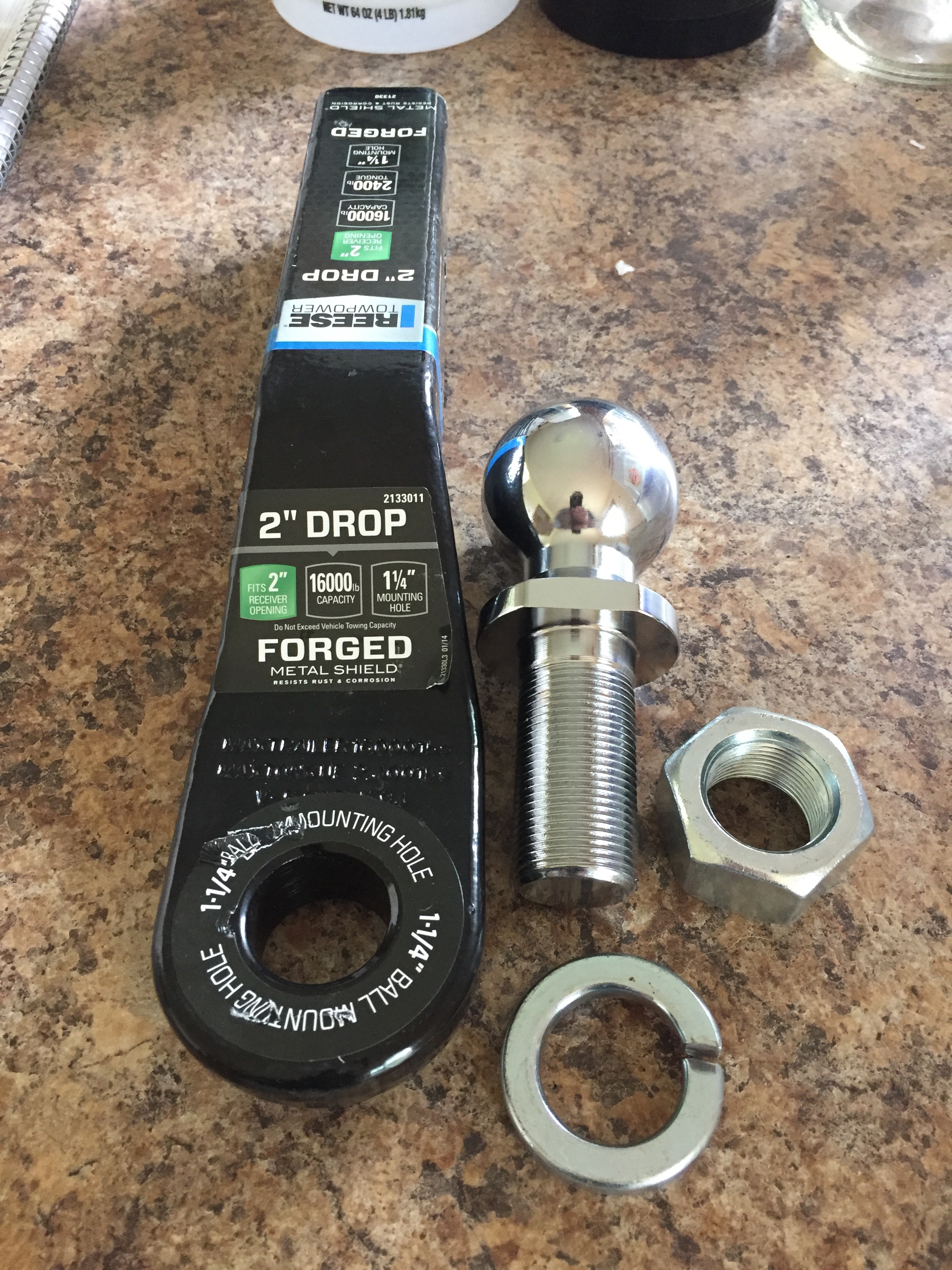

And to think I have been stressing about my receiver and ball mount I bought for my truck, all rated more than I need, I picked up a hallow Reese 6k ball mount for a 7500lb 2in ball. I have a separate 2 5/16 ball set up was a 16k curt ball and a solid 15k Reese ball mount to attach to my class 5 receiver. IMG_7387.JPG
This guy is getting away with a class 1 or 2 lol, I could have saved a lot of money going class 2 to haul my 5300lb tractor.
