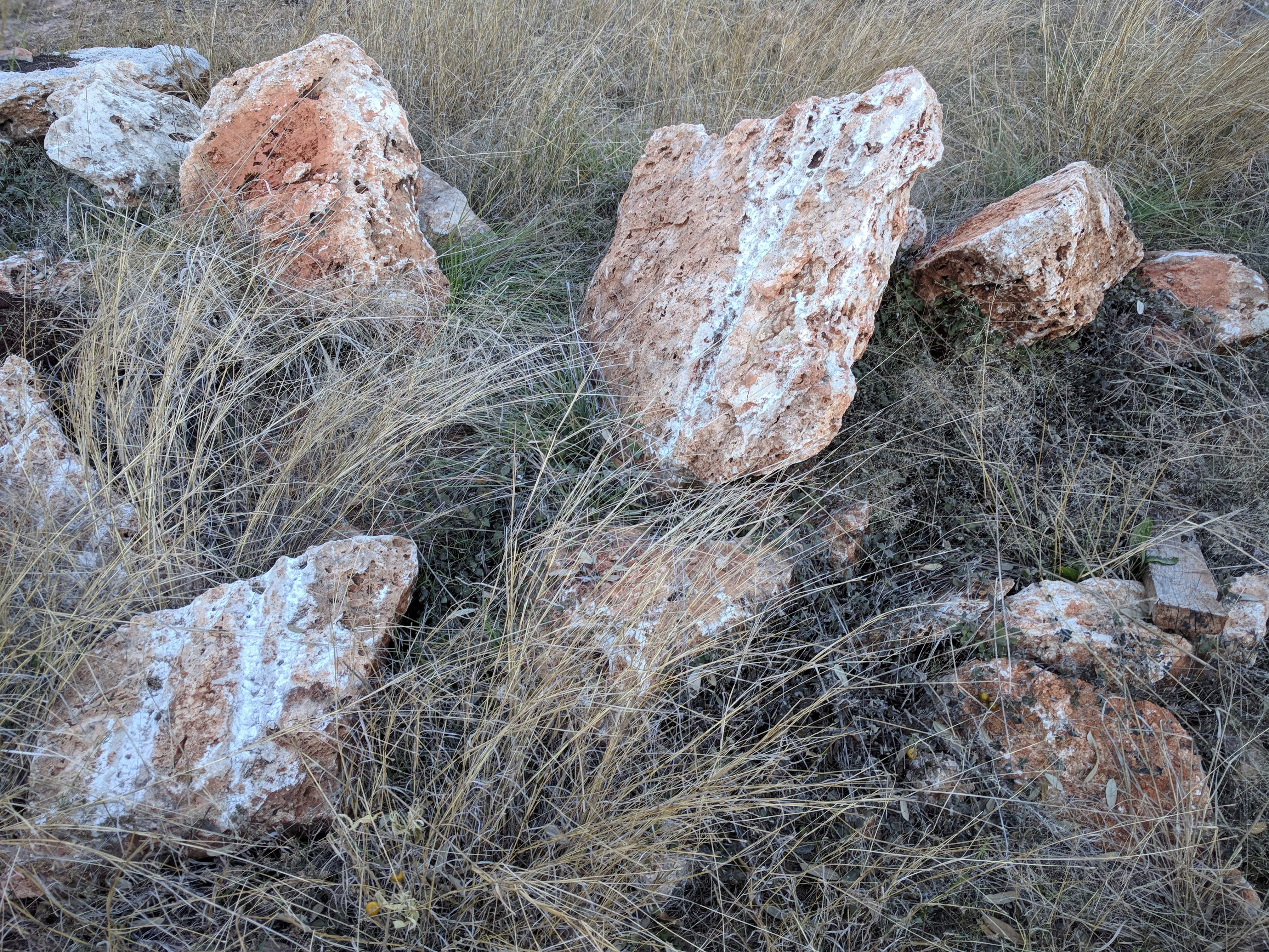

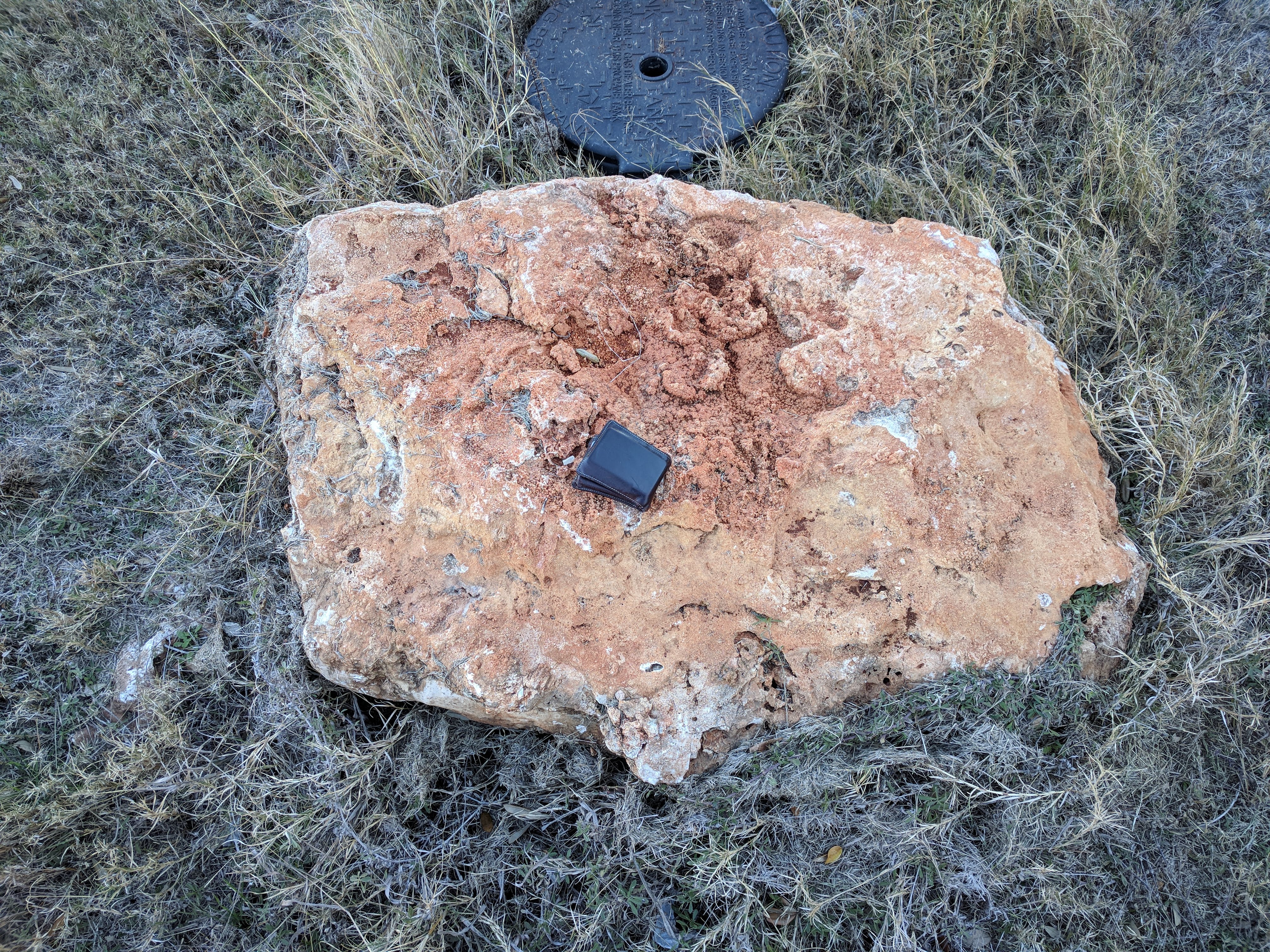

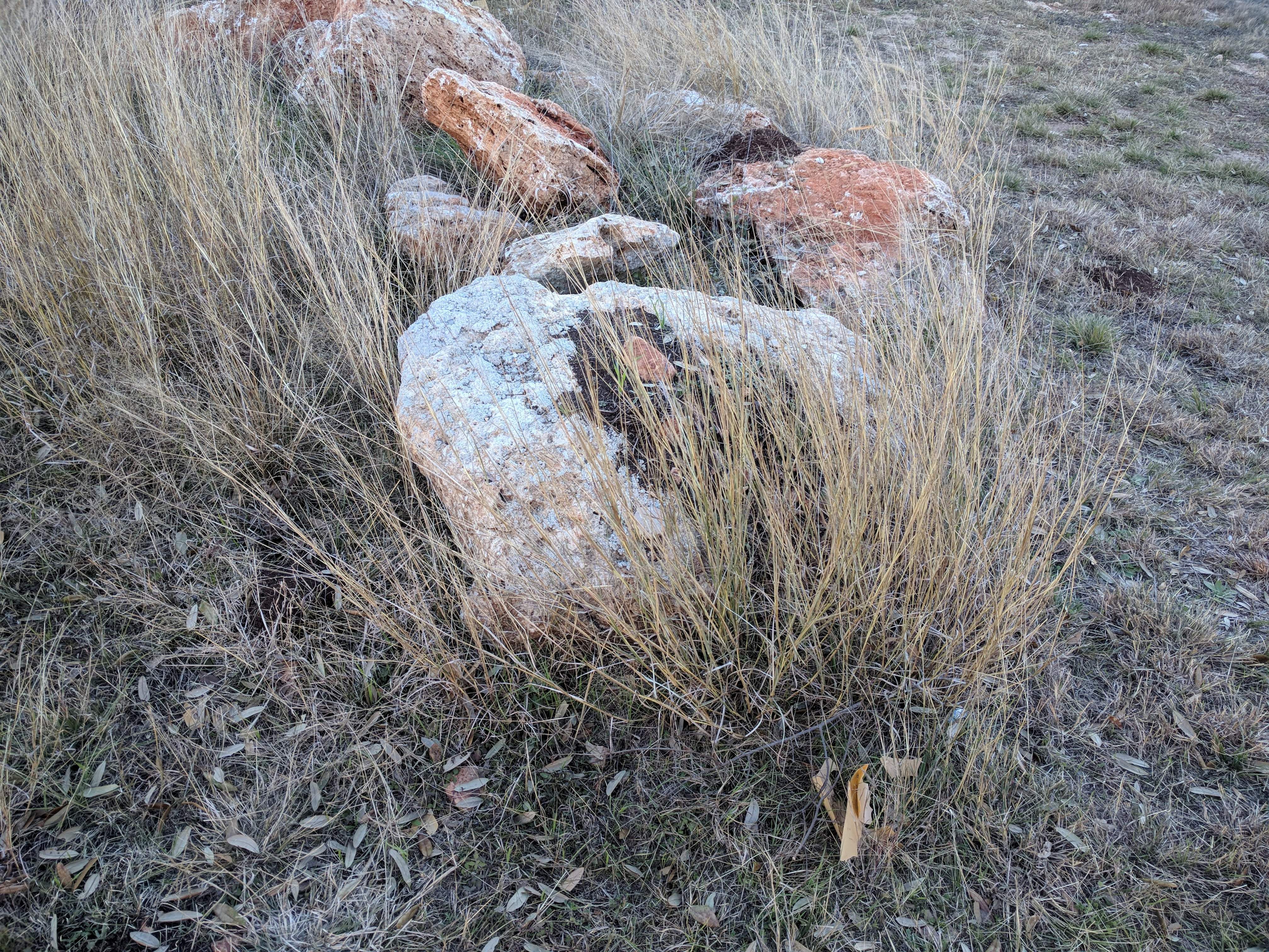

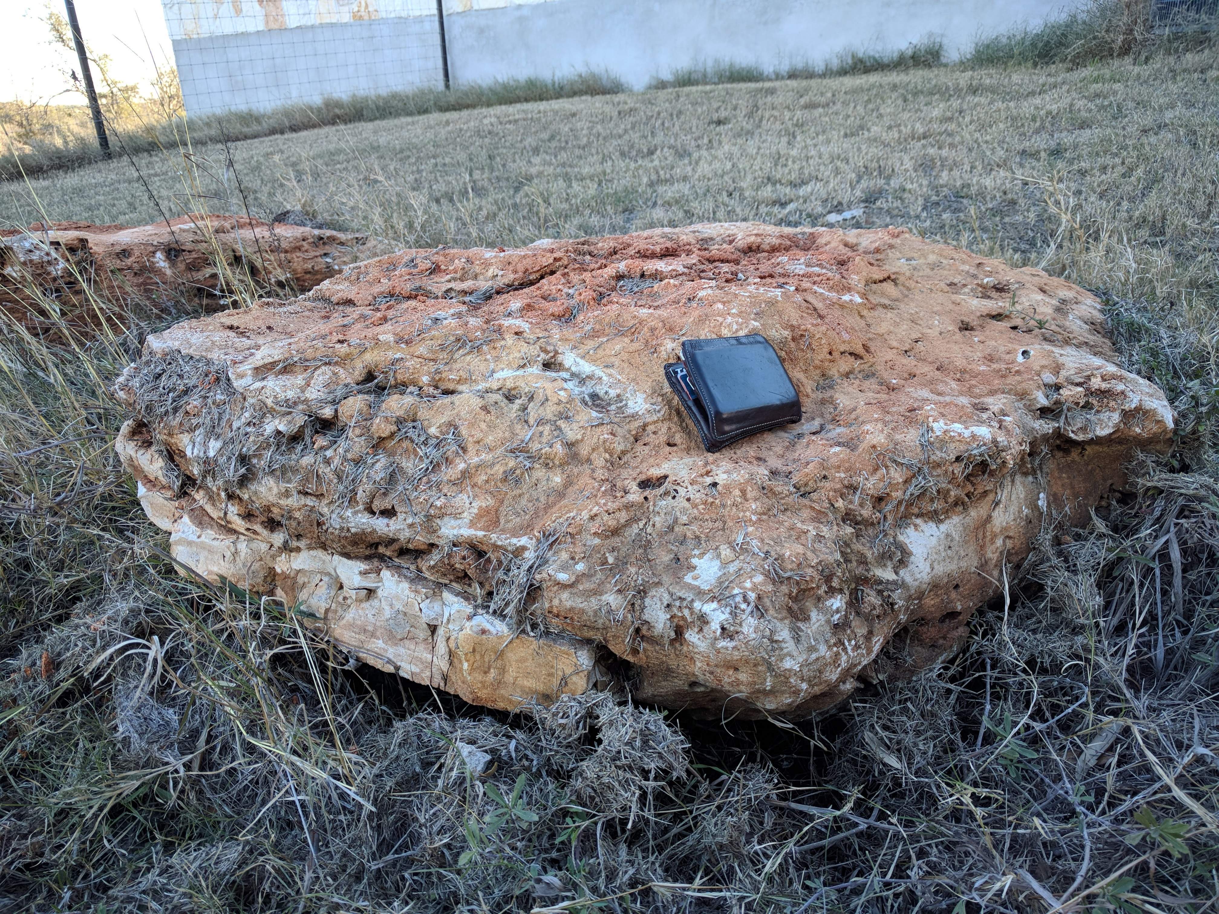

1) I'm in the market for a SCUT TLB. I have ONE (1) acre and there's a house and garage on it. Also I'm kind of a big guy. 6'4" and north of 300lbs.
2) What I do have though is a lot of brush, cactus, and cedar saplings to clear out. The soil is ridiculous; I've never seen so many rocks. I want to churn them all up and out if I can, which might be futile, but ignorance is bliss? My wife is from Iowa and dreams of doing some micro-farming. She would just like a healthy garden and I want to try to make that happen for her.
I have boulders to move around, I'll attach some pictures of those (with my wallet for scale!). I'm thinking if a SCUT isn't up to the task of dragging them around I could just rent something just to handle those and i'm pretty sure a SCUT can handle everything else. Seems silly to buy something bigger just to move some boulders that I likely wouldn't move again?
3) I also have a long list of other ground engaging projects but my free time is somewhat haphazard.

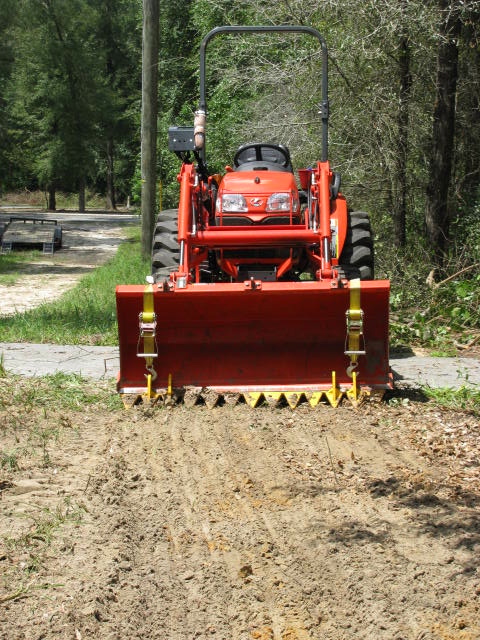

1) For one acre and the few tasks you have enumerated a 1,700 pound SCUT should be fine IF you can find one your generous corpus can sit on and operate comfortably. For comfort you may want to investigate 2,700 pound CUTS with <25-horsepower. Still small but more operating station room and more capable. In Kubota, this would be the L2501.
2) For a SCUT nothing improves capability more than a Ratchet Rake bucket attachment, which you can order from the T-B-N store, which acts as an agent. Ratchet Rake will drag out the brush and saplings, prize out the boulders.
If your initial garden aspirations are small, Ratchet Rake can remove sod and open the soil to 4" deep.
VIDEO: ratchet rake - YouTube

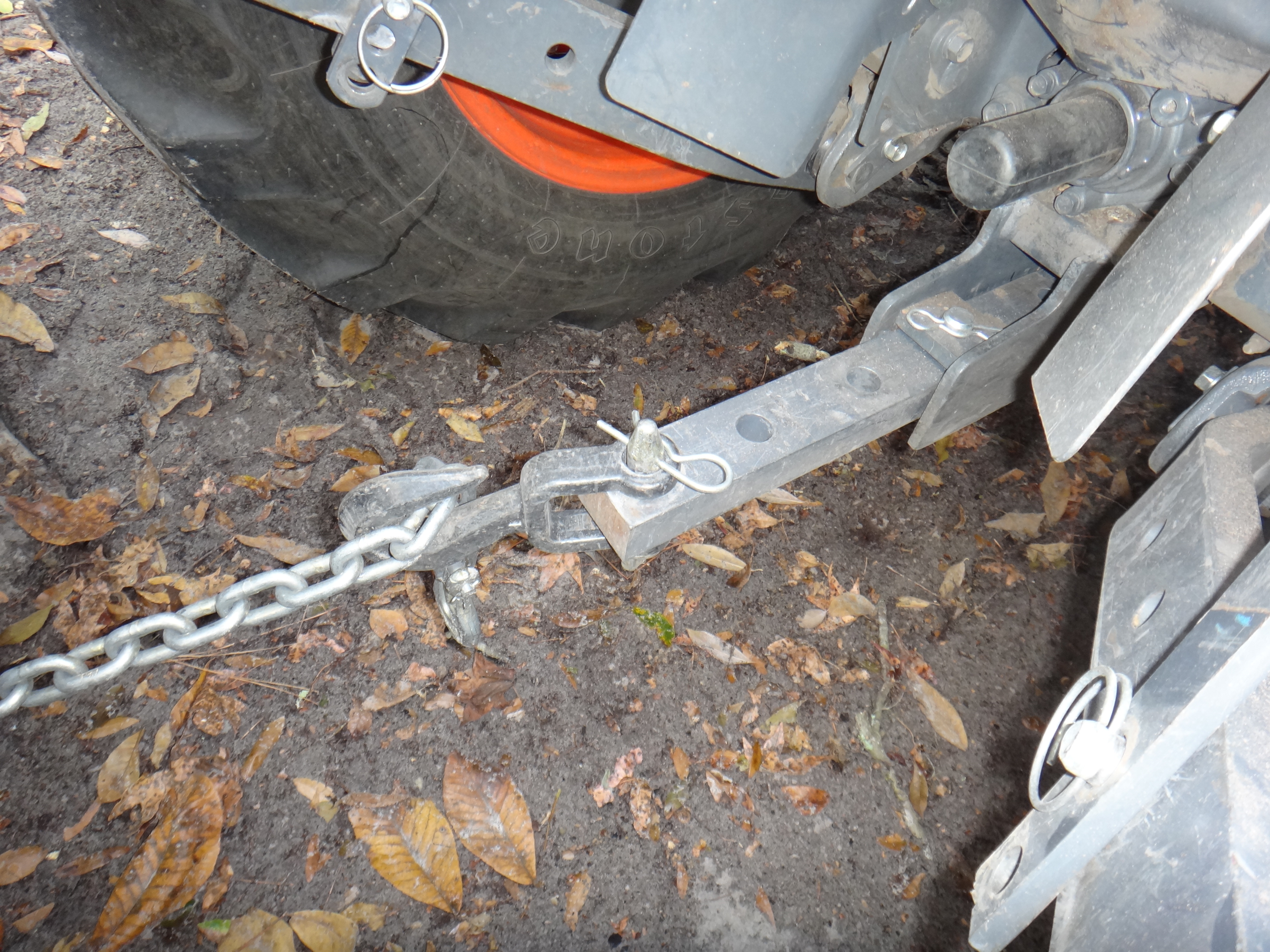

You should be able to tow the boulders with a nylon strap or chains from the tractor's rear/center drawbar. If you do not have enough traction you can buy an old car hood at a junkyard and use the hood as a boulder sled, nudging the boulders on the sled with FEL/Ratchet Rake.
Another option for transporting boulders is Three Point Hitch pallet forks, which can be angled down, somewhat, to get under the boulders. You would want the type with adjustable spread between fork tines. (However, sled suggestion will allow you to move heavier boulders than pallet forks.)
VIDEO: 3 point hitch pallet forks - YouTube
MICRO FARMING IMPLEMENTS: Buckeye Tractor Online Catalog - Garden Series Page 01
You will probably need herbicide to eliminate cactus but that depends on what cactus you have. Prickly Pear is the worst where I am.
3) Inform us of this long list of ground engagement tasks. We are panting in anticipation.
Nothing you have indicated requires a $6,000 backhoe. The Three Point Hitch is the key point on every tractor. Backhoe supplants the Three Point Hitch and must be removed to hook up Three Point Hitch implements.
MORE: Backhoe necessary? site:tractorbynet.com - Google Search
When you trial tractors be sure to collect a brochure for every model you find comfortable. Record bare tractor weights, the key metric for comparing apples-to-apples in tractors. I spreadsheet data, including a column for cost per pound.
