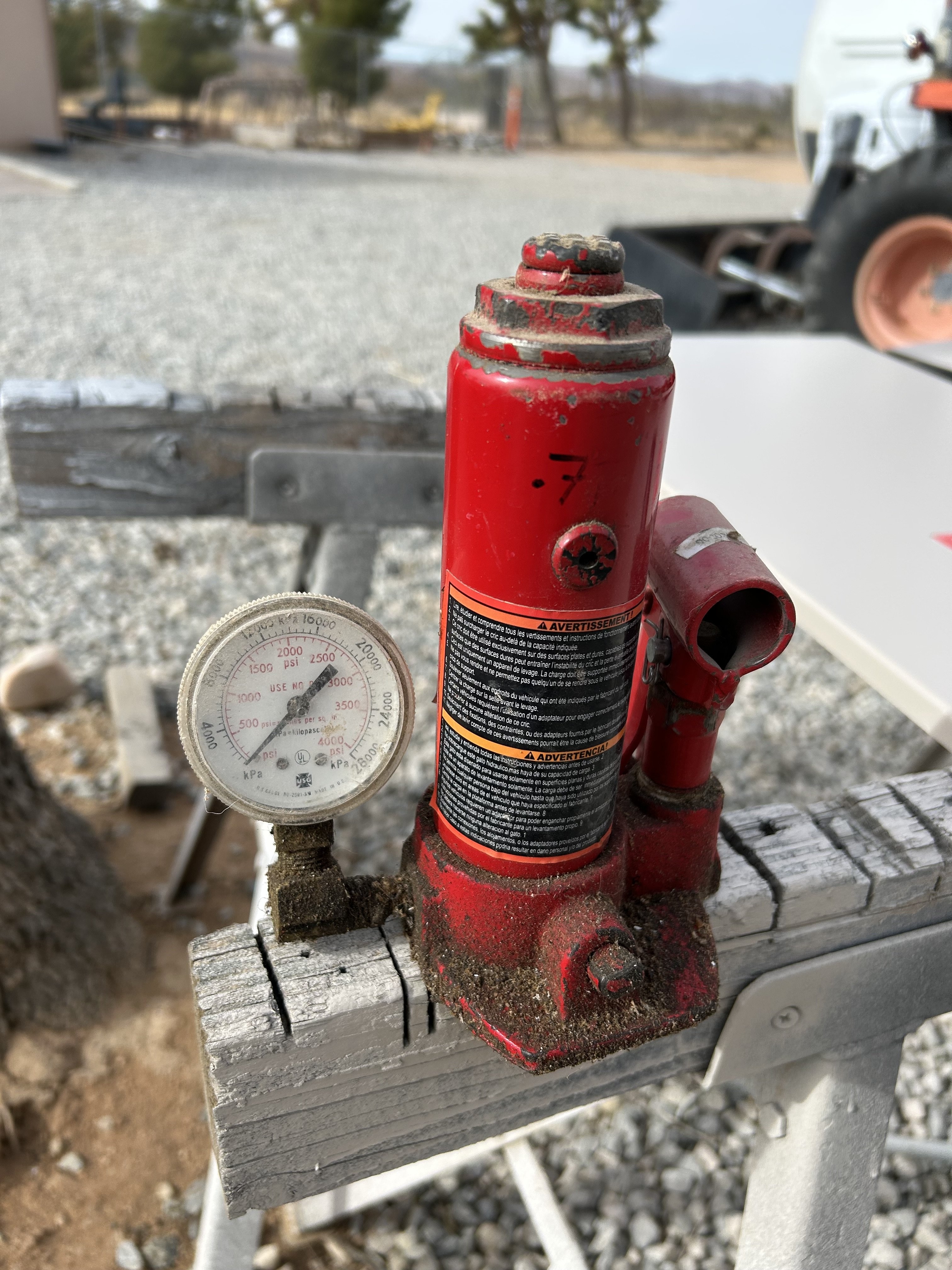

I never thought of modifying a bottle jack with a gauge... Interesting!
I split the difference between a bathroom scale and the integrated scale / hitch by using a small hydraulic scale made by Sherline.
I was going to do something similar with the loader on one of my tractors but quickly realized I could approximate the weight by how the loader was responding.

I built my jack scale about 15 years ago. Bought a hydraulic jack at a garage sale for $2 and repurposed the gauge I used to adjust my hydraulic pressure on my loader. Probably spent less than $20.

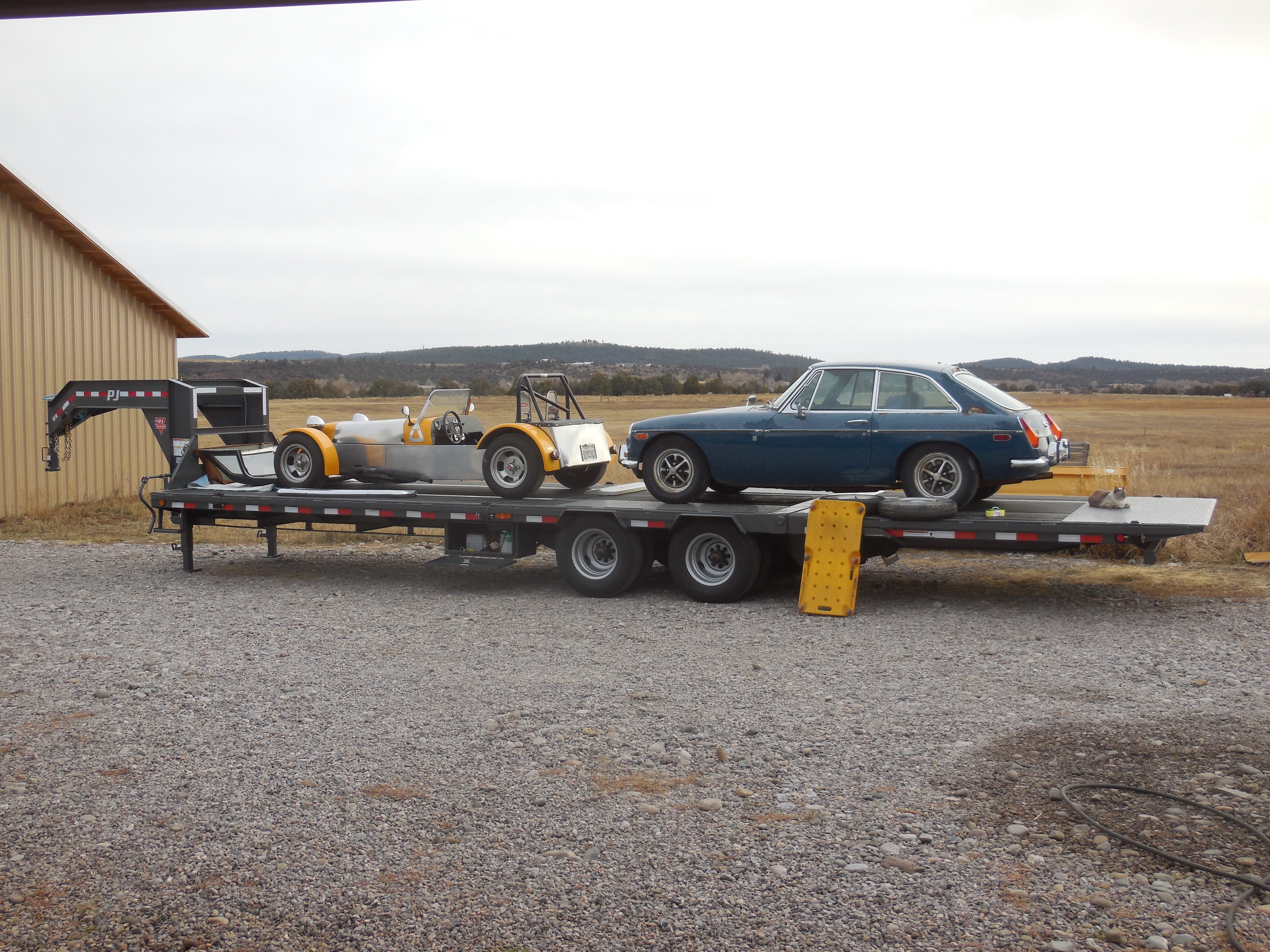

That being said, we have 5 to 10% towball load in Europe with our mid axle trailers. In North America the axles are not 2 to 4 inches behind the center of the trailer, but 2 to 3 foot, giving 10 to 20% drawbar load, giving far greater safety margins for keeping your center of gravity in front of the center of the tandem.
If your hitch load is that critical in vehicle stability, i suggest some inflatable airbags to stiffen up the rear suspension. We used to order a Firestone AiRide kit for gray import half ton GMC Sierra and Toyota Tundra. It makes a day and night difference in handling.

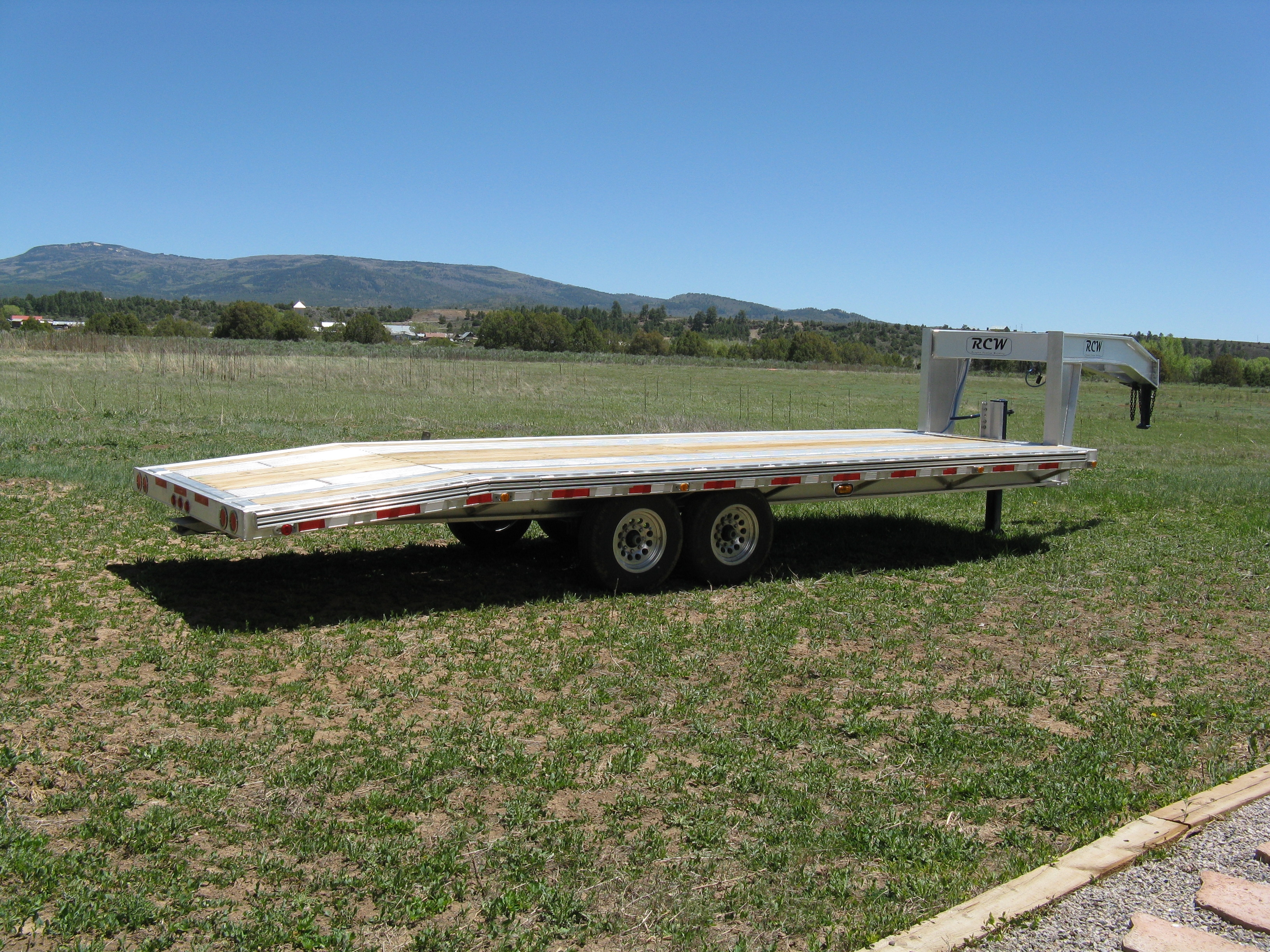

That "forced" tongue weight can be good or bad, I think.
I prefer having the trailer axles farther forward than on a typical flatbed, giving me the option to place the load in the correct spot instead of ending up with excessive weight on the tow vehicle.
That's one reason I really liked this trailer. That and it's very low weight, of course.
I've had a trailer built with the axles 18 inches forward, which was quite helpful, but after starting to buy hydraulic dovetails the problem solved itself - the axles have to be farther forward on those.
