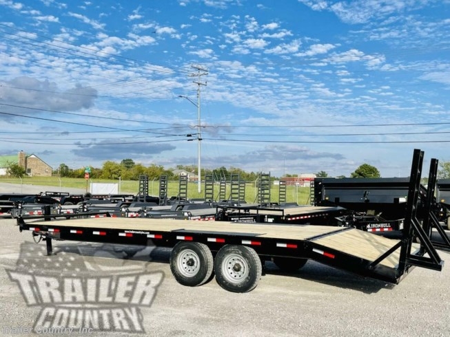

Most commonly available trailers in the states have the axles set way back,
Something like this, the axles are a couple of feet to far back. It puts too much tongue weight on the towing
vehicle.

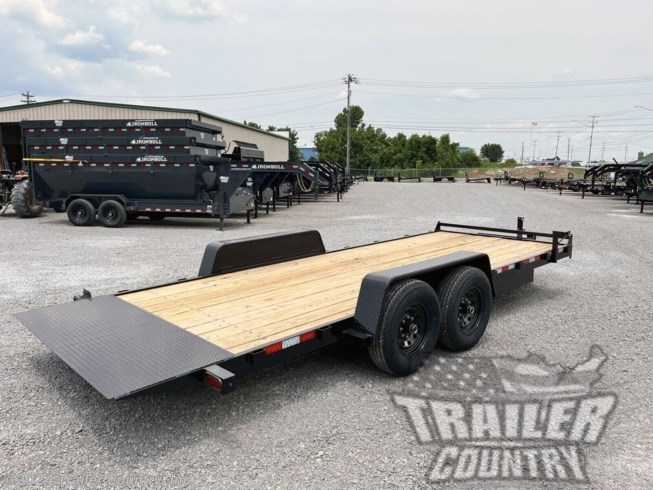

This one with the full power tilt bed is much better.

Amen to that. My stock Big Tex TV70 trailer axles are way back, like at the 60%/40% position. It is a problem, which doesn't allow me to just load evenly with logs or loose material, without seeing excessive hitch weight.

If our surge brake systems handled heavier tongue weights well, and i had a Sprinter as tow vehicle, i would love to set the axles that far back... I would prefer assister springs over WDH... with my tractor trailers too, i like to load the towbar heavy. More weight on driven axles is more traction and more stability.

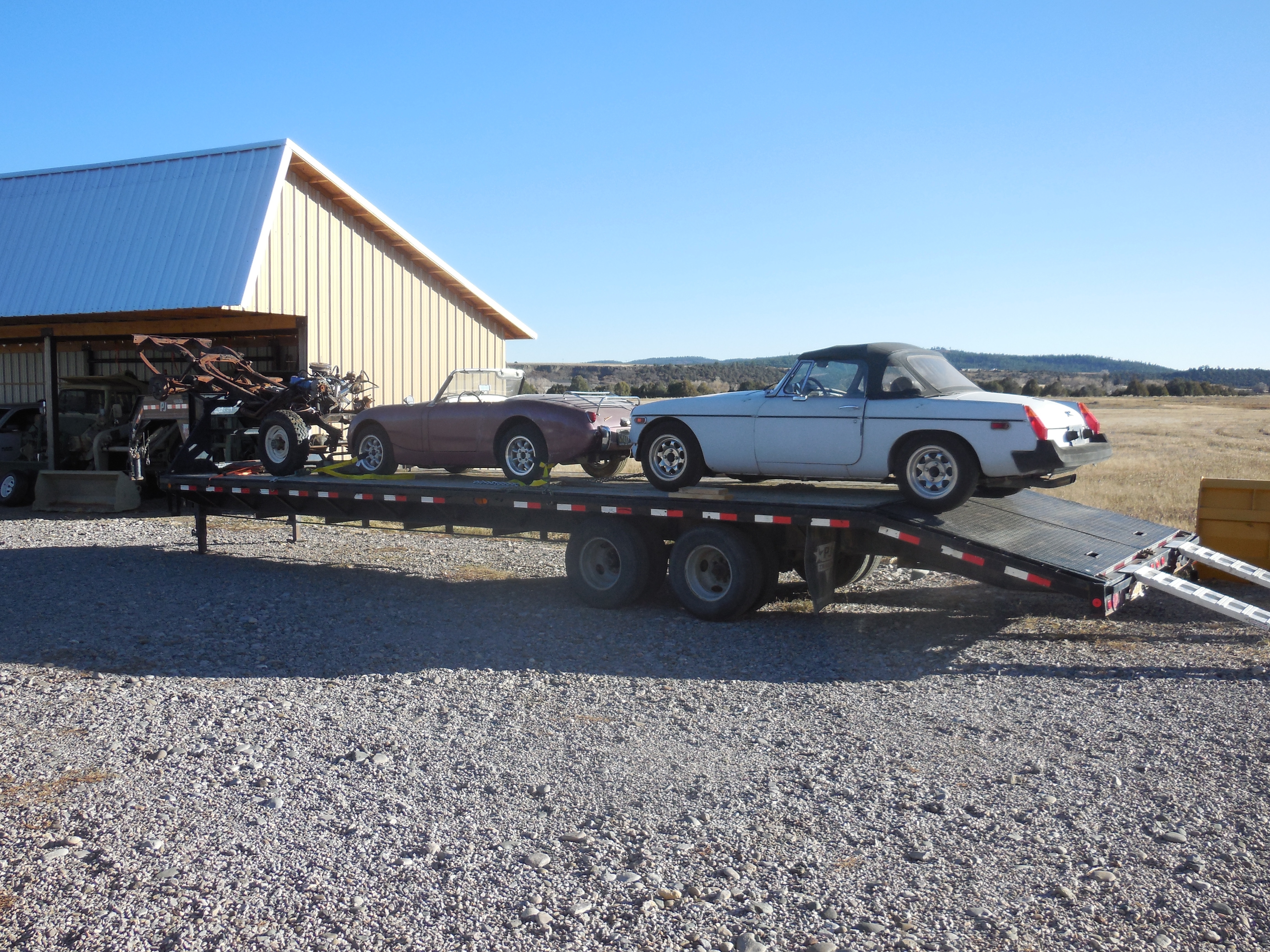

Here's a Bugeye and my beloved Beater B going back to CA, together with a Jeep Commando chassis, on a cheap trailer with the axles too far back. Basically gave a friend (living in CA) the trailer for hauling the cars for me.

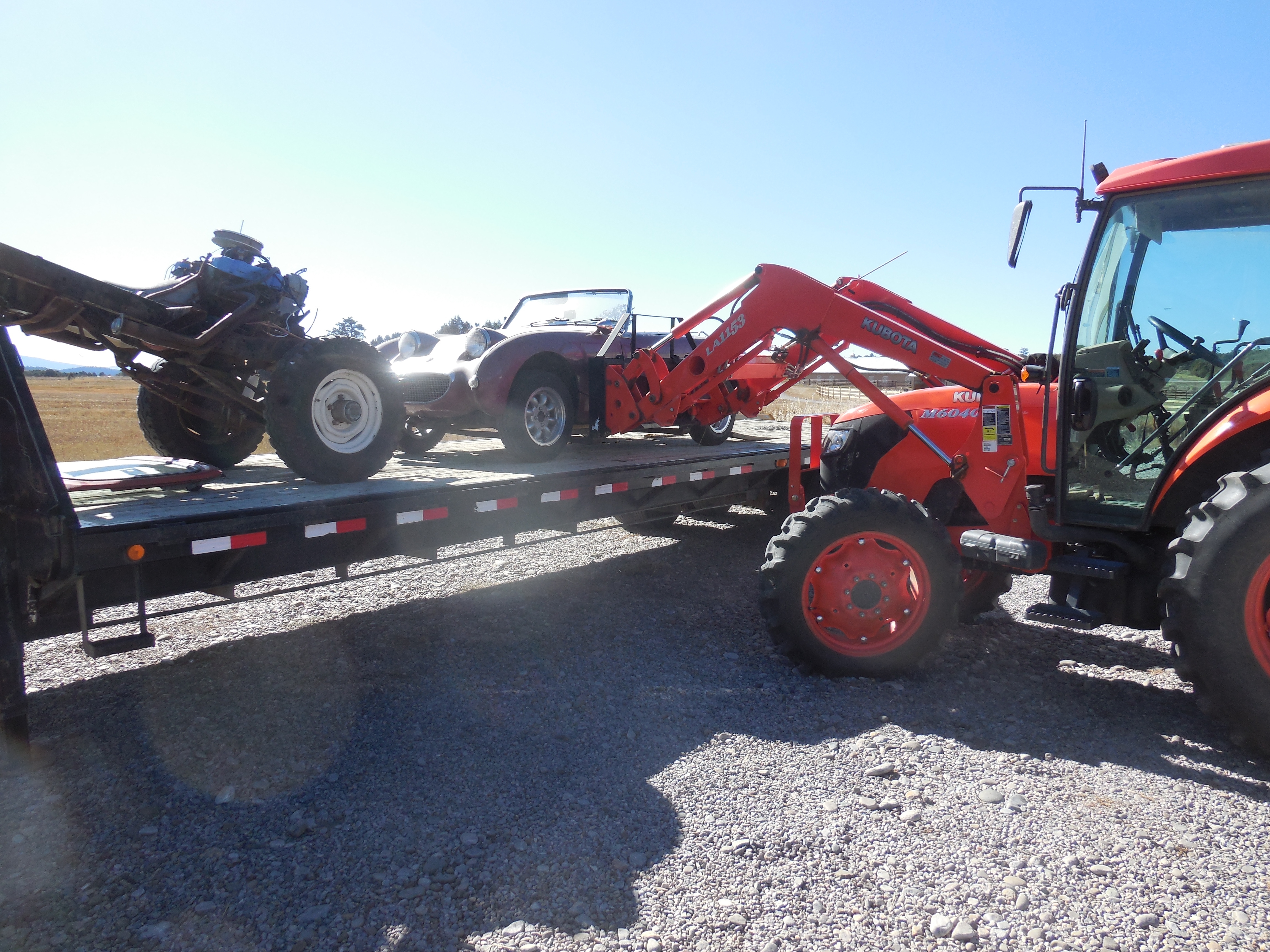

Oh, and to keep it tractor related, this is the quick way to load a car on a trailer.
