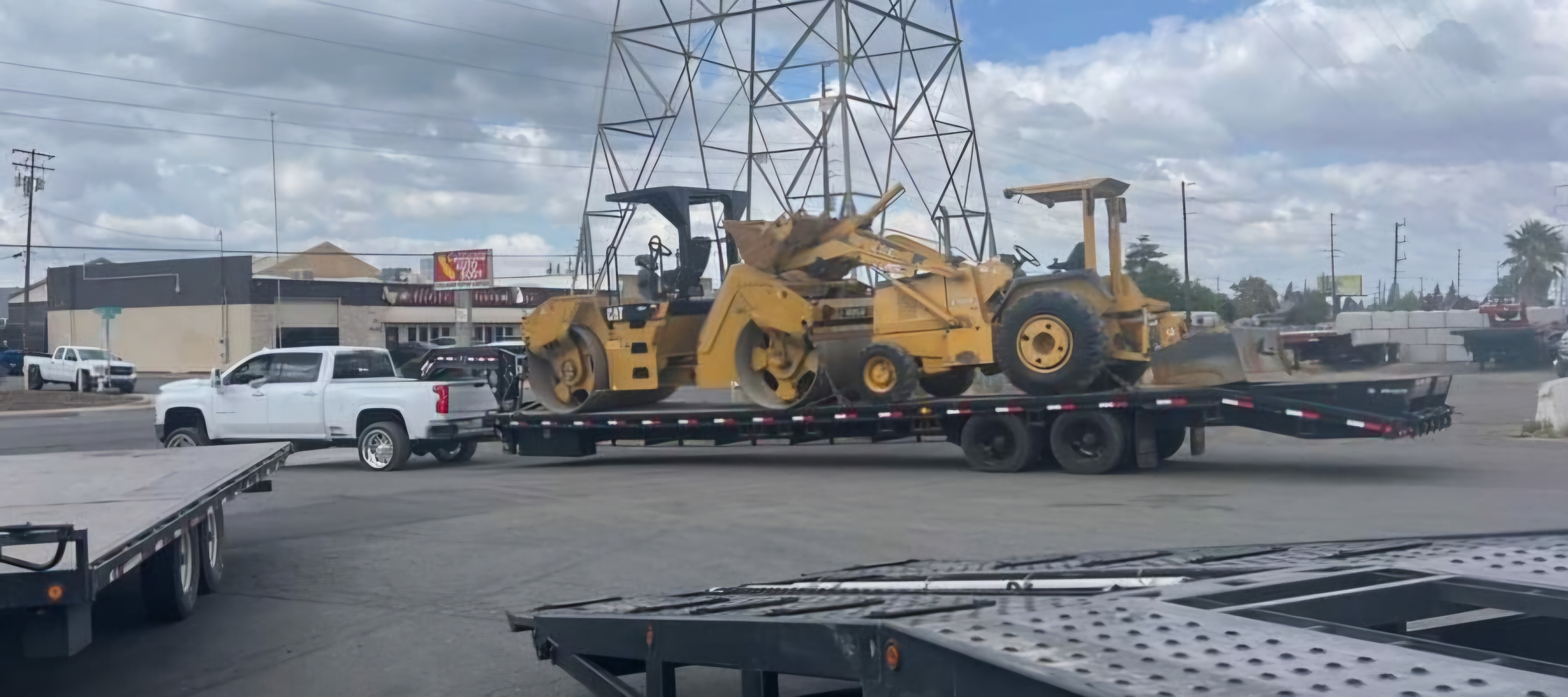

Looks like it was photo-shopped, but I'll comment anyway. Not that that pickup should be towing so much, but he could have given the rear axle a break and loaded farther to the rear. Even the front trailer tires look to be too heavily loaded.

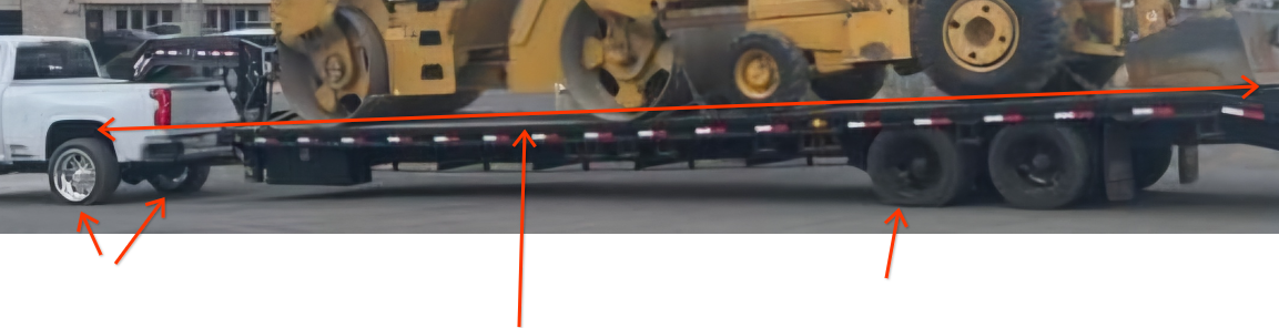

it's a pretty good 'shop if it is
the truck's tires look nicely crushed
the front tire of the trailer is distorted realistically
the suspension of the trailer is crushed and the tires are in full contact with the deck
the deck is showing significant bowing
Overall I believe the trailer & equipment portion of the trailer is legit
whether or not that's the actual, I can't say - the wheels tell me it's probably a "half ton" truck, but the GN hitch says 3/4-1 ton truck, but no guarantees in either case.
You'd have to be a complete idiot to even stage the pic, I wouldn't want to stress my truck or trailer just to take a pic and then unload it, so it must be legit lol
