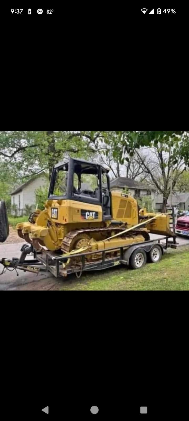

Post 20440, a photo of the underside of the trailer would be nice. I am sure there won't be a straight component .

I know that trailer well, I have the closed-side version of it, 70TV from Big Tex. It's a 7000 lb. trailer, with a curb weight (open side) probably around 1600 lb.... so 5400 lb. max payload.
Anyone care to hazard a guess at the weight of that dozer?
I almost assume this must be photoshopped.

I agree, as I think the trailer would be flat on the ground!

Based on the shape and characteristics it's likely a Cat D1-D3. Operating weight 18k to 21K.
It does look like it might be photoshopped.
