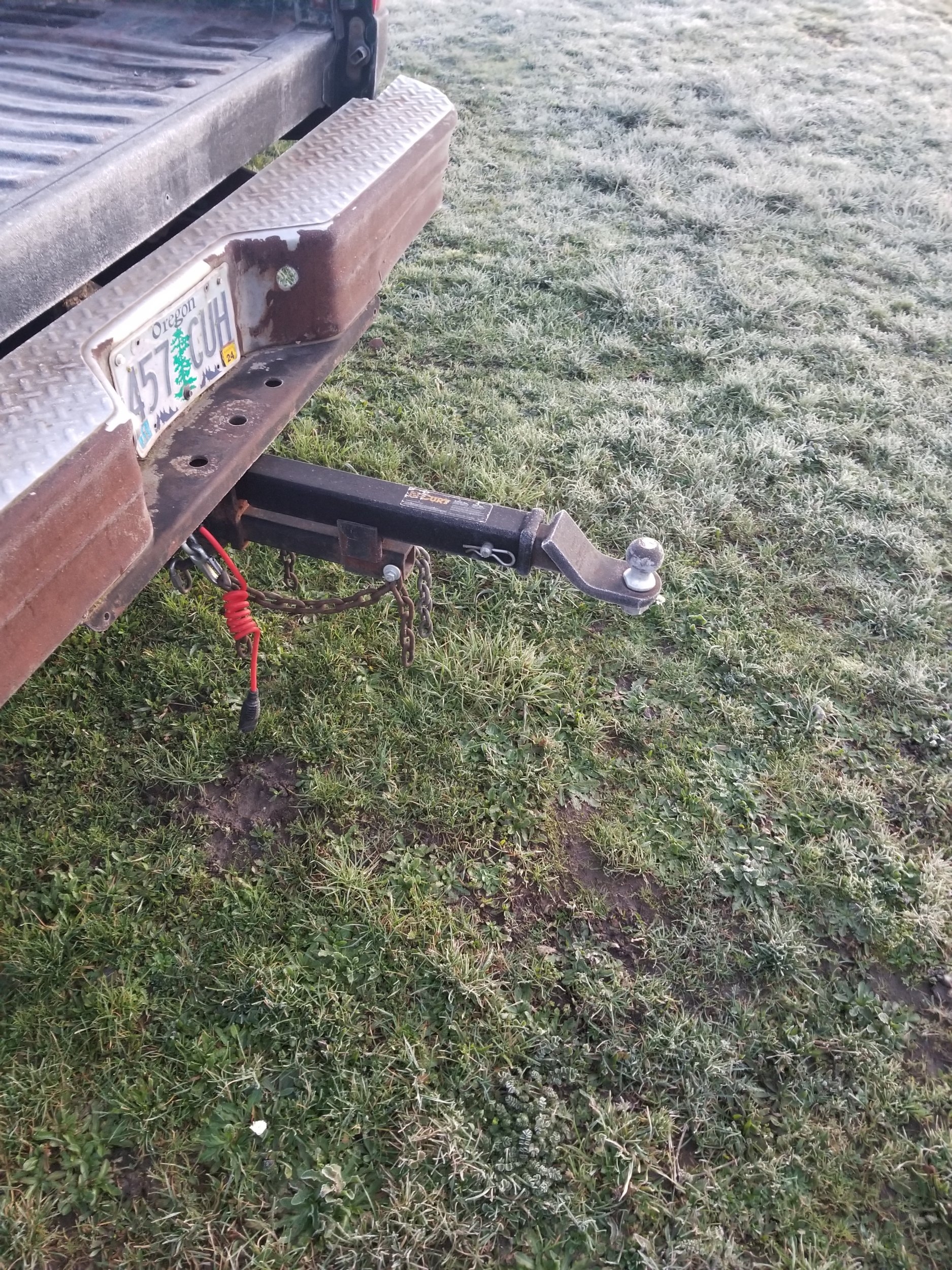

In a previous lifetime we had a bigfoot camper on our '97 F350. Sounds fine right? Well it's a SRW 4x4 CC with a 9900 GVWR so you can imagine the payload capacity, and in retrospect I believe we were probably very close to overloaded just with that camper, even though if I recall it was only the 9.6 version and not the 10.6 so it only stuck out a bit in the back.
Wife also wanted to be able to tow our (her lol) 2.5 horses with that (a morgan, a poa and a shetland; maybe that's only about 2 horses total idk).
So we had a 3' extender.
All the above encouraged by the RV and trailer hitch people...
My recollection is that we only made at most one trip like that - possibly never towing.
Glad I know better now, and very glad nothing bad happened (I still have the truck and it's still great).
Personally I can't stand driving a truck with a camper on it and we got rid of it after not using it nearly enough. My preference is for "car camping" - bring a tent, put the crap in the back of the truck, cooking stove on a picnic table.

Have seen a lot of extensions, none that long.
Talked to a few users, ā€œDo you not understand the concept of a lever? How much bending moment you are applying to the receiver?ā€ Answer, ā€œAm not putting more weight on it than it’s rating.ā€ In other words, they don’t understand.
It's more for things like dinghies and wave runners, not real boats and trailers. Like BigJohn said, 300# max tongue weight.
I have a few small sailboats, and I can easily lift the tongue on each of their trailers, meaning they're probably all 150# or less tongue weight. The boats themselves weigh 350 - 550 lb.

At the end of a 36" arm? The twisting moment at the receiver is significantly greater than if that 300# was on the end of the normal 8" drawbar.
This is what I was alluding to when users claimed they were staying under the receiver's load limit, not understanding the principle of the lever the extender applied.
In defense of the extenders a "weight distributing" (it doesn't) hitch also imparts a strong twisting moment on the hitch receiver.
The hitches are load distributing as weight doesn't move. A spring is used to lift the tail of the tow vehicle.

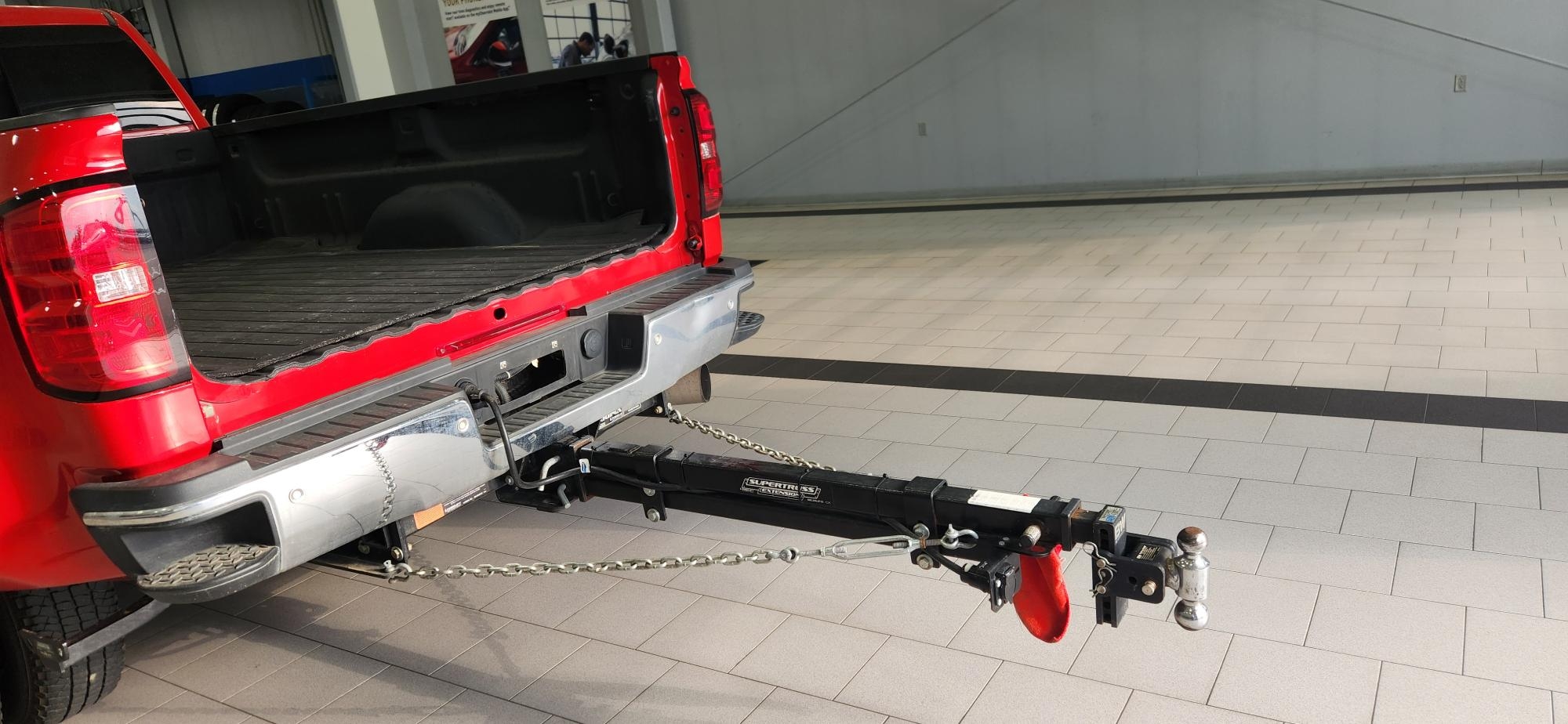

Truck camper life is a compromise... My first camper was a 11.3' which took a 4' hitch extension to tow with which was stupid and floppy, I copied the "superhitch" design and added a second vertical tube and had sideways chains like the above picture which helped but still dumb... My second and third camper (I'm cheap, keep moving up) are in the 9.5-10' range and now I'm down to an 18" extension but still have the second tube under the first as shown below... now it's short enough I don't have chains for lateral support, tows great... I have the camper on my '97 SRW F350 and tow a trailer with Ford Ranger on it, combined weight around 19k, have thousands of miles on the setup, works great other than having no horsepower... FWIW I have the lower tube going forward to a crossmember I made with a vertical pin so the lower tube takes the horizontal load instead of the upper tube... the pictured is like 3" longer than my previous extension, ball is even with the back of the camper bumper so it is bare minimum.
Yes, of course. But what pickup truck capable of carrying a camper has a max hitch weight that low?
Round numbers, let’s say the receiver is 3 feet from rear axle, and a ā€œnormalā€ drop hitch extends that 1 foot, so 4 ft from axle to ball. Max tongue weight for a 2500 series pickup is 1500 - 2000 lb, depending on configuration (I used 2023 Ram 2500 chart).
If extending the ball another 3 feet, to 7 feet total, the equivalent moment would drop that rating down to 860 - 1100 lb., still way beyond the 300 lb rating of the bar itself.
This all ignores the weight of the camper itself, which must be taken into account as well. But the hitch itself is going to be fine with a small sailboat or waverunner trailer, having tongue weights 100 - 150 lb.
