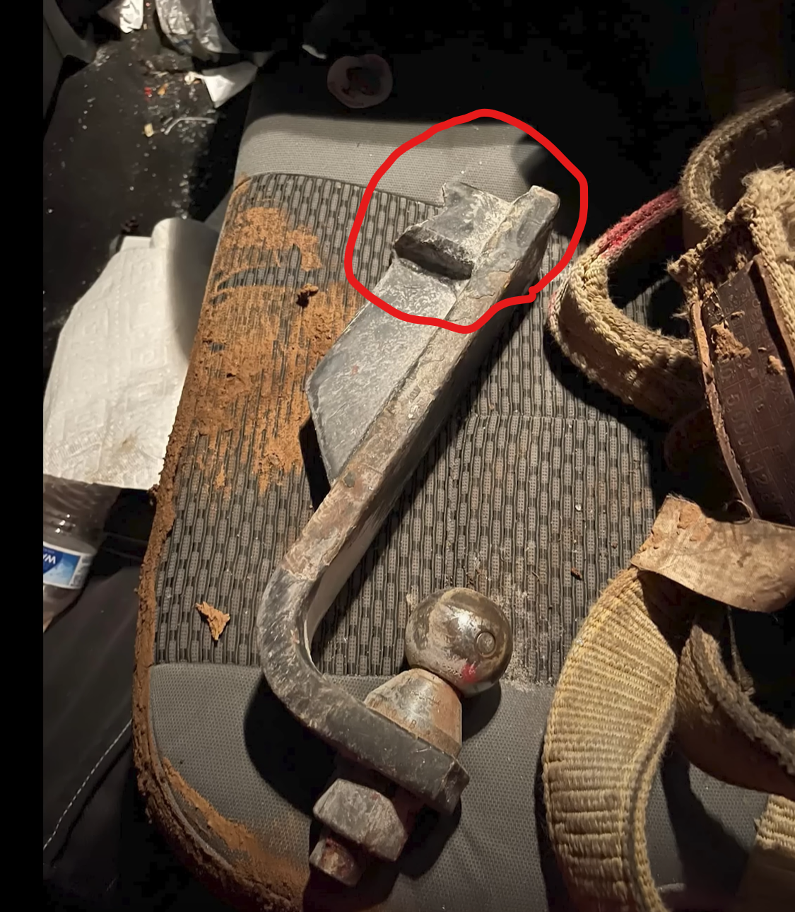

Since we are talking hitches.... I have posted this youtube video before, but it warrants posting again. Please don't use any cheap or underrated component in your hitch setup. This situation was fatal for the driver in the vehicle intended to be recovered.
I suppose hitches arent fatigue tested before approval in the USA like they are in Europe... This design simply wouldnt have made it, unless the single gusset was changed to two that were welded to the sides of the receiver tube on the neutral bend line. This gusset was a hell of a crack initiation point.
