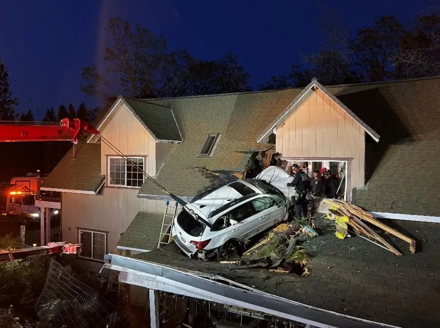

It doesn't involve a trailer, but it's not everyday you see a vehicle crash into the 2nd story of a house ....

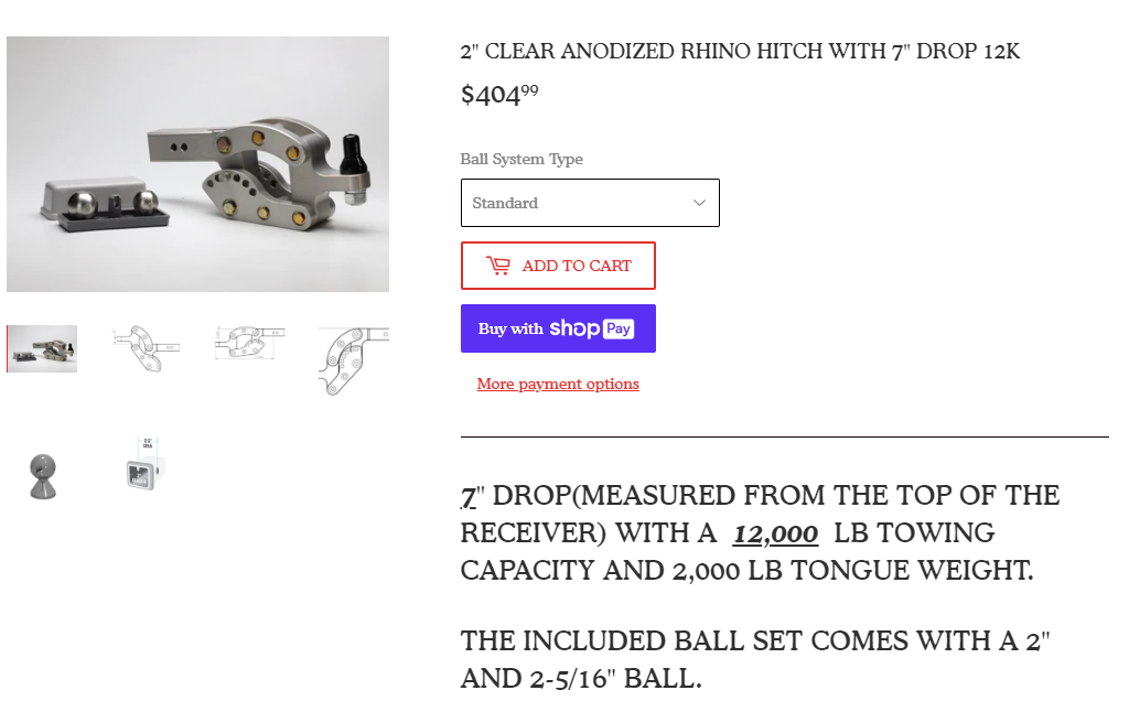

I picked up a Rhino Hitch. Link
I like that it does not have the Drop bar protruding below the hitch. It is about 6-8 inches longer than other hitches, but this is actually kinda nice when I am trying to launch the boat at a shallow ramp.
Have only had it a few months so I cannot comment on it with too much experience, but so for I am liking it. Swapping the balls out is very simple and easy.
Not too surprising that someone could launch into the second story of a house below the adjacent road. They must have had ridiculous speed!

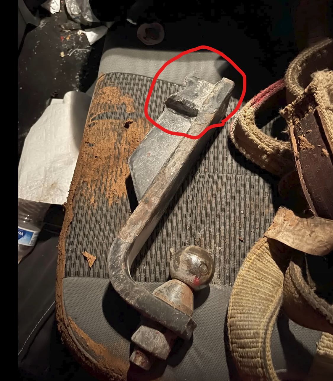

Since we are talking hitches.... I have posted this youtube video before, but it warrants posting again. Please don't use any cheap or underrated component in your hitch setup. This situation was fatal for the driver in the vehicle intended to be recovered.
