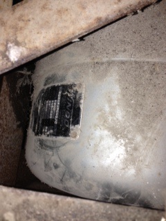

Note: The tag says:
5300 Watts
115/230
23 Amps
3600 RPM
1 Phase

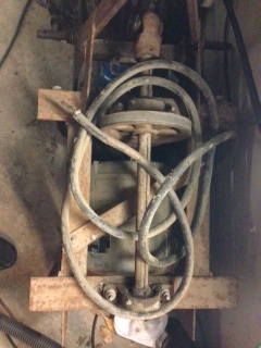

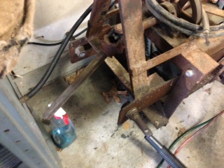

You'll also note that it's a 3 point hitch setup, which I assumed was for a real 540 PTO.
/ Shaft Conversion for PTO Generator #8

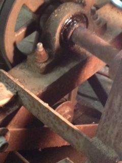

What I see is you only have 1/2 of the pto shaft. Eather it's old or someone made it from a engine mount generator. Get the other 1/2 of the pto shaft and see if the generator works.
/ Shaft Conversion for PTO Generator #9
From the last picture it also appears that the 3600 rpm is generated by the drive pulley being bigger than the driven one. W/o out knowing the exact size of both pulleys, can not really say what the pto input rpm sb but looks like the unit was designed to run off the 540 rpm. Because of the 3 point mounting frame .
/ Shaft Conversion for PTO Generator #10
/ Shaft Conversion for PTO Generator #11
This thread is a good example of what happens when an inadequate description is given. We all have something a little different in our mind and comments and suggestions wonder all over the place. :) I'm sure most of us had in mind a more modern setup with a gearbox transmission and wasn't sure about the sq shaft.
Have to agree with LeeJohn about half the pto shaft is missing. As for speed change, the belt drive has to increase the input speed by 6.666 to give an output speed of 3600 rpm when input speed is 540.

I found the shaft at TSC and got the PTO generator running. It generates but at very low output. You'll note in the picture below that the pulley ratio (top n bottom) look like their set up for a 540rpm correct?
I plugged a droplight in and got a variable brightness out of it depending on the rpm's on the tractor. The voltmeter never got above 100 even though it looks like the sweet spot is around 250. And I could only get it to 100 by running the tractor at 2750 rpms.
Question, I thought I had it grounded well enough, but would a poor ground affect the lower output? Or, perhaps the beast is just too old to generate much.
/ Shaft Conversion for PTO Generator #16
Measure the two pulley diameters. The difference doesn't look like enough to me. Maybe it was set up for a faster PTO.

The pulleys measure as follows:
Large = 7" (roughly 175mm)
Small = 2.5" (roughly 60mm)
That's the issue right? If the PTO generator calls for 3600rpm's and the tractor is a rear 540, I need a larger ratio between the two pulleys. It seems to make sense why the volts are only reading 100 or so.
