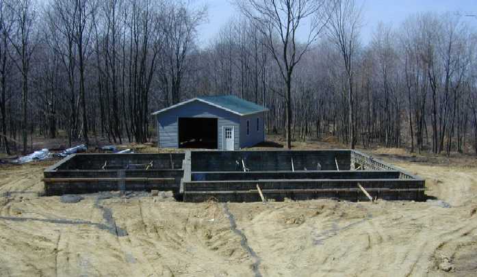

As suggested, the basement is located on a high point of the land above the water table with actually about 40" of poured wall above that in order to keep things high & dry. We will use fill dirt (like RobS) to build up to the garage floor level. There is a 4" perforated drainpipe outside the footer & 3" drains on the inside of the footers (under the floor) -both leading out away from the house. We put plastic sheeting down for the basement floor to be poured on to help keep water OUT (along with Radon). We have heard Pros & Cons about this practice. As said earlier, we are going to use some of the basement as finished living space, so keeping things dry is important.
<font color=red>Here's a picture of the basement.
<font color=black>The builder says that many pour the floor right away with poured walls but not ever with block & that backfill should never be done until the framing is in place to hold the walls.

OK I get the outside water drainage bit, but how do you get your sewer and grey water out of the basement?
I assume it drains to a sump and is then pumped out.
Going back to en earlier post, this basement arrangement is to get your footings below the frost line - Correct??
