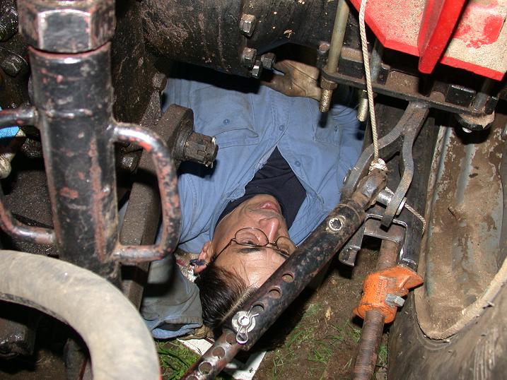

The backhoe subframe worked great. It sure beats worrying if I'm gonna tear off the rear casting or not. I tend to beat the heck out of the equipment so it was well worth the effort. This picture is a close up of the right side where I tried to show all the connections. You can clearly see Pat's system here and the lower lift arms and stabilizers that clear the subframe. It took me only 10 minutes to get her mounted. I made a little stand to hold up the backhoe so mounting it was a lot easier than I anticipated.

Update on my 7 point mount. I take the backhoe on and off a lot to use my other implements.
I re-mounted the hoe this weekend to dig some trenches for a water line running to my camp. I dug the first 50' in a little over an hour, only going 12"-18" deep. It goes from the well to the East fence line and is an area where we rarely drive anything on (except the ATV occasionally). Well, the rest of the water line follows the fence down to South Camp....about 1600 feet. So I decided to just lay the pipe on top of the ground since it is temporary anyway. The sideways slope in some areas was just too much for my pucker factor. I crawled up to the fence line in one place, and nearly tipped the tractor over...PHWEW...man, that was scarier than heck. I lowered the bucket quickly to stabalize and backed out of there. Other areas along the fence line are steeper than this was so there's no way I'm doing it. There were many dips, humps and rocks hidden by the tall grass. I'd rather eat $h!t and die as far as I'm concerned, but I aint doing it.
Anyway, back to my subframe...
I told you I fashioned a sort of "stool" for the backhoe to sit on when off the tractor for easier mounting. And also that the subframe sides are about 3" inside each rear tire. I found this was a very easy way to estimate lining up the backhoe when backing up to it. The subframe legs slid right into tractor mounts every time I've done this and then I lift up the 3pt arms and hook the lift pins on the backhoe. Then I hook up the pump to the PTO and use the backhoe legs and bucket to align the other 5 connections. Slide all the hitch pins in and I'm good to go.
I was pleasantly surprised, again, that this whole process took less than 5 minutes total. Initially this was my worst fear that it would take FOREVER to hook up and un-hook but it's very easy now.
