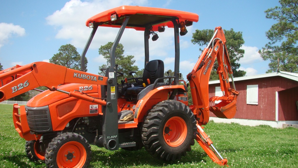

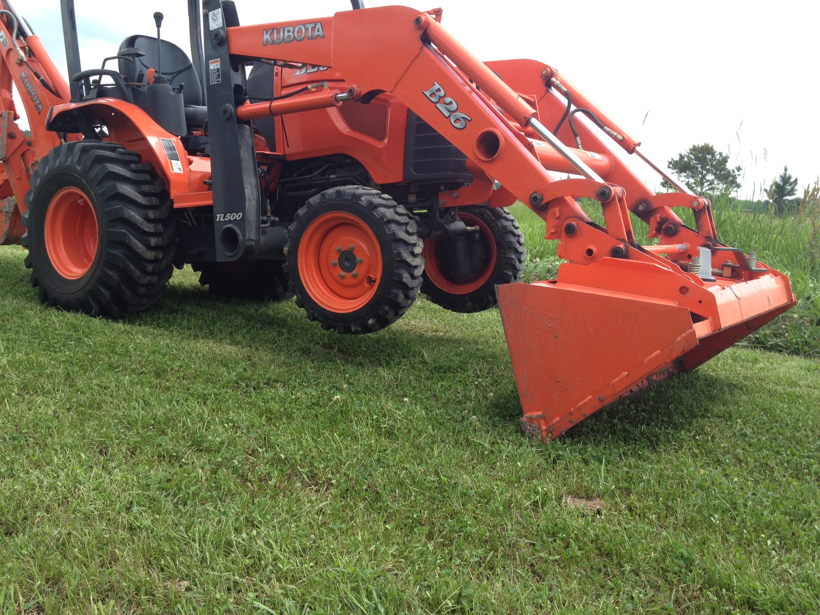

Regarding how to set the bucket. I have seen operation do several ways from setting flat to extending the curl full so the bucket sets upside down as pictured in Kubota website for the B26. I think the object is to get the tractor level front to back and side to side so when you dig, you can dig a level bottom ditch with plumb sides. If the ground is not sloping much, placing the bucket flat will allow up to 5 or more inches, depending on your tractors design. If you need more lift then you have to invert the bucket to get more

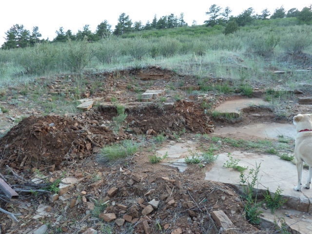

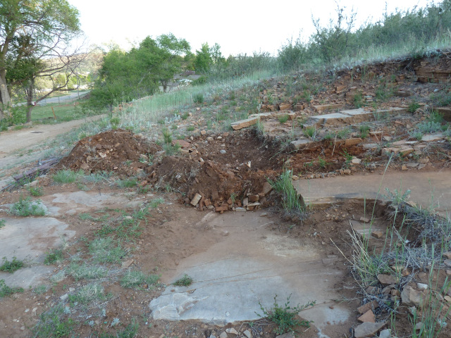

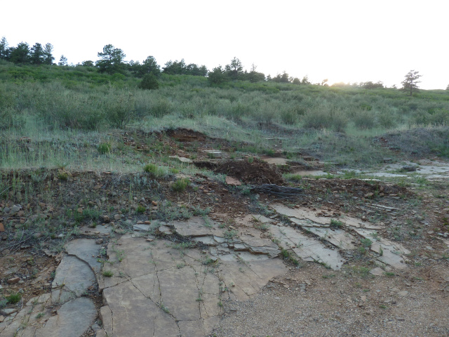

I've attached pics to show some of the ground I am on; solid sandstone layers that have a slight curve to them.. a mini-quarry (aka our backyard :) ), with differing slopes between where the back wheels sit, and where the FEL sits (and no "give" to the ground). I'm taking the top layer of dirt/loose rock off some of this ground. I also want to pry up a some thick sandstone slabs for use around the property (I figure if I can do this with a pick and bar, it should be fine to do with tractor/backhoe, and a lot easier on my body! :laughing: ).
